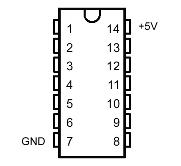

Traces of the 14 pin --->
The 40-pin is an 8048 and the 14 pin reads 6A1 8(New line)HD74LS125AP

Offline Soarer
  • * Moderator
  • Posts: 1918
Re: XT/AT/PS2/Terminal to USB Converter with NKRO
« Reply #508 on: Wed, 26 September 2012, 15:40:26 »
Cool.
74LS125 is a tri-state buffer chip. Black and grey wires both go there, so they're data and clock. We can't tell which is which though, the circuitry is the same for both.
That chip also gives us confirmation that the yellow is +5v, since that fat trace that runs along the edge of the PCB goes to pin 14.
So I guess it's reasonably safe now to try hooking it up...
yellow ... +5V
brown ... ground
black ... clock?
grey ... data?
If that doesn't work, just swap the black and grey :)
