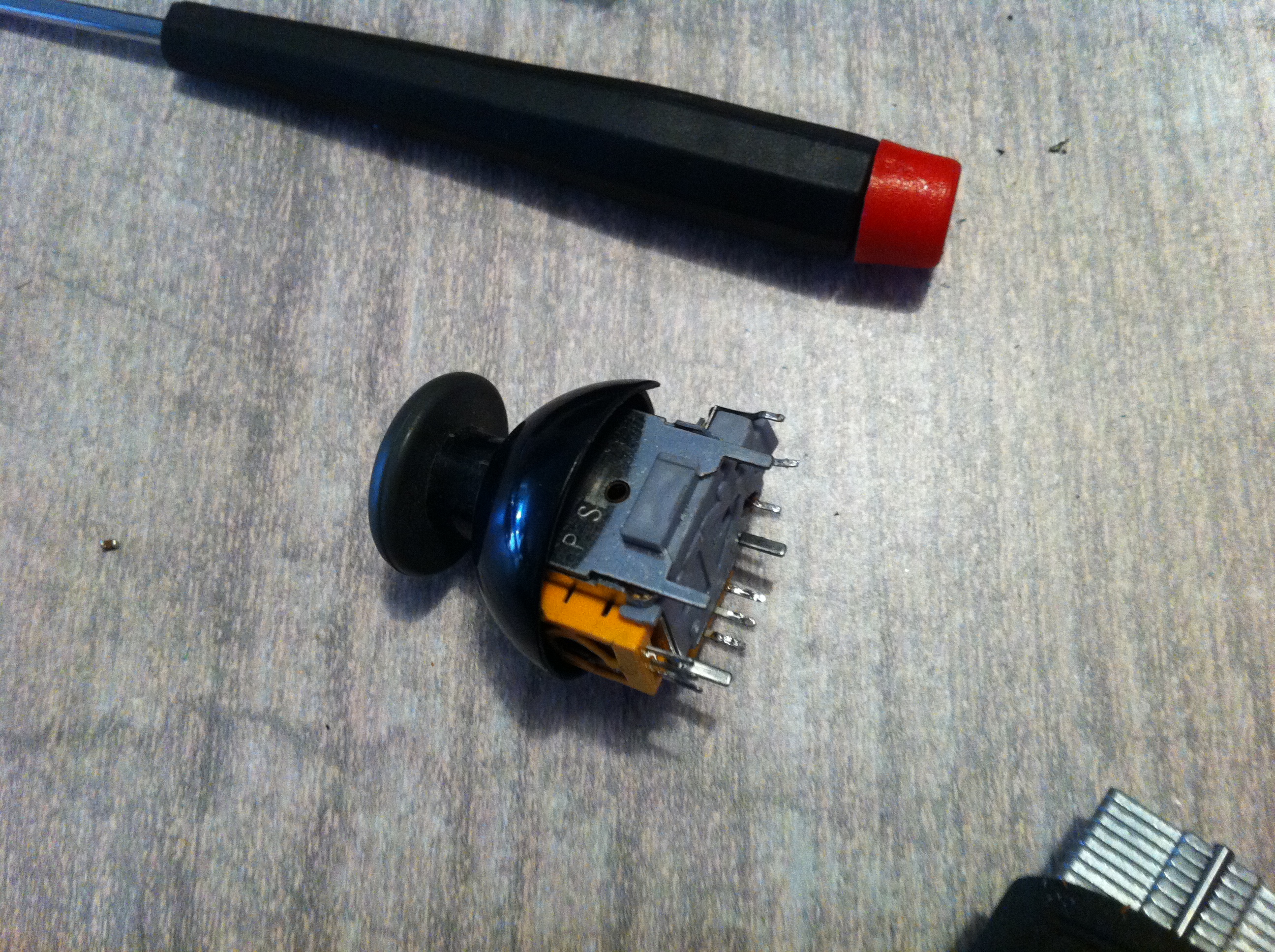

DONE :
-Cherry MX Red ordered (at start I had low profile switch in mind, but after all I've read here, I feel like Cherry Red match my needs)
-Old thumb stick unsoldered (10kohm)
-New thumb stick unsoldered from a joypad. (10kohm)

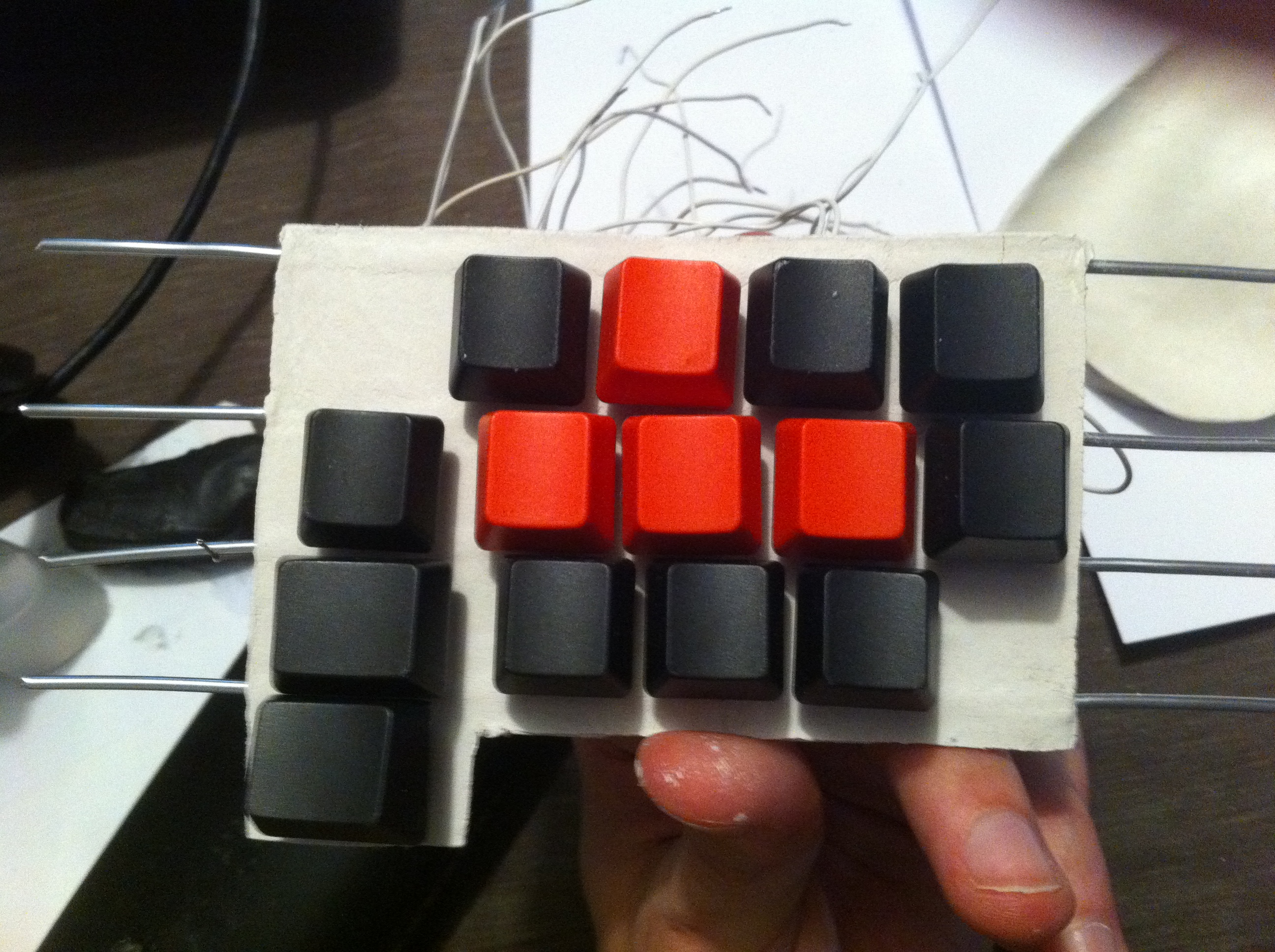

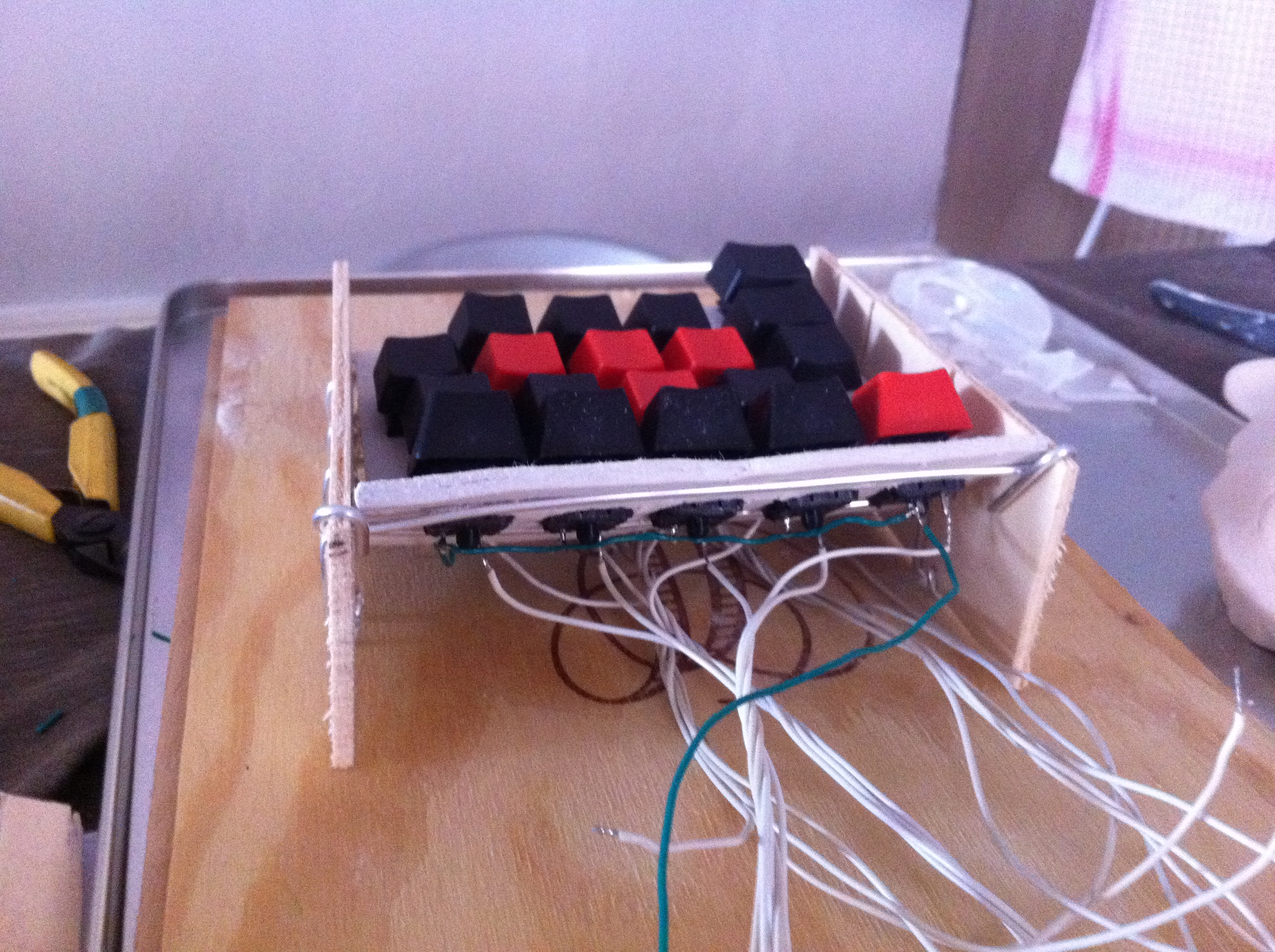

So here it is :
Things to do :
-I'm still waiting for my keycaps (ordered on wasd)
-design an ergonomic structure with a 3D soft (need to figure out which soft)
-send the design to a 3D printing service
-rebuild it all on the final structure.
Side thing to do :
-figure out a way to have the switch and microswitch as a datahand (without much space between each finger), if I end in a working solution I'll design the structure to make it possible.
Actual caracteristics :
-response time 0.5ms (I can still lower it to 0.1)
-you can press 6key + 4modifier key (shift, alt, ctrl, gui) at same time (yea you'll need your 2 hands and your nose or foot to reach the limit) in keypad mode, no limite in joypad mode
-2 mode possibles : keypad (with keybind) or joypad (with button activation), you can switch to each of them instantly with a 2 position switch
-analog thumbstick (like a playstation thumbstick)
-autofire mode possible : working in both keypad and joypad mode, you can activate it instantly with a 2 position switch
-22key (could add more but didnt see the point)
« Last Edit: Tue, 31 July 2012, 16:27:19 by Think »

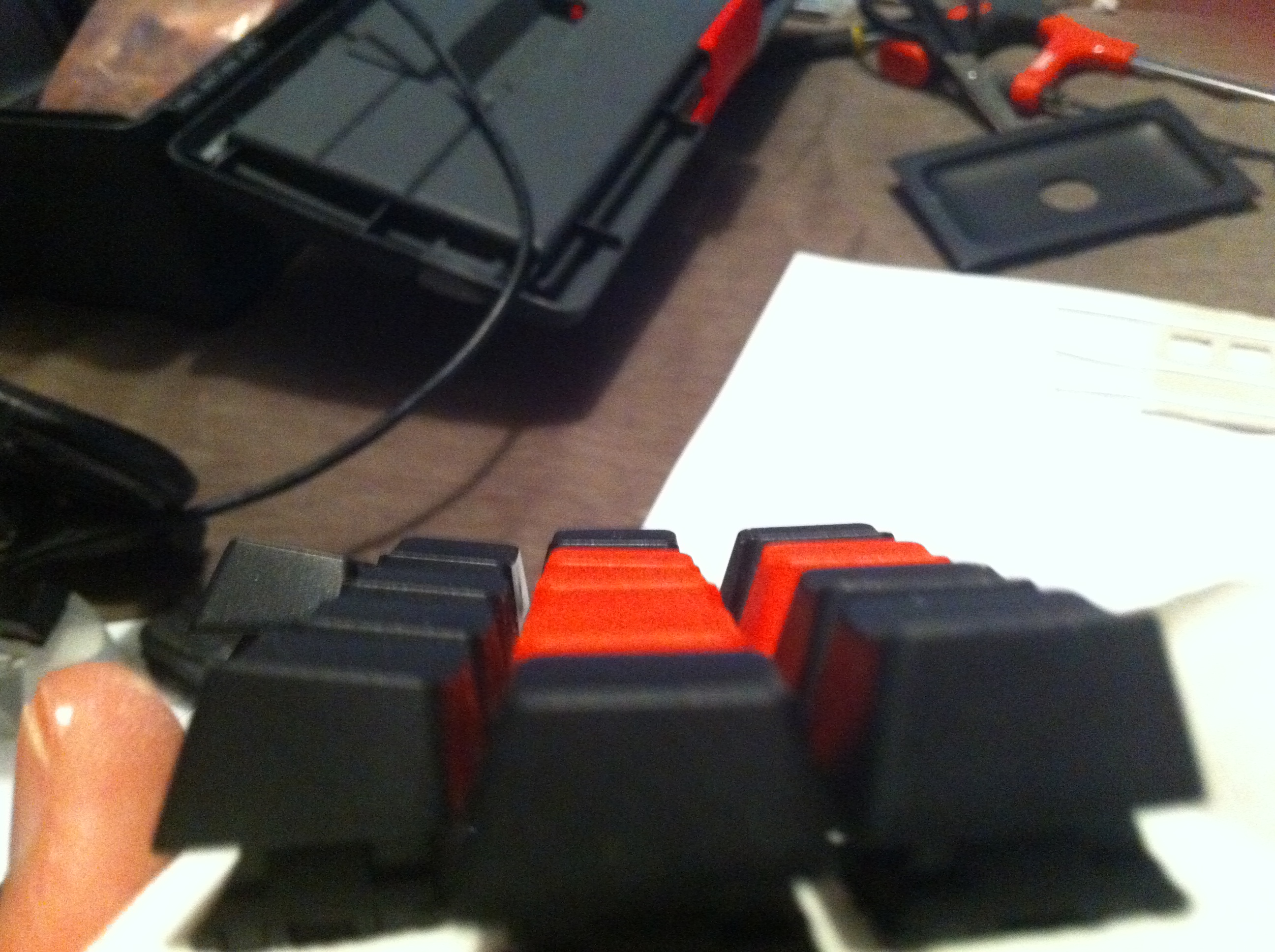

« Reply #6 on: Wed, 16 May 2012, 06:28:59 »

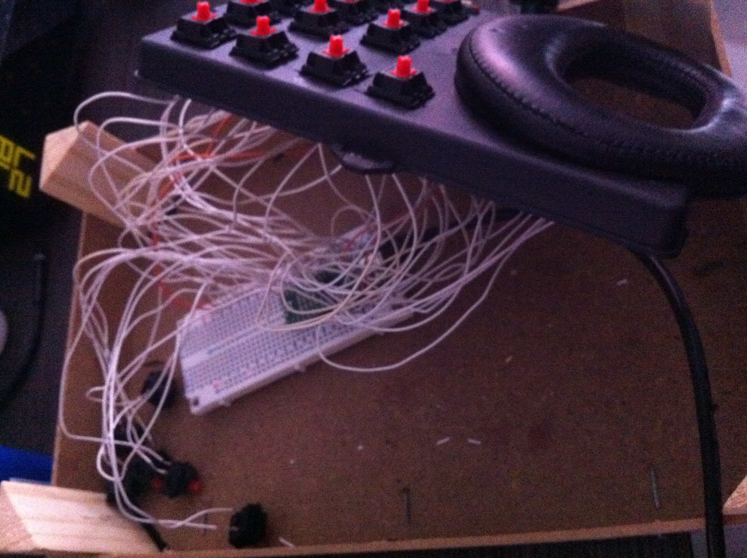

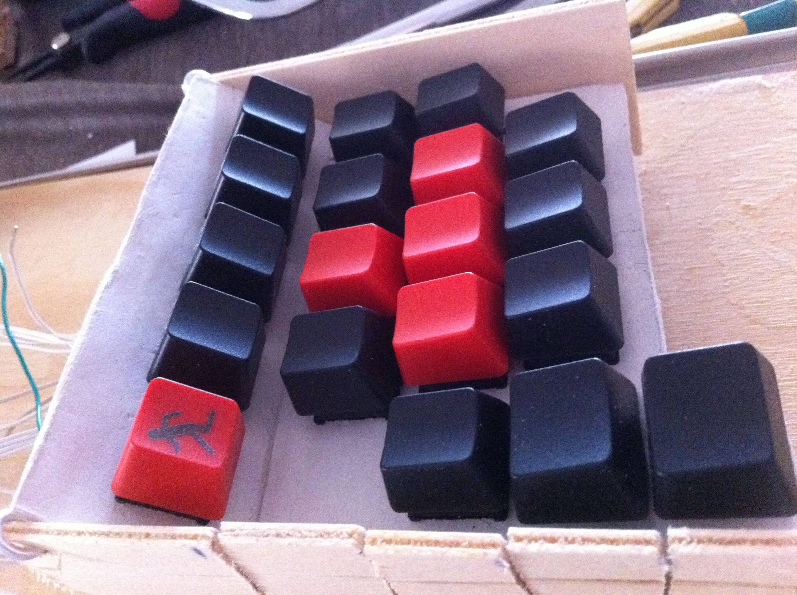

just received my keycap :
« Last Edit: Tue, 31 July 2012, 16:28:12 by Think »

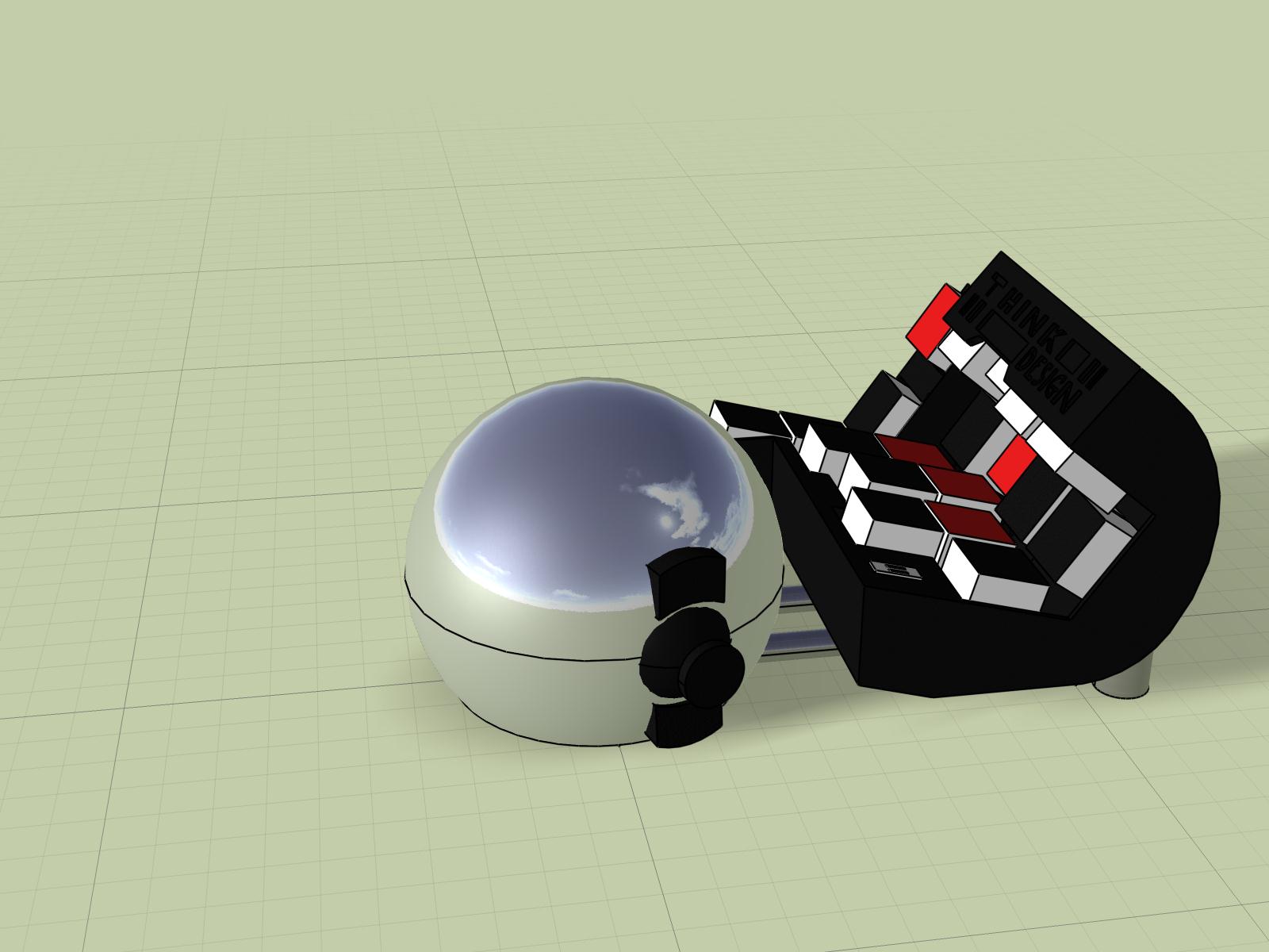

« Reply #7 on: Tue, 12 June 2012, 13:09:45 »
I made two design, just to see how it would be, i might end doing one of thoses :
need a better soft, that one is not accurate enough on small dimension
« Last Edit: Tue, 31 July 2012, 16:29:00 by Think »

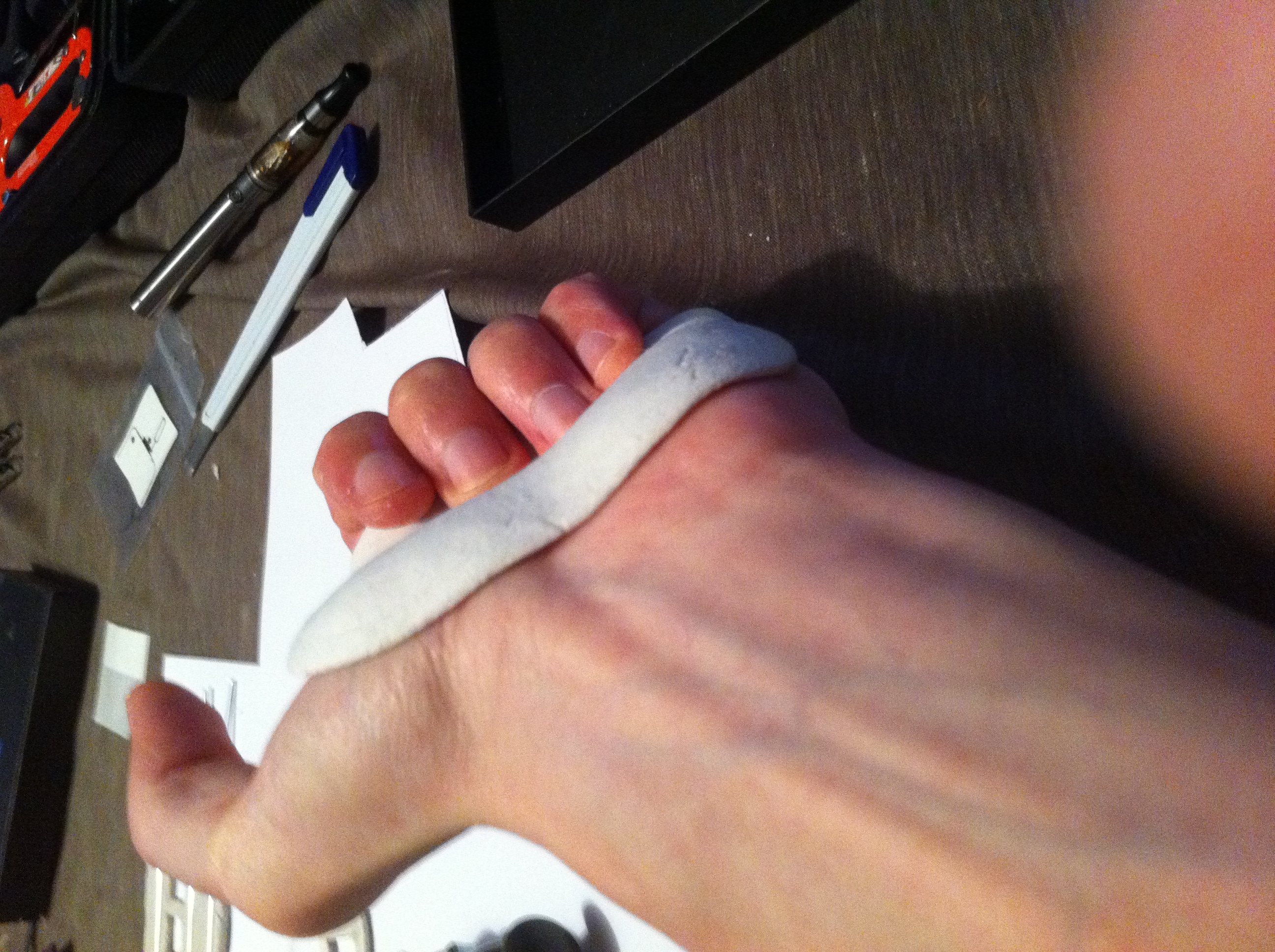

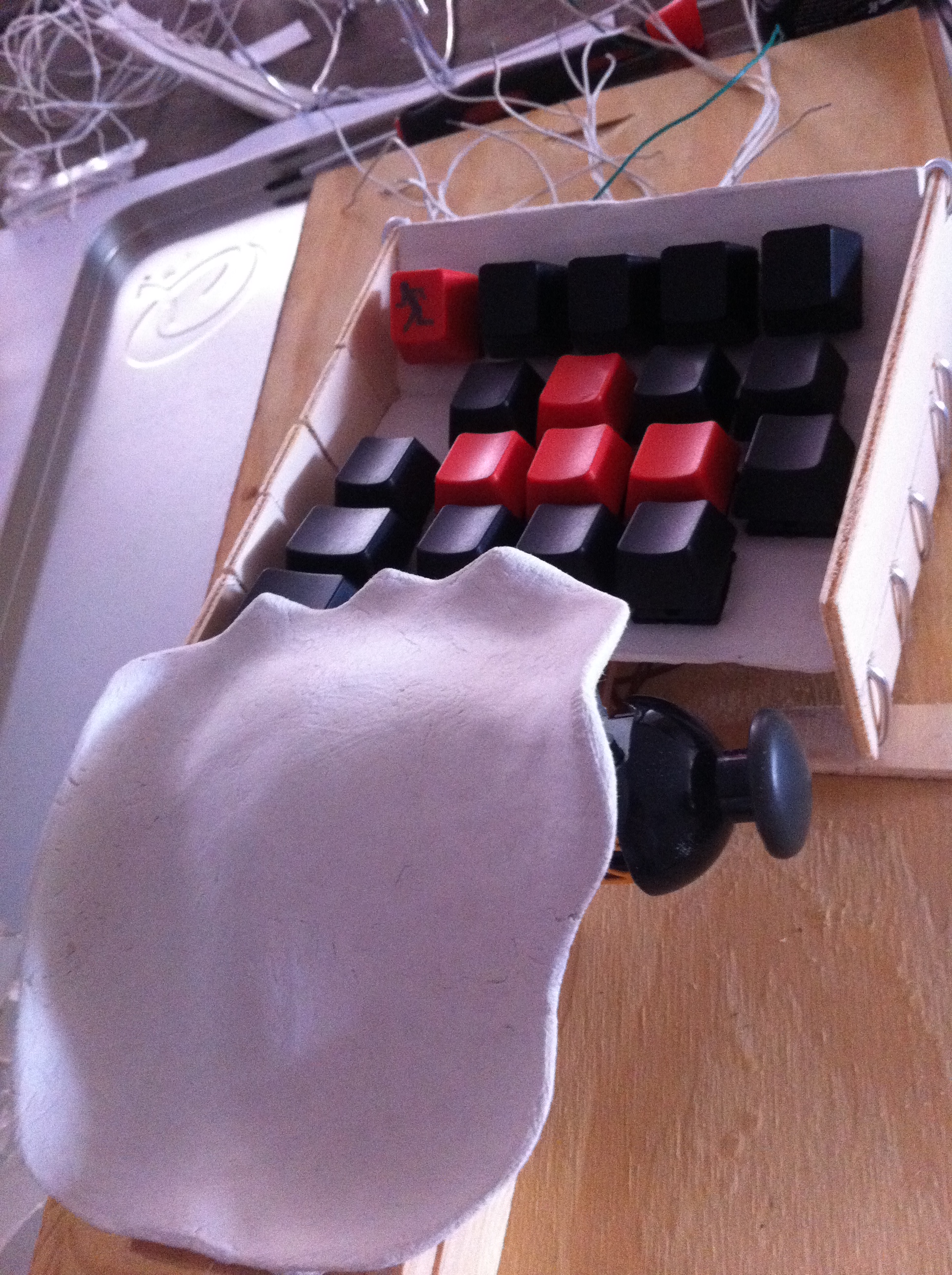

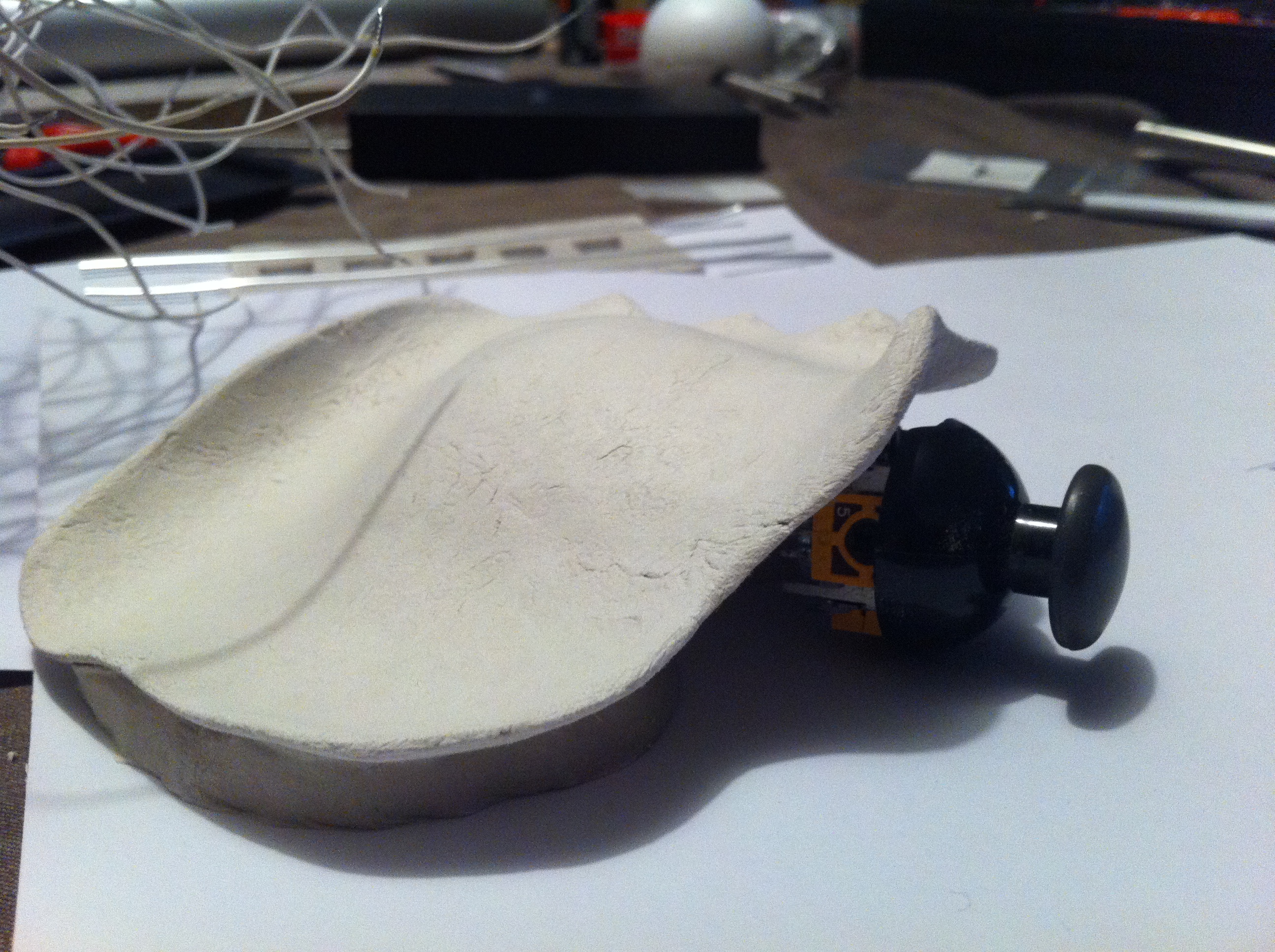

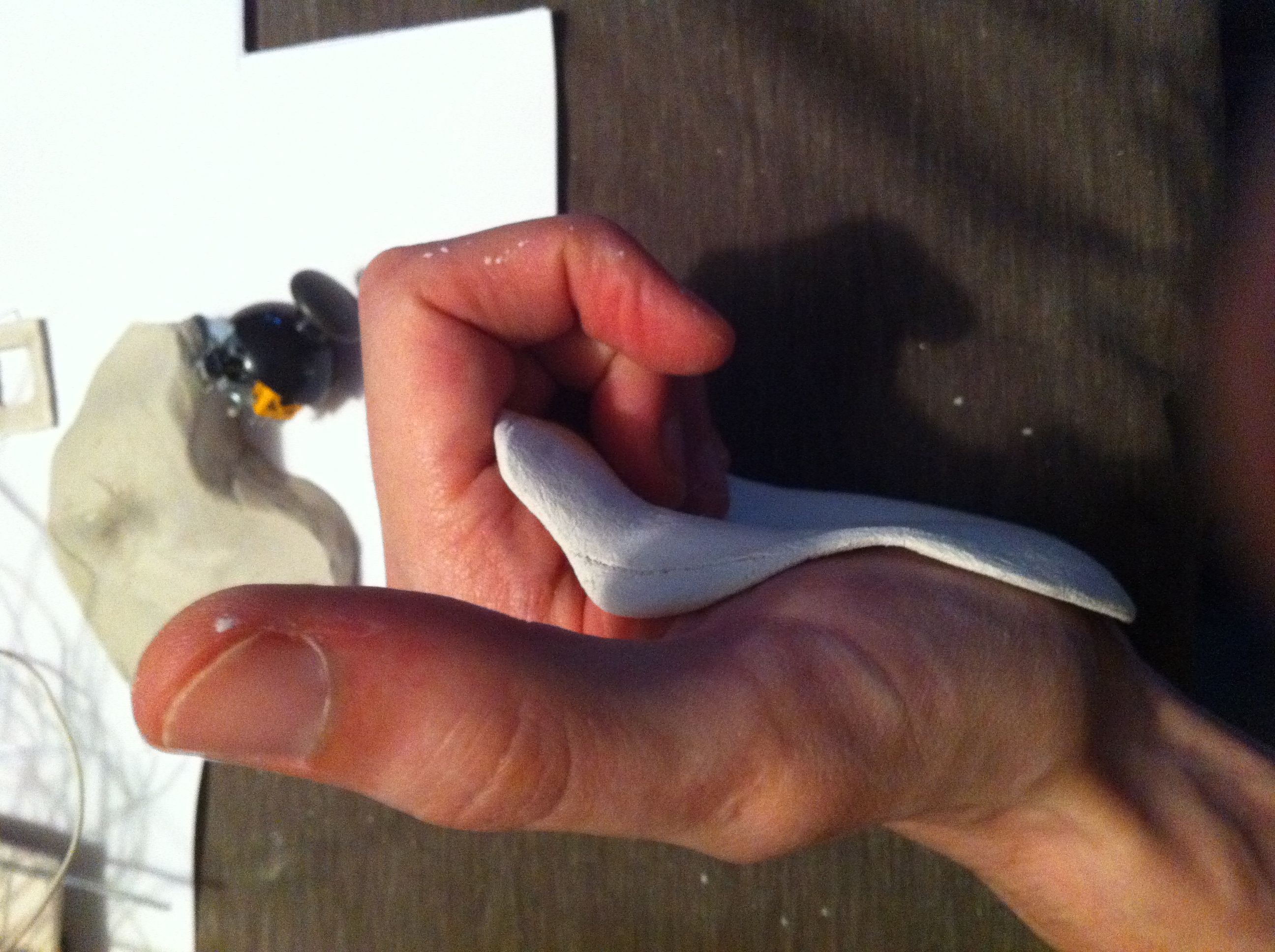

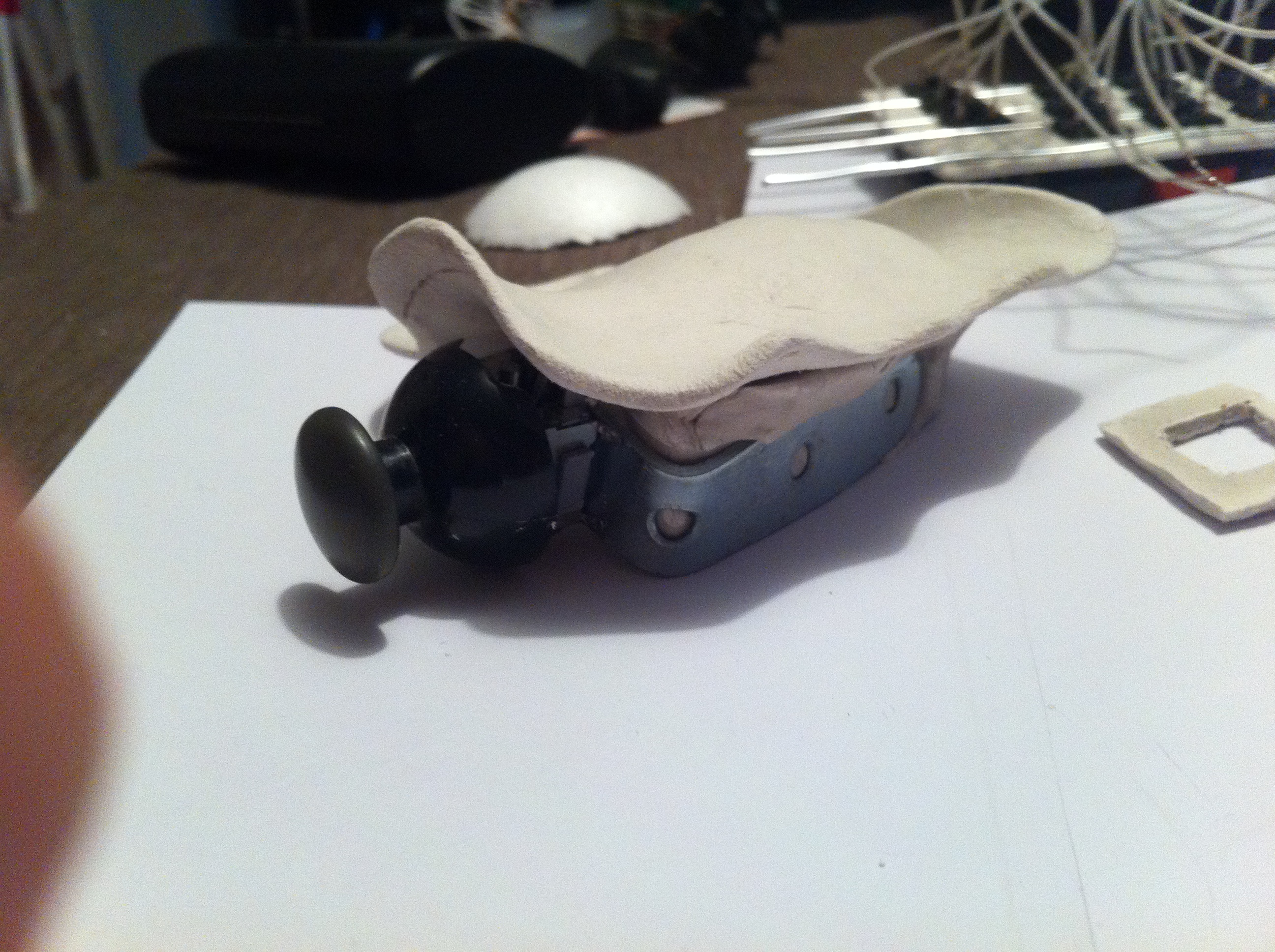

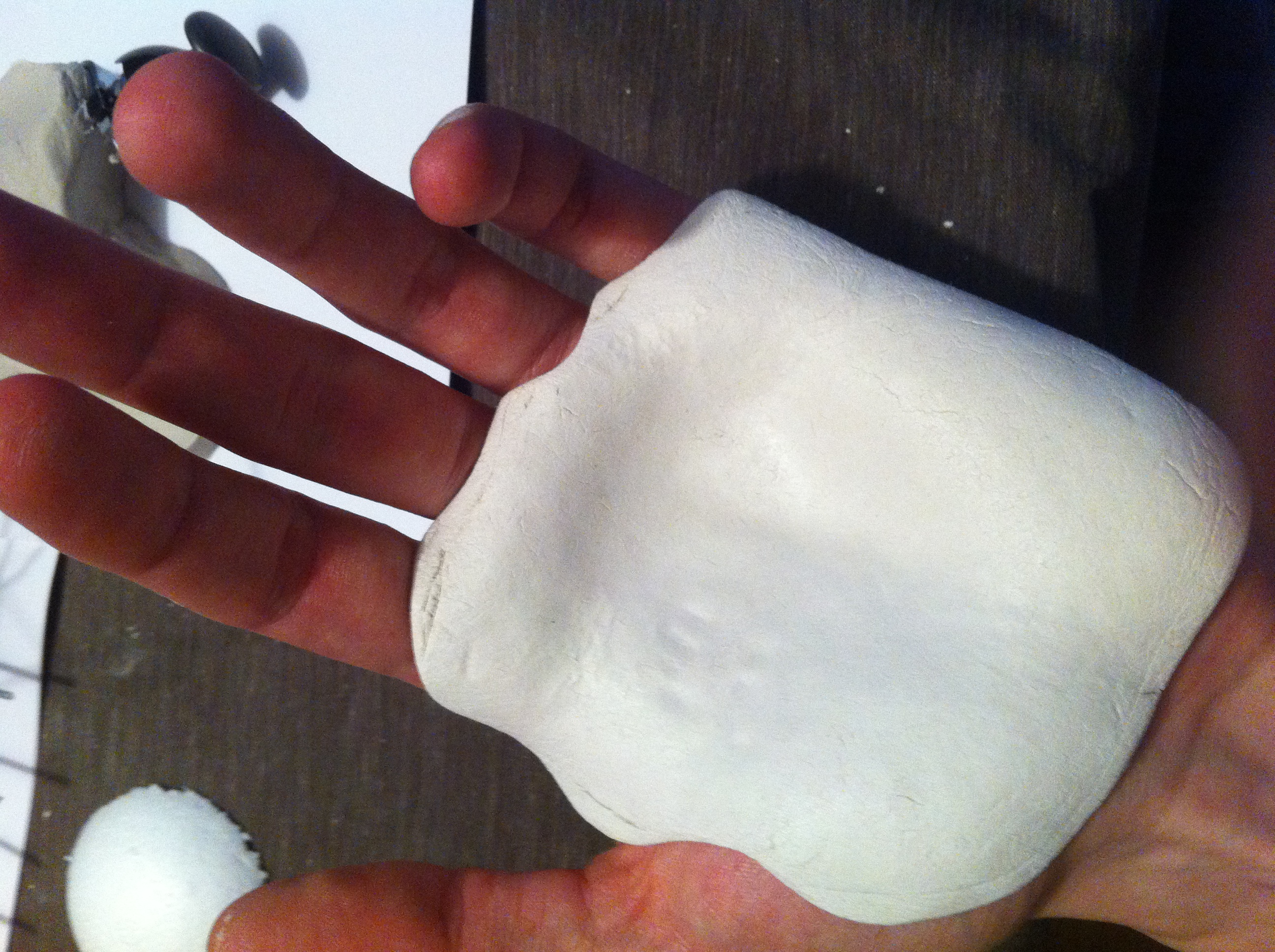

« Reply #8 on: Tue, 19 June 2012, 16:43:36 »
trying different mats to model the design and egro :
[ Attachment Invalid Or Does Not Exist ] 53278[/ATTACH] [ Attachment Invalid Or Does Not Exist ] 53277[/ATTACH] [ Attachment Invalid Or Does Not Exist ] 53276[/ATTACH] [ Attachment Invalid Or Does Not Exist ] 53275[/ATTACH] [ Attachment Invalid Or Does Not Exist ] 53274[/ATTACH] [ Attachment Invalid Or Does Not Exist ] 53273[/ATTACH] [ Attachment Invalid Or Does Not Exist ] 53280[/ATTACH] [ Attachment Invalid Or Does Not Exist ] 53279[/ATTACH]
[ Attachment Invalid Or Does Not Exist ] 53281[/ATTACH] [ Attachment Invalid Or Does Not Exist ] 53282[/ATTACH]
« Last Edit: Tue, 19 June 2012, 16:46:22 by Think »
Offline Think
  • Posts: 14
Cherry Red Saitek Command Unit w. thumb stick replacement
« Reply #9 on: Wed, 20 June 2012, 12:09:26 »

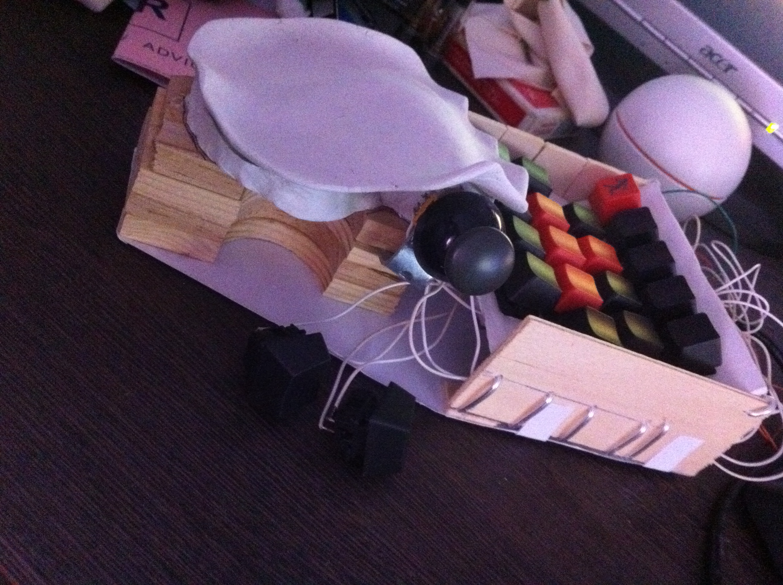

today's work :
« Last Edit: Tue, 31 July 2012, 16:31:08 by Think »

Actualy it's not that hard to do, you need a few mx switches, few keycaps mx compatible, a teensy, few wires, some soldering tool, some clay, wood, few tools and time ^^

« Reply #12 on: Tue, 31 July 2012, 16:32:30 »

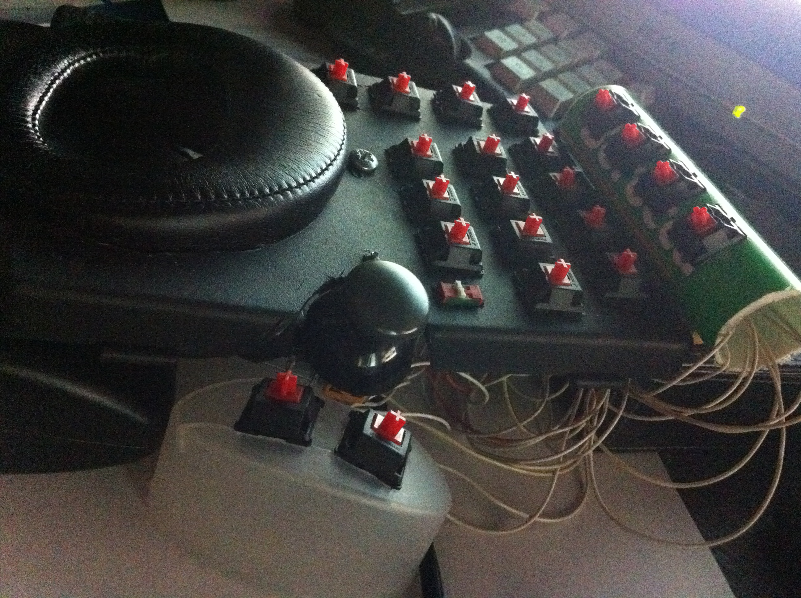

pictures are back o//
still need to work on the 2 thumb button, but not much time lately

« Reply #15 on: Thu, 02 August 2012, 17:23:59 »
well, once you get your hand on a teensy, it's just super easy to build, just need a lil bit of knowledge in C programation, but there are plenty of tuto and exemples of drivers programe for the teensy.
The hardest part is to find the proper mats to build the structure to hold all ur switches. At first I was thinking about 3D printing, but I figured out you need to make some prototypes with clay, wood, lego, whatever mats, to test the ergo before all. Coz 3D printing is still kinda expensive.
So this is definitly not my final version, but as I said, not mutch free time to work on it lately, so, for now I use it like that.

« Reply #17 on: Thu, 02 August 2012, 17:38:02 »
same for me, but clay is definitly a good mats to start with. Easy to model, and easy to modify once dried.
