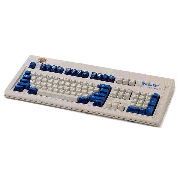

So I got the Wildcats Buckling Spring keyboard from Unicomp. I wanted this keyboard to stay at work so I wouldn't have to leave a $100+ keyboard at work overnight. I work at a call center and they have some new agents just out of training that haven't gotten permanent seats yet. One of these new agents sat my desk while I was off work. He apparently unplugged my keyboard to use a standard dome keyboard, probably was afraid he'd break/damage it. Well break it is exactly what he did. When I arrived to work this morning, some of my keys wouldn't work. I unplugged the PS2 and looked at it, some of the pins have been broken off. He might've tried to force the PS2 back in the connector.
So what can I do now...? Can I replace the cable or do I have to send it back to Unicomp?
This sucks. I really like this keyboard! :(

m00nshake,
Would you mind posting some pics of what (if any) additional printing is present on the non function blue keys on your Unicomp?

Re: Unicomp Keyboard Broken by Cow0rker...! :(
« Reply #39 on: Sun, 07 October 2012, 14:14:23 »
I mean do any of the blue keys (besides the function keys) have any thing printed on them besides what you normally expect on any other board?  I say besides the function keys because those appear to have Kentucky printed across the top, with F1-F12 printed on the side.  Was curious if any other of the blue keys have anything extra like that.
« Reply #42 on: Sun, 07 October 2012, 17:07:42 »
Found this pic on Google images after searching for some old pics posted by snarfangel for his Unicomp Wildcat unboxing:
