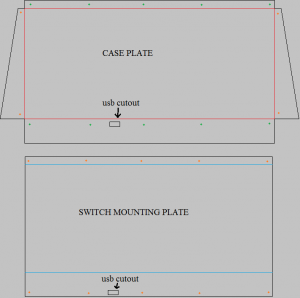

apologies if this is too off topic:
so a sweet metal cased keyboard with the custom layout i posted would be freaking awesome
my thought was that maybe this custom hard wired plate idea could be extended into a full custom keyboard
I did a quick search and didn't really see anything on making a case out of a sheet of stainless steel but that's what I'm thinking about.
here's a quick ms paint concept scrawling:
17452-0
green dots are through holes, orange dots are tapped for screwing into
imagine bending flaps out of the page on red lines and into the page on blue lines
switch plate goes inside the case plate
screw in L brackets on the outside of the corners for some structural integrity
make flaps on the case plate longer than the ones on the switch plate to create a nice lip
I feel like if it is possible to bend decently thick gauge stainless steel this could make a real solid feeling case.  Anyone have any thoughts? see any problems?
« Last Edit: Mon, 01 April 2013, 06:01:40 by scumyc »

Ok, found the time to take measurements...
But this CAD tool is a PITA for me, cant get the hang of it!
@Matt3o
Any chance they will also accept a drawing with measurements for a small bonus?

if you are extremely careful you can also work with inkscape and export to DXF. It worked for me

Here is a compact TKL I've been thinking about based on Ron/Matt's template.
The layout is almost perfect for me although I'm split between keeping insert/delete in the regular vertical arrangement and putting DEL next to backspace.  It avoids a short right-shift but does require some 1x1 on the bottom row for the right modifiers.
Font is changed to Segoe Light, no idea if/how I'd get the caps made :D  The volume up/down icons need to change.

jdcarpe,
Can you share some of your CAD skills?  I'm using your dwg files as a starting point and draftsight64 (free) to try and design a split board for my custom keyboard (similar to the cherry mx 5000 layout).  I'm curious how you space all of the mount points so precisely - specifically the spacing in between the holes.  For example, in TotalChaos-Fn.dwg, the main keys have one spacing and the larger keys (enter, caps lock, tab, shift, etc) have different spacings between the keys.  Is there a spec somewhere that details these?  And what's the best way to transfer that spec into a CAD program?
Any help would be greatly appreciated...
Offline TD22057
  • Posts: 177
Here's what I'm going to build.  3 piece split ergonomic keyboard modeled on the Cherry MX 5000 (left hand, right hand, numeric keypad).  I figure I can modify the ErgoDox hardware and firmware to support this kind of 3 piece arrangement.  I've made the left side and right side keys outside main field symmetric so there will be arrow keys on both sides.  Above the arrow keys, the right side will have the standard keys (Home/End, Insert/Delete, Pg Dn/Pg Up) and the left side will be programmable (mute, play/pause, other media keys).   I still need to figure out exactly how to correctly space the larger keys in the space bar row but this is the general layout I'm going for.
Thanks to jdcarpe for the original DWG files that I modified...
Offline TD22057
  • Posts: 177
In case anyone cares, I was able to answer most of my own questions today.  Found a reference that states the standard 1x1 keycap uses 3/4" x 3/4" of space.  wasdkeyboards.com has a reference that shows the various sizes of all of the keys.  I used the files from jdcarpe as a starting point and resized the key switch holes them to match the specs from Cherry (1x1 holes were slightly undersized).  I drew 1x1, 1x1.25, etc squares for the various keys and then centered the switch hole in the middle of the squares.  I'm not completely sure about the key sizes >= 1x2 as the hole design for the stabilizers seems a bit different than the Cherry web site and the files from jdcarpe use two different styles for those keys.
If anyone is interested, I have a .dwg file with the keycap rectangles and centered switch holes which makes it pretty easy to design a full layout.  The keycap squares make it easy to line everything up then I go back and erase the outlines to leave just the holes.  I used free DraftSight64 CAD software to do everything.  I haven't actually build a keyboard from any of these files so there still could be mistakes...
In any case, here is my updated three piece split plate design showing the keycaps.
I'm glad you were able to figure everything out. My 1x1 holes may be slightly undersized, as when I was starting to learn how to draw these plates, I used the hole drawings from the original Phantom plate drawings.
I use the same method you use to get the spacing correct. I draw boxes of the correct size for the keycap, based on 1-unit being 0.75" then center the hole in the box. I made some prototypes with the "new" 2-unit stabilizer holes, but the little cutouts are too thin, and bend easily. The holes where your split spacebar is are my final, go-to stabilizer hole. It's based on the Phantom design, with the top slightly modified so you can open the switch without desoldering.
Great job on your plates!
