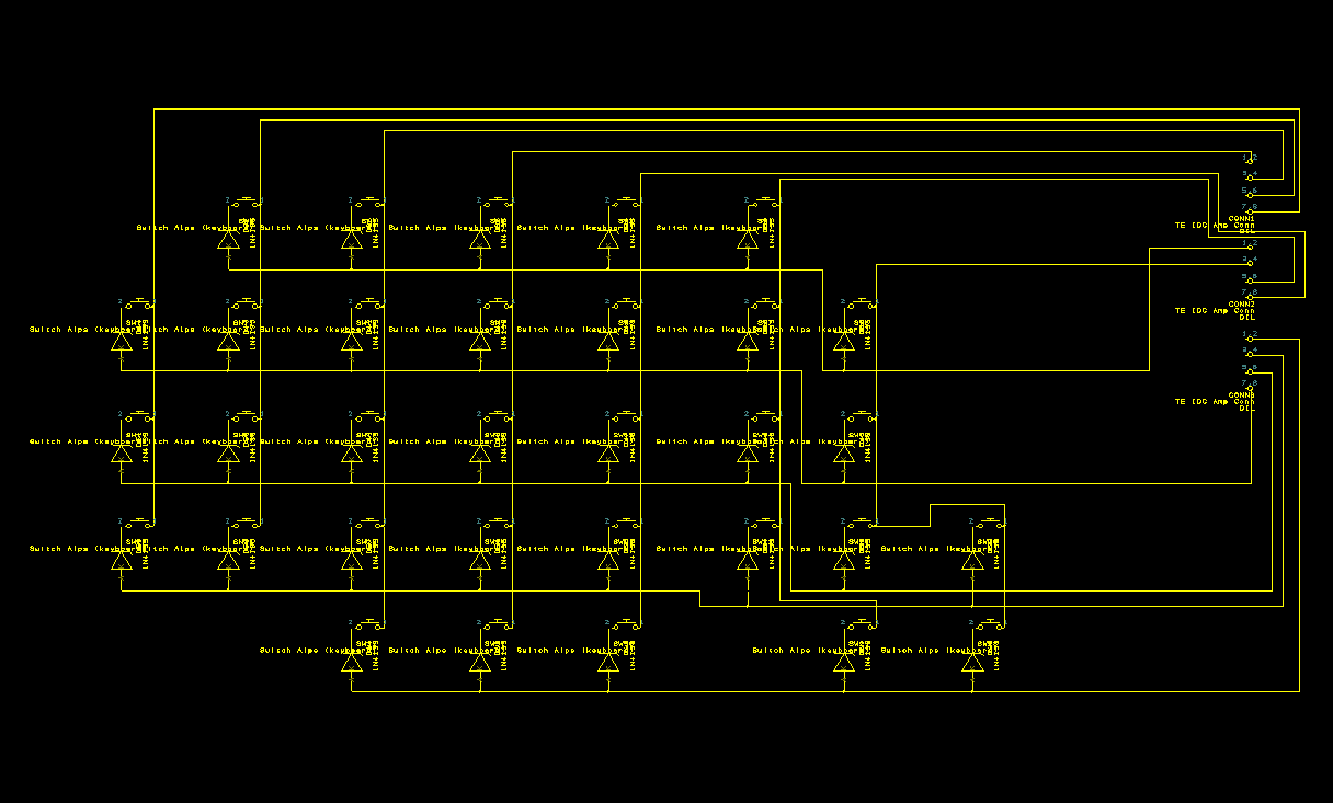

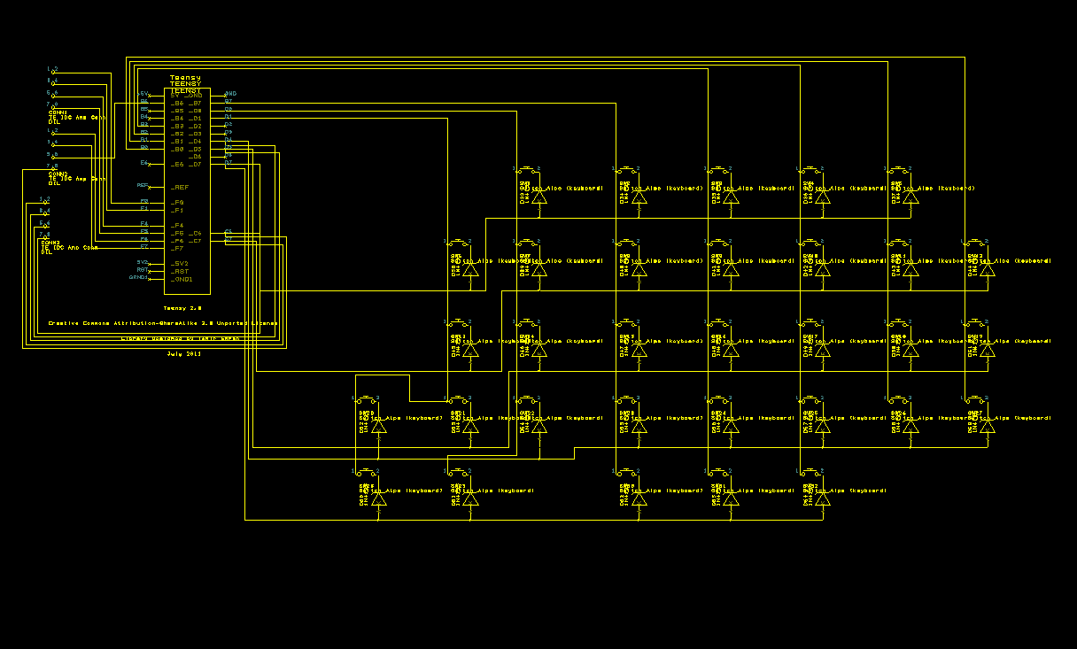

Hi folks, a little help if you could, i setup a 64 key (32keys each hand) split keyboard. I got one half of the keyboard working with easy avr firmware but could not get the other half working with the exception of one or two keys. I've checked and triple checked the connections and they all seem to be fine. So i decided to go the tmk route since i could dig into the code.
Now after compiling the firmware and loading with the teensy loader none of the keys in any of the halves output anything when pressed. My desktop is linux if that matters. I'm not using leds so i dropped them from the pinout I'm using the gh60 as a base per matt3o directions
files are at the links below
matrix.c :                    http://pastebin.com/Mz7VyrkQ
config.h :                    http://pastebin.com/yMJuJfAs
keymap_common.c : http://pastebin.com/qhmJZHM8
keymap_common.h : http://pastebin.com/tEAuA8Nz
keymap_poker.c        http://pastebin.com/bG7QPv36
Update:
letf hand schematic is as follows : http://ibin.co/2Ec5qvQgqrHp
right hand schematic is as follows : http://ibin.co/2Ec6ZsucNLTZ
I'm using a simple short cable between both halves no port expanders. I'm using a teensy 2 as the controller.
Any and all help is appreciated.
« Last Edit: Sat, 05 September 2015, 10:18:24 by nalui333 »

Offline a-c
  • Posts: 196
Re: TMK keyboard firmware
« Reply #886 on: Sat, 05 September 2015, 10:26:32 »
Update:
Because of the direction you have your diodes installed what you call rows are columns in TMK, and columns are rows.
Offline nalui333
« Reply #887 on: Sat, 05 September 2015, 11:43:10 »
Thanks will make changes and see..
quick question does that mean i have to change the keymap array sequence?
Update 09/19/2015
for future reference or for any newb that stumbles on this if you don't want to resolder you can make your keymap_common.h look something like this....

Update:
I made the above changes and got some output as opposed to before with no output.
Though at this time, there's a lot of gibberish and the left hand still doesn't work.
Update 9/08:
All of the left side works well now (there was a bad switch), 3 out of 5 keys in the right half print something but they print a mirror of what's in the left side, the journey continues.
Update 09/19:
seems my choice of cables and choice of connectors between my left and right halves were making it difficult for the (left) non teensy side) to not get the signal. will have to ghetto-ize the prototype for it to work.
Thanks and appreciations to all who helped.
