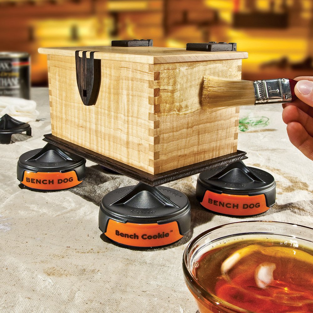

I'm going to get me some of these:
http://www.amazon.co.uk//dp/B007TJ1TRI
http://www.amazon.co.uk/dp/B007OXBKDC
cheap, should make half decent pcb stands hopefully.
