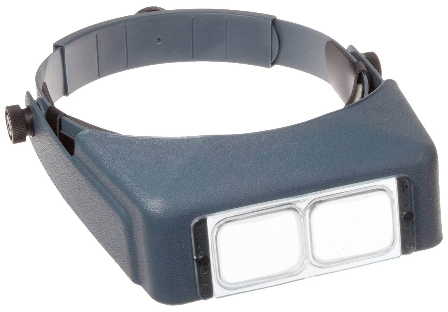

Can anyone recommend a good wearable loupe to help with smd soldering?
These work well for me.
http://amzn.com/B000BPWPRK
