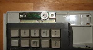

A few months back, I picked up a "Vintage IBM Model F keyboard" for just $56 shipped. I think I got it so cheap because it had a small crack on the bottom right corner of the case. This is a very common crack on IBM 122 key Model F that can be glued back with little effort.
When the keyboard arrived, I was disappointed at how poorly the keyboard was packaged; a single layer of the thin bubble wrap was around the board in a USPS “game box” mailer. The keyboard slid freely left and right, up and down, and side to side; and it rattled. I should have complained, but the value of the parts for me was still > $56, so I didn’t bother.
Fohat.digs suggested that a case swap with a Model M might work; I thought so too, so I looked for a cheap “donor” keyboard and found one for $25 shipped. The packaging was very good with this one; a huge box with a lot of styrofoam peanuts. Below are some pictures. As I take more pictures, I will add them to this original post.

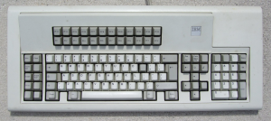

First, this is how they look before i clean them up.
26229-0 26231-1

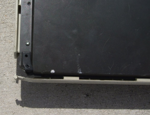

Here is a close-up of the damage. The missing pieces have broken up into small pieces. It was bounced hard enough to bend the thick metal bottom plate.
26233-2 26235-3

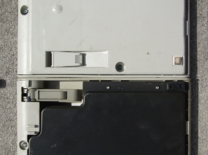

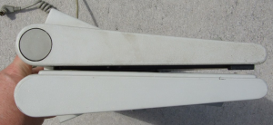

The bottom and sides.
26239-4 26243-5
26241-6 26237-7

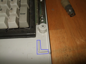

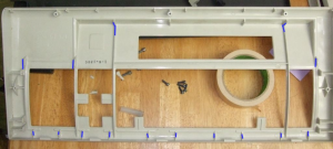

The insides - top needs a trim (use wire cutters) for many of the stand-offs here:
26245-8 26320-9
The insides - bottom need to remove raised area here:
26247-10
And one last trim on the F base plate on both sides:
26322-11
Test the fit and bolt back together.

The case swap is done and works; I updated the original post.
I just need to do a restore on the key assembly now. Many keys do not spring back when pressed. The space bar is seriously damaged with deep scrapes on the top and missing the wire stabilizer. The M space bar is in good condition, but the F uses a thinner wire so the M stabilizer does not fit in the F's retention slots. I'll have to get creative again.

Adding some comparison pictures of F122 and old style M122 cases (M on top, F on bottom)
Some more pics at http://imgur.com/a/j46wV
