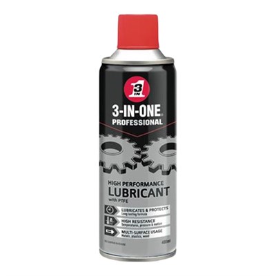

Has anyone tried WD-40 PTFE dry lube before? I'm asking because even though it's a garbage scam "dry" (read: extremely waxy) lube that I almost washed off it's made my worn in salmon m0116 feel almost identical to my barely used one. It's still slightly rougher feeling but the binding, upstroke clicking, and heaviness are all gone without changing the sound.
I've had it on a test key for two weeks and the rest of the board for one without issues, but despite saying it's plastic safe it contains petroleum solvents and cyclohexane, which isn't filling me with confidence.

i've used Dry PTFE Spray Lube (i only coated the stems) for an initial/partial test with decent results. this coming from using PTFE spray with machinery, bushings, bearings, moving parts and such for say... last 20+ years? and knowing the properties of the dry lube. i currently have a can from CRC.
the one i have does say liquified petroleum gas (but that's probably just the propellant) the main spray is an isopropyl alcohol base which is why it dies so fast.
i'd probably stay away from the common household brands and go for more of the industrial or less common brand. household brands seem to be a little "dummy proof" in my opinion. instead of an industrial brand that is adhering to more strict specs, makeup, MSDS, etc...
you don't have to use a dry lube on alps. it's just most alp switches are very old (even new old stock) and after a couple decades, the lube that the factory may have put in the switches has probably dried out. this seems to be a common misconception.

I have tried this dry PTFE spray on white dampened sliders.
It was … useless after 2 days. At first it was a little bit better but not crazy, even with 2 applications.
Yeah that's definitely my takeaway since the stuff I sprayed on looks like teflon in a really thick mineral oil or something and it works really well.
Also these worn in alps were almost immaculate (a deep clean barely did anything), and when I compared them to my good salmons the only visible damage was from the tactile leaf tearing up the side of the slider from years of use. So lubing just to prevent wear seems wise.
Anyone have suggestions? Anything's probably wiser than the oil refinery runoff I sprayed all over this thing at least.

any of the common lubes is fine. (3203, 3204, 205g0, etc... plus, many alternatives)
- the consensus is not to use something too thick a lube on tactiles
- springs can be lubed as well to help reduce ping
- watch a couple videos as tutorials if needed
