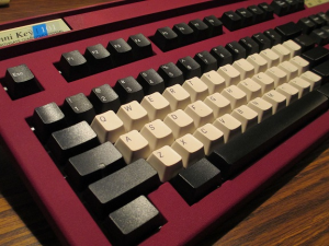

Recently, I bought a  Northgate Omnikey 101 ANSI white Alps keyboard from "Northgate Bob".  He selected the best one he had available. It is not NIB/NOS, but reasonably pristine. It was very clean and had only a few small spots of corrosion on the plate.
After removing the keycaps and case, I cleaned the plate and the outside of the switch tops using dry cotton swabs, taking care not to leave any cotton lint behind. After soaking the case in detergent overnight, rinsing with water, rinsing with 70% isopropyl alcohol, and drying overnight, I painted the top shell burgundy red with several light coats of Duplicolor vinyl & fabric coating. I put the painted case aside for 8 days before reassembling the keyboard. I did not paint the bottom metal pan, but I used mineral spirits followed by 70% isopropyl alcohol to remove the glue from the inside that held the ferrite core in place.
Next, I installed an internal Orihalcon/Soarer USB Converter and panel-mount micro-USB connector. I replaced the solid ferrite core with a hinged ferrite core that has a 5 mm opering. I placed a piece of 1/16" thick "art foam" cut to size between the PCB and bottom pan. I then installed new keycaps. For the top row, number row except Backquote and Backspace, Nav Island, and all but the number keys on the Numpad, I used WoB Tai-Hao ABS doubleshots. Alphas and NumPad numbers = dye-sub PBT from an SGI Granite. All others = blank black ABS from Matias. Per my standard procedure, I've programmed the board with a HHKB-like layout.
For the spacebar, I used a stabilizer, clips, and inserts from Matias. I removed the stock shock pads because they are in the wrong position for the Matias spacebar and they interfere with the Matias stabilzer wire. I put new shock pads on the plate where the stabilizer inserts hit the plate, using self-adhesive 0.15 mm polyurethane foam. To deaden the spacebar, I put small rectangles of 0.5 mm self-adhesive foam rubber inside the space bar. To quieten the spacebar switch, I installed a new slider from a Matias Quiet switch, but I kept the white Alps click leaf. All this results in a very quiet spacebar with no rattle.
152074-0
I kept everything else intact. This time, I did not open and clean the switches (except for doing a slider swap on the Spacebar switch).
The keyboard is smooth with crisp tactility and just the right amount of clickiness for me. The switches feel consistent across the board. I have not noticed suppressed clicks, return-stroke clicks, chattering, or binding. The board provides a splendid typing experience that compares favorably with my all-time favorite keyboards (these include my IBM XT, silenced and lubed RF87UB55, silenced and lubed HHKB Pro 2, Leading Edge DC-3014 blue Alps, and cleaned and lubed Northgate Omnikey 101 ANSI white Alps).
As with my previous Omni 101, I found that I could not use the dye-sub PBT caps from an IBM 5140 (brown Alps). These caps have worked well on several other Alps and Matias-switch keyboards, but they do not bottom-out consistently on the Omni 101 keyboards. This is why I ended up using caps from an SGI Granite, even though I am not fond of the Italic font. Does anyone have any idea why the IBM caps do not work well on the Omnikey 101 boards?
@MandrewDavis: Let us know how you get on with click-modding your Zenith. I have a Z-150 with Green Alps and a 163-73 with Yellow Alps that I am considering click-modding. It's nice that the procedure is reversible. Does this mod require pine switch tops, or is that just your preference? That is, would it work with the bamboo version of white Alps tops?

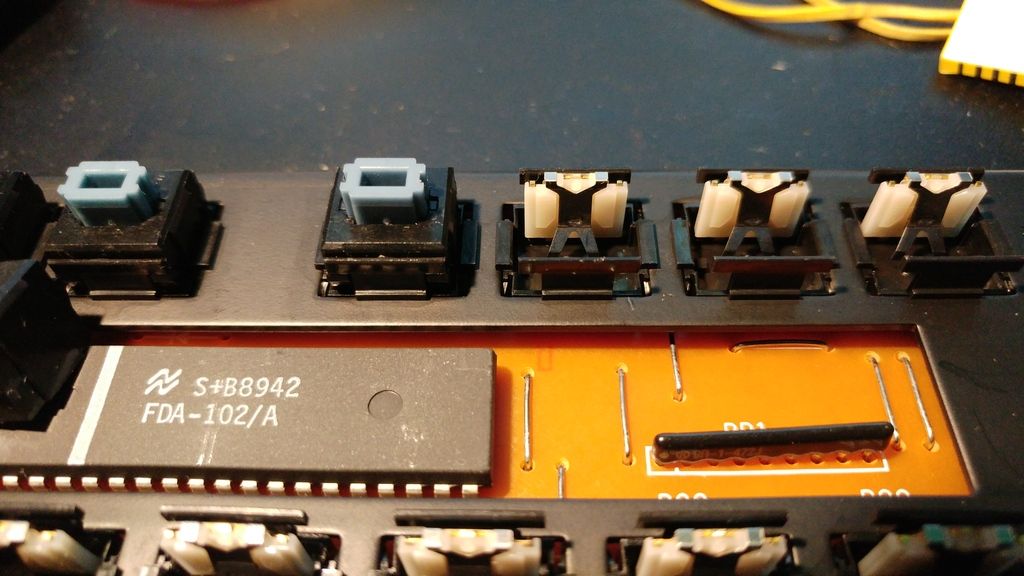

Why not hold out for a Wang or something else a bit more exotic? I feel like they deserve something a little different, but I'm not sure what to suggest.
So I got the perfect exotic you were looking for E3E. A Zenith 163-73 I bought from Wingpad!
It's the perfect candidate since it only comes with SKCL Yellow. Has that buzzer which would still make logical sense since I'm swapping using SKCL, plus in cap leds! I do hate how the led's are green not red but luckily I have 3 original led SKCL Green's from my old Z-150 so it's perfect for it. Zenith build quality as well. The main difference though between the ZKB-2 and this is that it has a plastic backplate and alps dyesubs. A fair trade off I suppose.
Plus it has the SKCL GRAY I need. It's a win-win-win!

Sweet man, do it! Slap in the Striped Ambers, use SKCL Grey as the space bar switch (or Amber, either way haha), and it'll be fantastic. It'd fit those switches well.

Yea. I'm excited to have a board with a beeper and in cap lock lights again, makes it so interesting. Wasn't able to take advantage of those in my Z-150 since the board wouldn't work on Linux without a USB converter and that didn't allow the leds to work :( It needs good cleaning and a retrobright badly. Unfortunately I ran out and it's fall/winter right now so idk when I will have a chance to do it.
Was actually planning to just use a normal SKCL Striped Amber for the spacebar. The Grey is for the switch tester.

You're helping too, haha. I went with a shade of gray close to Industrial Gray. It's done but there have been some issues with billing and getting it shipped but it should be here soon. Anyway, I think I might get kicked for mentioning buckling springs here. Quick! I need to hide my Model M and grab my Omnikey! Blue Alps FTW, tooooootally.
Stuffs his Model M in a nearby box
EDIT: Also, more relevantly, I might have found my favorite switch Alps "Ghetto Blue" Switch. SKCM Browns with a SKCM Blue Click Plate are delightfully tactile, airy and light. I quite like them and would consider building a board with them if it didn't mean killing two varieties of rarish Alps switches. Here's crappy video, it doesn't really do them justice.

I have bought a Packard Bell T8023 at Taobao recently. This is a lovely keyboard and I cleaned it today, but wait...
I know the difference between blue and white alps are quite small sometimes, such as blue alps with ALPS logo top-housing or white switchplate instead of grey switchplate,
but these are not white switchplate only, these are white switchplate with white alps leaves!
A Japanese found it also.

Wow, short switch plates too? It seems like blue Alps and white Alps had a very small period of crossover where the earliest white Alps was very close to blue Alps and the latest blues, as shown in your example, are similar to whites. Very peculiar.
You grabbed that one up quick. I noticed that one on TaoBao.

Hah, that's funny, I recorded a very relevant video to this phenomenon very recently xD .
I'm not sure those are short switchplates though. They look long to me.

I think that theyre short switchplates, Ive had white switchplate blue alps and the color of the plastic on the switchplate is different than the normal short switchplate plastic. Those dont really look like tall white switchplates.

They're definitely short switch plates as you can see them raised up over the bottom housing's "floor" there's no way that'd happen with a long switch plate unless the switch was desoldered and the plates got pulled up during switch top removal. The long switch plates are flush with the bottom.
