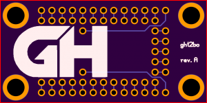

To be perfectly honest The reason I don't want to use this is because i don't want it near that large.  And I do not want to have to rely on any sort of adhesive to keep my teensy secured.
here is what i would like it to look like
Green = pcb
Orange = solder pads
Black circles = holes for teensy2.0 pins
small white holes = soldering wires for direct wire matrix
large white holes = securing to case via standoffs

These should get you started.
View gerbers with gerbv. Edit with geda/pcb.
* gh_teensy_2_breakout.tar.gz (15.32 kB - downloaded 355 times.)
please double check that all holes are in the right places, and are the right diameters before you send to OSHPark...
« Last Edit: Mon, 08 July 2013, 19:01:03 by OldDataHands »

27578-0

That is absolutely perfect.  My one question is if the mount holes in the corner will accept a 6-32 screw since I already have standoffs and hardware in that size.  Aside from that question I would assume that this is ready to take to a web based PCB manufacturer.
The mounting holes are drilled at .140,
and will get plated down to maybe .134
while 6/32 is .137.  I'll update tonight if I
can get a few minutes.  Should have an
internet connection tonight too, so I can
check that the upload to OSHPark will
be smooth.

« Reply #29 on: Tue, 09 July 2013, 23:01:58 »
Here are the updated gerbers (ready to be uploaded to OSHPark):* ght2bo.zip (8.34 kB - downloaded 359 times.)
and here is the matching geda/pcb file: * gh_teensy2_bo.pcb (33.54 kB - downloaded 363 times.)
and here is a rendering of the board: 27687-2
and finally pricing: The board is just a hair over 2"x1" according to OSHPark. at $5/sq.in.
it comes to $10.15 for 3 of them, or roughly $3.38 per board, shipped (in the US).
We would have to order 80 of them to get into bulk pricing at OSHPark, which would get us to ~$2 per board,
and then someone would have to reship them all.  I think the hot setup is for anyone interested to put in their
order individually to OSHPark.
I've upped the mounting drill to 0.170 inches, which should be nice for your 6/32 mounting hardware.
The other drills are now at 0.044 to provide a bit more clearance for pins.
Plus, I've incorporated the the GH60 "GH" in the silkscreen for fun.
Some brave soul should call dibs, and order the first set to confirm it's correct before everyone dives in...

« Reply #30 on: Tue, 09 July 2013, 23:16:05 »
I will do order right now

« Reply #32 on: Tue, 09 July 2013, 23:39:13 »
so which of those file/s do i upload for oshpark?
Offline OldDataHands
  • Posts: 280
  • Location: Michigan
Re: Looking for a bit of PCB help
« Reply #33 on: Tue, 09 July 2013, 23:40:30 »
You just need to upload the whole .zip
After that you'll just verify that it looks correct.
I already walked through the upload process with that .zip, and it went correctly so it should be stress free.

« Reply #35 on: Tue, 09 July 2013, 23:54:03 »
Thanks man order is placed

$10.15+$5 for USPS Priority Mail for a total of 15.15 for 3 boards.  Which was the minimum order
