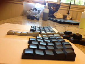

I thought I'd get a few pictures out of the first 5 completed cap types.
68291-0
On the right half, I staggered the columns to their approximate position. Because of the rather aggressive stepping of the different rows I chose not to have as aggressive of a column stagger as I had originally designed. The taller rows made it clumsy to move fingers across columns if there was too much of a column stagger because of the height difference.
In the background you can see a bag full of dud caps. I probably culled about 50% of the caps I cast. As I made more I figured out some of the reasons some failed and by the end I was batting about .900. Because the resin was so fast to set, I had to learn how much time I had to stir so that it was well mixed but still quick enough to have a good flow on the pour.
I may come back and cast a few more for spares and to replace some of the more marginal caps.
Another view. You can see the different sheen on a few of the caps. I think I put too much mold release on them and it affected the finish.  The aluminum masters are in a row in front
68293-1
There are some noticeable flaws in the bottom row caps. For some reason, if the master and the mold is flawed, the castings don't get any better no matter how many caps you make with it.
If I have time I'll fix the master and remold it.

Damn, those look pretty awesome. I really did not expect them to turn out so nice... I may have to look into this.
What kind of resin did you use, and what kind of material to make the molds? I found a couple resin mold guides on here, was there a thread whose advise you followed most closely?

I used a 6" mill  vice and gang milled the bottoms and sides from a 1/2" x 0.72 x 6" piece of aluminum. That allowed me to do all but the top side in one large piece. I flipped the stock over and Tilted the head to make my bevels with it still in one unit. I made a deeper cut between caps to separate them and then angled the individual caps for the concave top cut. I angled the head to about 12 degrees and used a 3/4 end mill to cut the profile.
The last milling step was the trickiest because the vise had only the thin cap walls to grip and I did distort one cap slightly by crushing it in the vise.
I finished up with some sanding and sandblasting to even out the finish. I was hoping for a more textured finish but at least it's matte and fairly consistent.

Hopefully I can finish up the thumb key masters tomorrow and have them cast by the end of the week.
68389-0

I'm finishing up the 'bodywork' on my keyboard and beginning the painting. I couldn't resist taking a few pictures.69122-0
69124-1
69126-2
I can't wait to have you try it out at Keycon 2014.

One of the biggest obstacles in making a non standard spaced keyboard is what to do about the smaller caps. I was experimenting with making keycaps out of aluminum and was pretty happy with how it came out. I don't know if I will make them all out of aluminum or just make the 6 different profiles I need and then cast the rest in urethane.
I left a brushed finish on the tops and polished the sides. The caps are standard width but 0.1" shorter front to back and shorter (height) to minimize overall size for portability.
