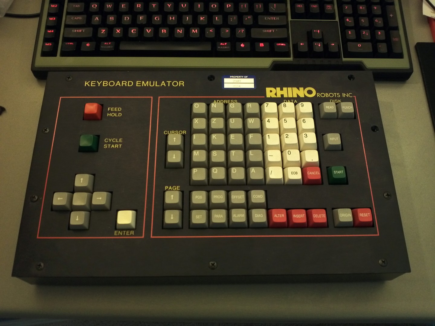

Posting this write-up here in case anyone else runs across these kits.  As noted in the title, despite the look of the key switches and keycaps, these are not MX-compatible.   :(
Looking good so far, nice mix of custom cap legends and colors...  Keyboard emulator?  Looks like most of a full keyboard to me.

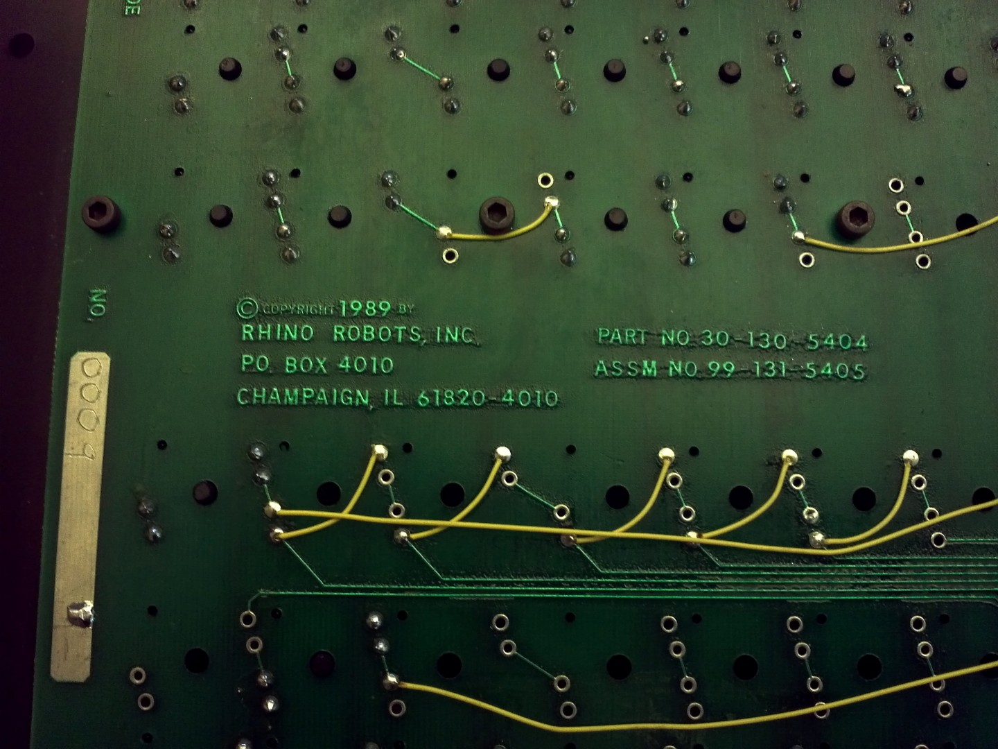

Pretty simple PCB, I think these units were used in a college classroom
36914-1
Cham-Bana!  When these were copyrighted/made, I was going to college a few miles away, and even dated a sorority girl from there.  (Delta Delta Delta. Huh, the things that linger in one's memory...)

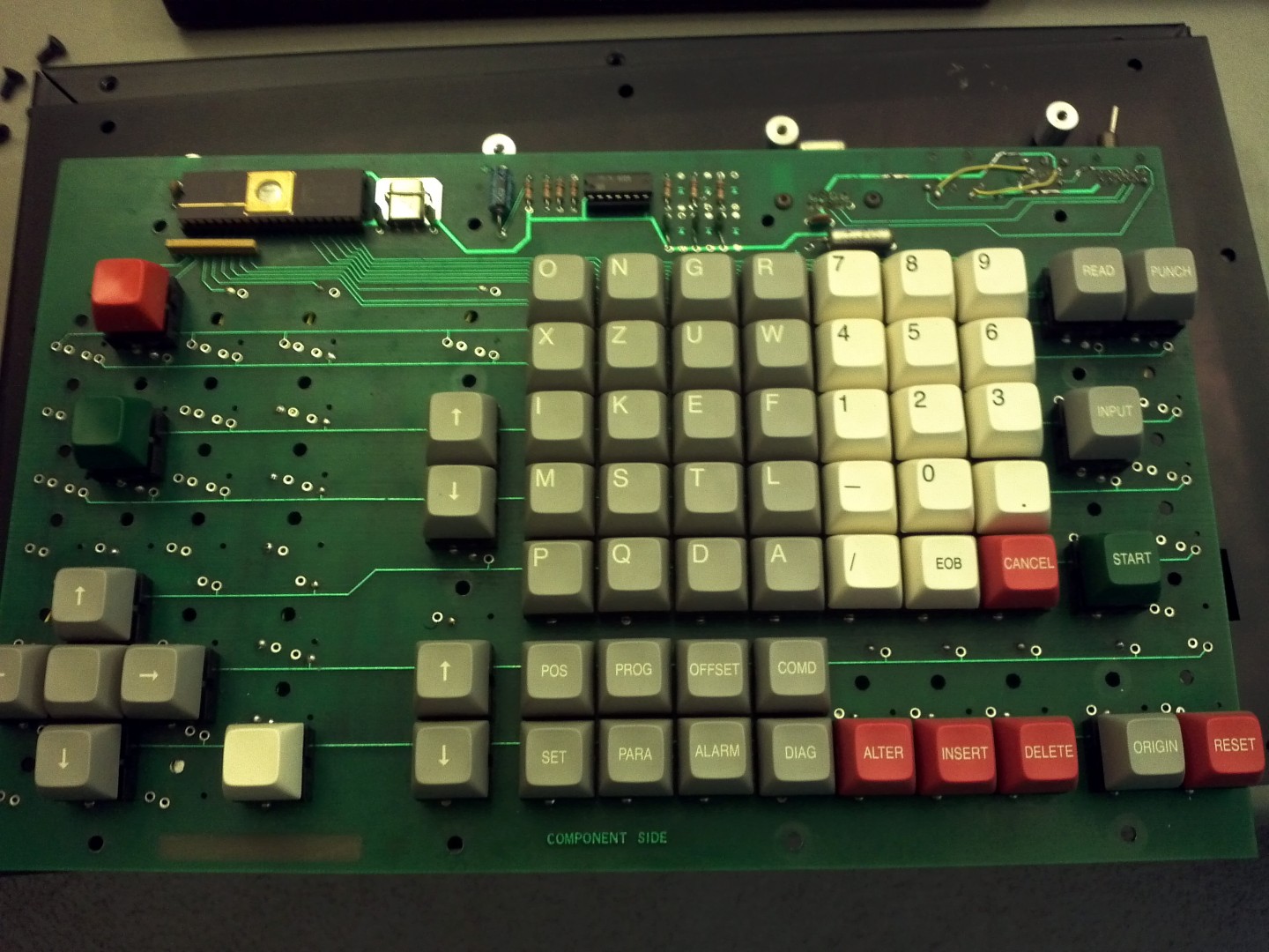

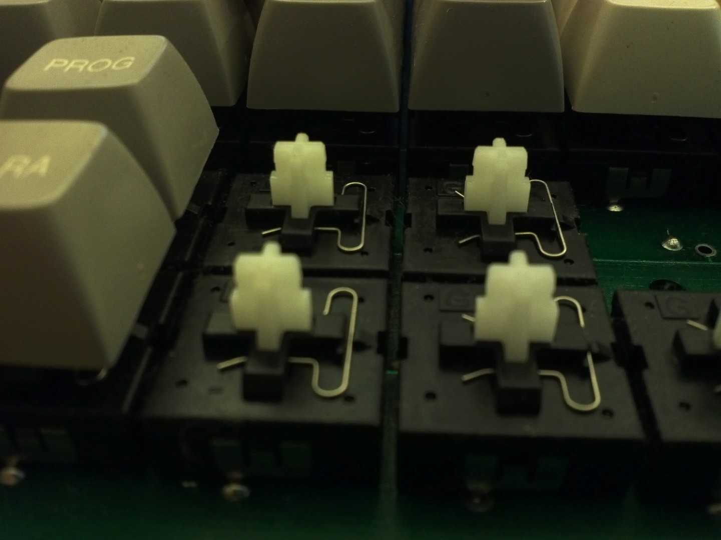

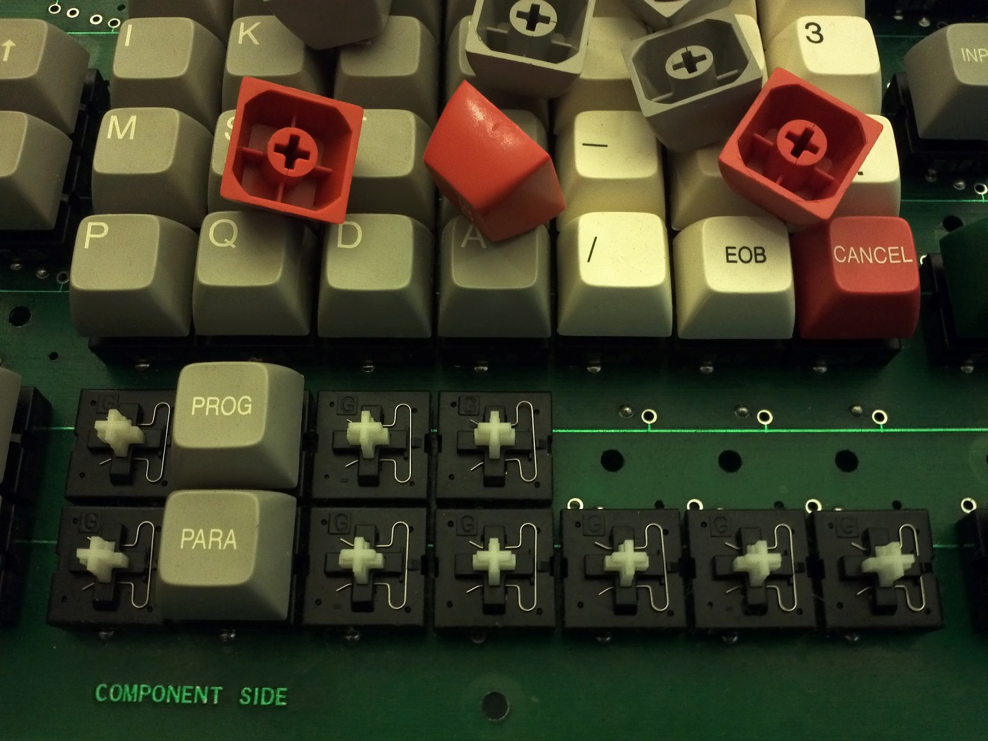

Medium thick caps, all one profile - almost flat.  Switches are flat with a cross-shaped stem...
36918-3

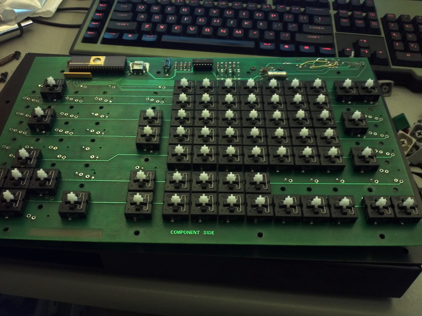

But NOT MX-compatible.  Stems are thicker than Cherry MX, the caps won't fit Cherry switches, nor will Cherry keycaps fit these switches.
36920-4

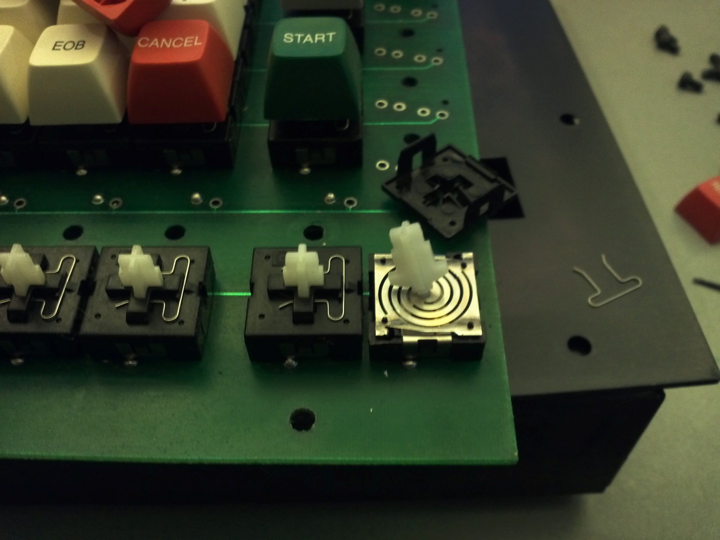

Pretty simple switch mechanism (more pics later once I desolder one...), uses a flat spring to hold the stem up.

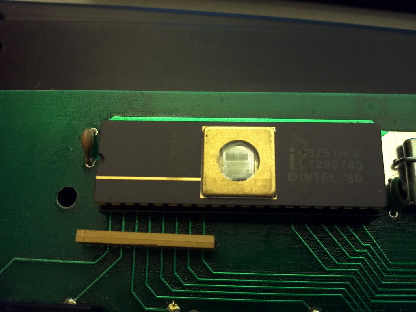

Old Intel chip

Those keycaps were what motivated me to buy them, I may try modding the red/green ones, they have interesting legends.  Just pad-printed (I think), not double-shot or anything.
Very industrial, in keeping with their intended use.

Looks like a line of bench-top robotic assembly/manufacturing systems.
Company seems to be focused on the educational market, teaching students how to program and use robotics systems.

Just like the CHERRY M8 Switch

Depending upon the difference in size between the two modding them to fit on MX could be very ... interesting.
I'd be interested to see a side-by-side with an MX and one of these stems.
It's not, but your having written that was useful, as I just found this page while looking for good M8 photos.
Those switches ..... how truly odd. Those are Apple hairpin spring switches, but they're not Apple branded!
Apple apparently used those in the Apple IIc from April 1984 to August 1986:
http://deskthority.net/keyboards-f2/convert-apple-iic-to-usb-t7256.html#p144313
Someone appears to have removed the Apple logo from the mould and produced another run of switches with another logo. Notice how the "G" logos are all hand-carved into the mould?
This is an Apple-patented switch, filed in 1984, granted in 1985, and lapsed in 1997, making this switch seem a bit suspect, if the OEM was selling these without Apple's knowledge. I can't see Apple permitting their logo to be badly removed from a patented product! They could be clones, but who would want to clone such a terrible switch?
