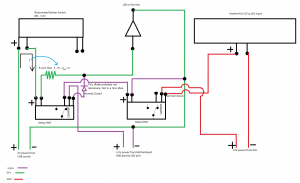

Ok I have drawn up a prototype version of a schematic that I think would work for this.  What do you guys think?
Have your requirements changed about how you're running the lights?  I mean you have a rocker switch now, are you using that instead of holding the function key?

I wouldn't say that my configuration has changed, just revealing a couple more details.

Ok.. but that doesn't really help me make sure your circuit will do what you want :p
Here's what I gather from the circuit diagram you've provided:
When the rocker switch is off:
the HDD 3.3V signal will power the LED directly. (through the normally closed pin of relay 1) [if 3.3V = on, LED = on]
the CCFL inverter will receive 12V constantly. (through the normally closed pin of relay 2) [CCFL = on]
When the rocker switch is on:
the 5V power from the rocker switch will power the LED directly. (through relay 1 signal pin) [LED = on]
the CCFL inverter will receive an inverted version of the HDD signal. (through relay 2 normally closed pin) [if 3.3V = on, CCFL = off, else CCFL = on]
At the moment, relay 3 (far right) does nothing.  If the goal of relay 3 was to turn off the CCFL by grounding it, this is unnecessary.  Simply disconnect anything from the normally open pin of relay 2.  That way, when relay 2 is on, nothing powers the CCFL, and it turns off.
Also, unless the specific relay you're looking at requires them, none of the diodes in the diagram are needed.
One last thing.  Instead of the diode above relay 1 (in green), that should probably be a resistor instead.  If the LED will be driven by 3.3V directly, you will probably want a resistor to drop the 5V from the rocker switch to 3.3V so that you don't damage the LED, and so that there is as little visual difference in brightness as possible.
Revised Diagram:
39716-0
To be clear, what the above does is this:
IF Rocker Switch = OFF
CCFL = ON constant
LED = HDD 3.3V
LED = ON constant
CCFL = INVERTED HDD 3.3V (CCFL off when HDD on, CCFL on when HDD off)

Thanks for the advice.  And the third relay (far right) was to un-invert the HDD signal so end result would be HDD on = CCFL on.  Not sure if I got that one right but yes you got my intended function correct.  I had the extra diodes in there because I wasn't sure about back feeding the signal poles on the relay.  But now that I think about it, it can't back feed because when the rocker switch is off there is a break at the led so no current flow anyway.
So on a side note how did I do in the actual drawing of my schematic?  And yes it was done in MS Paint.

haha not bad, but remember to crop out the white space before saving!  (my edits were done in ms paint too :p)
Ok I've touched up my revision of your drawing to add back that third relay, but this time the circuit should do like before, except without inverting the HDD activity signal to the CCFLs.  Oh, and keep in mind when you collect parts for this, you'll need at least one of the relays to be able to be switched by 3.3V instead of a more usual 5V.  And don't forget, solid state relays! (mechanical relays are noisy!)
Second Revision:
39731-0

Looks good Neebio.  My foreman at work has been into electronics since he was about 10 years old I guess.  Mostly as a light hobby off and on I guess.  I ran this one by him as well and gave him my hand drawn copy of the first version I drew up and the second version you drew up.  I will see what he says tomorrow if he didn't just crash when he got back to his hotel room.
Now with this revision I would assume that I would only need one in SPDT and two in SPST one as normally open and one as normally closed, correct?  Instead of needing 3 in SPDT.  The problem now is now that I am actually looking for specific relays to order and use, the more I look and read on relays (specifically the solid state versions) the more I get this all jumbled up in my head and have no idea which ones I need for this to come out right.  I found one at www.mouser.com with this part number, 849-LCC110P and this one at digikey.com, hell I don't know anymore.
I might need a bit of help on this one.  Also I do want to put that extra diode in the first one on the 5v line.  Any suggestions for part number here?  The first relay doesn't really need to be solid state but not horribly loud as the switch that I am using that will effectively trigger the first relay is a rocker switch that I already have in hand the part number for it is 54-553 from www.nteinc.com.  I ordered it from a local electronics store.
Sorry if it seem that I am asking you to hold my hand but electronics is not my forte.  I do understand some basic electrical stuffs but getting into the electronics side is a touch over my head.  Which is why I wanted to stay away from doing this from the teensy.  That I would have been willing to pay someone to do.  This I think with the right questions and prodding I can get there.
For the resistor on the LEDs when both are lit I went to www.ledcalc.com and punched in the values that I knew.  Voltage drop for each LED (clicked the LEDs in series tab since that is how they are configured in the schematic) I used 3.3, 20mA draw with 2 LEDs and I basically got told that won't work with a 5 volt power source.  I and guessing that I wouldn't need a resistor and they would both be dim as well.  Would it simplify the schematic at all if I used 12 volt from the PSU instead of the 5 volt for the pair of LEDs when they are both on steady?  Using the previous numbers with a 12 volt power source it is telling me 270 ohms calculated and next closest higher resistor is 330 ohms with a 1/8watt rating.
I think I am on the right track with the LEDs but need some help with those damn relays.  Again thank you for any help you might still have for me and all you have already given me.

Switching a CCFL on and off rapidly (like from an HDD activity signal) may not be the best idea. The inverter may not like it since it has to give a large starting current every time it switches on. This may put the kibosh on the whole plan.
Since the Esc LED is on when the switch LED is on, you can run them parallel off a single shared resistor, but it may be best to do as you suggested, running them off 12v, since then you only need the 12v supply and HHD LED lines plus ground (3 wires).
Also, don't forget the forward voltage drop across the diode (probably around 0.7v).

The flashing on the CCFLs won't be very long as this will only happen when I have my keyboard in the function layer.  This even will only be for accessing the "F" keys and media keys.  Plus during normal operation when I would be doing this the HDD LED only flashes briefly about once every second to second and a half at rough estimate.  So, 99.9% of the time the CCFLs will be steady.
I would still use 4 wires for the HDD and the 12 volt power since I already have all four run to the connector.  So for figuring if I can even use the 5 volt power from the USB I would have to add the voltage rating from both LED's and the left side of the relays and that would have to be less than the supplied voltage correct?  If it isn't to much of a difference (say less than 1 volt) would I even need to add in a resister?  So I went back to www.ledcalc.com and punched in the numbers for running the LED's in parallel and it is telling me I can do it with a 47 ohm resistor on a 5 volt supply.  But due to my lack of experience I am failing to see how to power both LEDs while using that loop as the signal wire for the first relay and not have the middle LED steady in all switch states.
