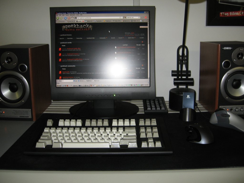

« Reply #238 on: Sun, 09 August 2009, 13:51:20 »
Quote from: ripster;108168
Has anyone tried dying the entire IBM Model M case yet?
I haven't tried RIT Dye yet but I used flat black Dupli-Color Vinyl and Fabric Coating on one of my Model M Space Savers last week and it came out great. Unlike regular spray paint any overspraying gets absorbed back into the plastic rather than glooping up on the surface. The color and texture ended up looking very similar to the black Unicomp cases.
Here are a couple pics:
« Last Edit: Sun, 09 August 2009, 16:34:56 by pfink »

« Reply #239 on: Sun, 09 August 2009, 18:57:42 »
flat black is lovely

« Reply #240 on: Sun, 09 August 2009, 20:24:18 »
Quote from: webwit;108507
Very nice. Perhaps the best case paint job I've seen.
Thanks. I posted details here:
http://geekhack.org/showwiki.php?title=Island:6759
