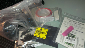

I already ordered some of the parts I might need:
- 100 Cherry MX Blue
- 100 1N4148 Diodes
- 5 Stabs (not sure whether those are the right ones)
- Some flat cable
- 3 Euro sized Perfboards / Breadboards
- Teensy 2.0
Here are some pics of the parts:
Everything I have at the moment

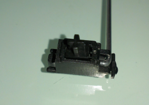

Are those the right stabilizers?

The next step will be to get some 'legs' for the teensy board, hook this up to a
protoboard and do some software prototyping (hopefully I will see some chars on
my screen ;)).

Those stabilizers you got are PCB mount. Since you aren't planning on using a PCB, you will want plate mount, either Cherry or Costar.

Can you please post a mouser link to the stabs I need? It sucks that I bought the wrong ones :(
If you need help or advice, just ask. :)
Sure! http://geekhack.org/index.php?topic=40501.0#post_MM
:D
Edit: Looks like Mouser is out of stock, with an 11 week lead time.
:D
WASD seems to have plate mount stabilizer parts in stock:  http://www.wasdkeyboards.com/index.php/products/keyboard-parts-1.html

Those look like cherry PCB mount stabilizers: I recommend a costar plate mount stabilizer unless you plan to use a PCB.

Can't you somehow salvage those stabilizers? They still go through the plate, it's just that you need to sandwich them between the plate and something else.
Stabilizers have to be just right in order to feel good.  If he's not using a PCB, really don't know how he could get PCB-mount stabs to work properly.
