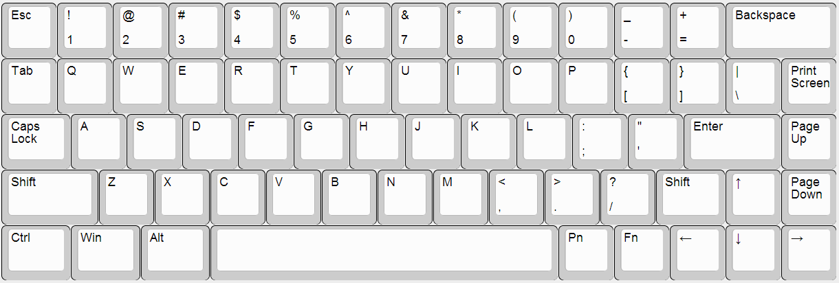

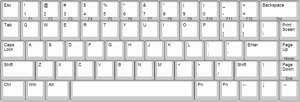

As somebody who wants Arrow keys in a 60% layout, I present the Alt Pure Pro Layout.
57093-0
http://www.keyboard-layout-editor.com/#/layouts/d916484ba0ec37d4befbde2d1d8fefdd
First, the problems with the stock pure pro are plenty. Fn Pn programming is flat out weird, really odd placing of keys, and the dreaded bottom row.
This design solves for many of the problems but there are still one or two that cannot be avoided.
The board will be fully programmable so as long as key positioning is good, there shouldn't be anything to complain about.
It should fit in a standard 60% case now, and I will go for a PCB mounted design.
For keycaps, I am thinking of going with DSA blanks, so the 2x shift and 1x shift won't have to be custom made.

Layout will most likely be:
55750-1
It will be PCB mounted style at first, as getting a plate cut is harder than making a PCB. Cases are the easiest to source for this project. If plates are really popular, I will try to get some made later.

Original OP:

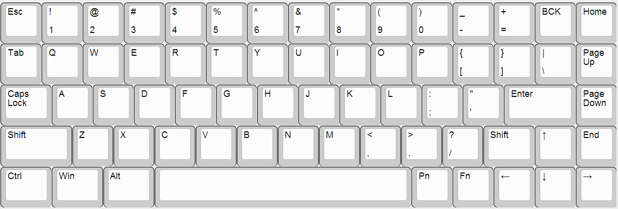

I was thinking of an alternative 60% layout:
55437-2
http://www.keyboard-layout-editor.com/#/layouts/193b06a2ef7b17857b2a07e4ee3c11fc
It fits in a regular 60% case.
Each row in a traditional 60% layout is cut off by 1 unit in total by removing .5 from each end. The exceptions are the top row, R shift, and bottom row, where 1x is removed from Backspace and 1.5 is removed from R shift, and the bottom row is different from spacebar to the right.
In addition, a navigation cluster is added. Arrow keys and Home/Up/Down/End. There is a Fn and Pn button on the bottom row. This can be changed whether or not you use certain keys more or less.
Regular keys for modifier keys can't be used anymore, but the alphas (minus |\) are the same, as with 6.25x spacebar and 1.25x bottom row mods. The sizes for keys are still pretty standard, and any flat profile blank keys can be used without problems.
The bonuses of this layout is arrow keys and navigation keys in a 60% layout that still fits in a regular 60% case.
Thoughts?
In terms of keycaps for people who want legends, without getting a specific pack for this layout, an TKL+ISO kit+Tsang kit will take care of everything except for the caps, enter, \|, and backspace keys.
If somebody could make a PCB for this with compatibility for various bottom row setups, that would be awesome.

Backspace seems like it got forgotten and smooshed.
A small price to pay for the board to be the same size as a standard 60% so we don't need to get new cases

Staggering looks weird,espicially on bottom row awkward but for me for,may not for you. i prefer minila/hhkb jp for staggering

You may want to change the rightmost column to:
  PgUp
  PgDn
  Home
  End
The reason is that everybody (you included I bet) already has muscle memory for PgUp/PgDn located there with regard to the position of the arrows.
With this change, someone who already knows the navigation cluster on a full keyboard or a TKL will just have to get used to the new position of Home and End.

Serious advice: if you can, use two 3x (or similar) spacebars, and make one of them backspace. Just that one tiny change makes a huge difference, even if you don’t ever go as far as a “real” ergonomic keyboard.

I would personally buy the **** out of that if it was produced. The only thing that stops 60% from being perfect in my opinion is the lack of "home/arrow cluster".
Sure its fine on function keys, but having dedicated keys to them makes it just that much easier.
Only downside like you stated would be the lack of ability to ue keycaps unless you buy every pack under the sun.
Thoughts?
  PgUp
  PgDn
  Home
  End
I'm used to having it home up down end since my 75% board had it in that layout. But since this board is custom, it shouldn't be hard to have those keys programmed to whatever you want
I think this is a great idea.
Like this? If so I agree completely.
http://www.keyboard-layout-editor.com/#/layouts/2c656b384460d47375ddae28524e39a6
Hm that looks good but It'll need some time to get used to
I agree that it would take some getting used to (especially since I personally use my right had to activate my space bar), but it really does save a lot of space, and at least for me personally, the backspace key being only size 1, and next to home would drive me insane.

Another layout with a Home and End combined with Page Up and Down, and a bigger Backspace. Space bar was made to 6.25 the standard WASD Keyboards space bar.
http://www.keyboard-layout-editor.com/#/layouts/a44696b3984fa81f53b536c94ff91896
Threw some keycaps together since I was bored.
I rather like that layout. Its better than my design, I forgot about my Fn layer so home on page up and end on page down is genius.
Going off of the split space idea,
55629-0
http://www.keyboard-layout-editor.com/#/layouts/dcb62d327992f2ee1f51e3bd911673bb

And what is the center 1 unit key between the two space bars for?
Offline Pacifist
  • Posts: 3599
  • Location: Cali
  • on hiatus
Re: Alternative 60% layout?
« Reply #21 on: Tue, 25 February 2014, 20:07:35 »
Another layer :))
I don't really know, firmware should allow 100% customization, so you get to pick ;D
Offline ideus
  • Posts: 8123
  • Björkö.
« Reply #22 on: Tue, 25 February 2014, 20:09:12 »
Another layer :))
I see, so it is no more than another mod key to choose from.

Offline Pacifist
  • Posts: 3599
  • Location: Cali
  • on hiatus
« Reply #29 on: Tue, 25 February 2014, 22:27:17 »
R3
55644-0
http://www.keyboard-layout-editor.com/#/layouts/888bf3a4a9a9c4b1a152f42e4b3eb73e
I realized that I only use my right thumb to hit space; left just sits there doing nothing :confused:
But I realize that other people don't have the same tendencies. So with this design, there are three 2.5x caps in the center area.
It should fit pretty much anyone's needs.
So in summary the designs that have come up:
R1:
55646-1
R2
55648-2
and the newest version:
55644-3
Hopefully in designing the PCB none of these parts interfere with each other.

Leaning more towards this design now. Think it may be the one that I will get the PCB designed off of.
made the windows 1x and the pn 1.25x, this allows you to distinguish fn from pn slightly better and if you want say a control and just one extra layer instead of two extra layers you can set pn to control.
55757-0
http://www.keyboard-layout-editor.com/#/layouts/9130f7a12c0e9105f102521d07857580

I believe your plan is to be able to re-use existing cases, so you should be careful about the location of the screw holes in these cases.
I have mounted a Poker 2 inside a Tex case just yesterday, and I'm almost certain that your Q and \ keys are exactly on screw holes. I think it's also the case of your H key.
Offline Matt3o
  • -[°_°]-
  • ** Robot Emeritus
  • Posts: 3549
  • Location: Italy
Re: The Alt 60 Project
« Reply #43 on: Thu, 27 February 2014, 10:44:40 »
I can confirm this (just checked)

Offline Pacifist
  • Posts: 3599
  • Location: Cali
  • on hiatus
Re: The Alt Pure Pro Layout
« Reply #48 on: Mon, 10 March 2014, 19:36:05 »
I will scrap the original idea due to problems with screw mounting.
New version is up, this time based off of the Pure Pro, but significantly better imo
57095-0
Offline ideus
  • Posts: 8123
  • Björkö.
« Reply #49 on: Mon, 10 March 2014, 19:39:30 »
Nice layout, but it would not be better to make the print screen key into a delete one?
