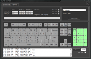

I have the Realforce 23U and just tested it with EK's Switch Hitter and it sends the correct codes. They are as follows:
Keys 0 - 9...

    And this is how the UI displays the keystrokes from the 23U...
