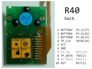

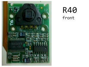

     For convenience, I have attached some pictures.
     This is the one from a R40 keyboard. I have labelled relevant pins (there are two extra pins).
     Front:
     63225-0
     Back:
     63227-1

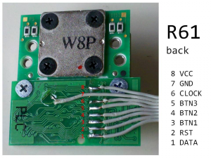

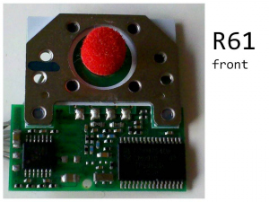

     This is the one from a R61 keyboard. The GND pin is connected to some where else, because I have accidentally ripped the trace
     Front:
     63229-2
     Back:
     63231-3

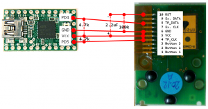

     If using tmk firmware by hasu, some electric components are required to build a R/C network for the RST pin of the trackpoint module, including:
     a. resistor: 4.7k ohm x 2 (pull-up resistors for DATA and CLOCK, one between DATA/VCC, and the other between CLOCK/VCC)
     b. resistor: 100k ohm x 1 (between RST/GND)
     c. capacitor: 2.2 uF x 1 (between RST/VCC, and note the polarity)
     The wiring would look like this:
     66390-4
     The R/C network is used to send a signal to reset the trackpoint module.
     NOTE: DO NOT CONNECT THE RST PIN ON TEENSY, IT IS USED TO RESET TEENSY, NOT THE TRACKPOINT MODULE.

4. change the firmware, build and load into teensy, done!
     I am using tmk firmware by hasu.
     Change the config.h file (corresponding to the wiring above, if wired to different pins, you can change the code accordingly)
Code: [Select]
/* PS/2 mouse */
#ifdef PS2_USE_BUSYWAIT
#   define PS2_CLOCK_PORT  PORTD
#   define PS2_CLOCK_PIN   PIND
#   define PS2_CLOCK_DDR   DDRD
#   define PS2_CLOCK_BIT   5
#   define PS2_DATA_PORT   PORTD
#   define PS2_DATA_PIN    PIND
#   define PS2_DATA_DDR    DDRD
#   define PS2_DATA_BIT    4
#endif
     Also modify the Makefile, adding the following:
Code: [Select]
PS2_MOUSE_ENABLE = yes # PS/2 mouse(TrackPoint) support
PS2_USE_BUSYWAIT = yes
include $(TOP_DIR)/protocol.mk # if not already there
     Rebuild the firmware and load into teensy, it should work now.

I have added some pics, will add more when time permits

I have add more details on connecting trackpoint module to ergodox.
If you have any questions or there are any error in my post, please tell me and I will update it accordingly.

Hi, I think I have made a mistake in the wiring and the corresponding code. I will correct the code in my previous post.
You can change the code (PD4 for data/PD5 for clock) and recompile, it should work.
