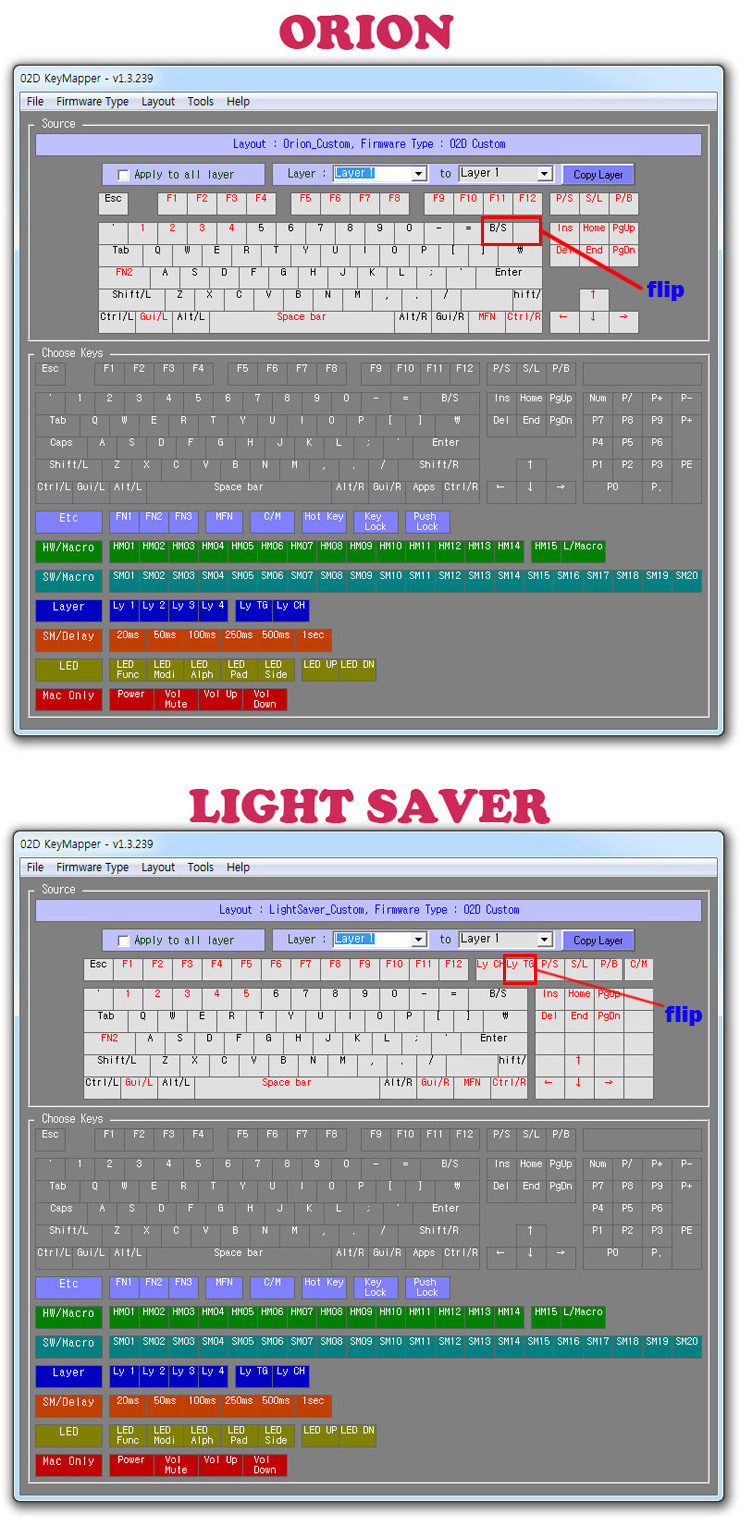

I'm trying my hand at programming my Orion at the moment... but I am failing hard. And since the Lightsaver uses the same software I thought I'd ask here.
Using the O2D keymapper I figured out where the flip key is but I have been unable to do any programming. Seriously no idea how.
I believe TrueCustom was working on a proper translation?
basic steps when i did it on my eagle / viper:
1. make your layout in 02D and save a hex file (windows region needs to be set to Korean to program arrows and some led functions)
2. hold down the flip or bootloader key while you plug in your keyboard (keys will not function if correctly in bootloader mode)
3. go into device manager and find your keyboard (will have an exclamation mark) and update the driver. (the driver should be in your one of your flip or other avr folders. if there's no devices that need drivers you might already have it installed but make sure you look around)
4. open flip, File - Load HEX File (load the one you created)
5. Select Target Device (ATmega32u4), Select a Communication Medium (usb) *if it can't find the kb, you didn't do step 3 correctly*
6. make sure everything is checked in the Operations Flow and click Run (if flip gets stuck after Blank Check and doesn't program, you might need to reload the hex file, this part is clumsy. play order until it works)
7. after programming is successful, make sure the Reset box in the bottom right is checked and hit Start Application to reboot your kb
everything should be good to go after that.
good luck!
This is great advice, I have all this working now on my Lightsaver. I am having problems with the arrow keys though. The 02D software shows the arrow cluster as "?", and I don't think it's mapping the right codes to the keys. Not sure what I am doing :(

Change your region on the pc to korea then restart and it should fix that.
I've had three lightsavers go through me and each time I've had to do that to reprogram the arrow keys.

Thank you...
the place I eventually needed to set this was in the System Locale (Control Panel -> Region and Language -> Administrative tab -> Language for non-Unicode Programs -> Change system locale). It all works now...
Here's some pictures of my board so I can stay on topic:

Well one issue I have, is the arrow keys when using the mapping program:
http://duck0113.tistory.com/84
All show up as "?" Instead of "Up", "Left", etc.
http://i.imgur.com/8GuNqDa.png
« Last Edit: Mon, 11 January 2016, 14:50:33 by limitz »
Mmm... machined aluminum
Re: LightSaver V2 Group Buy
« Reply #1128 on: Mon, 11 January 2016, 14:50:03 »
http://i.imgur.com/UXfX8T1.png
localize your PC to Korea (not the language the localization)
You can change it back after setting the arrows.
I had this problem, which Sifo helped with. Change your system locale to Korean,  this fixes the problem.

Great, that question is resolved. Another question on the keymapper:
What do "T/L",  "C/M", "MFN", Ly CH, Hot Key, and Key Lock mean?
Is there documentation on this anywhere? I searched and did not find it.
« Reply #1132 on: Mon, 11 January 2016, 15:13:57 »
Check the post your Lightsaver thread in media, photoelectric did some documentation on it
