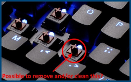

I have a new Max Keyboard Blackbird mechanical keyboard with Cherry MX Blue keys. I have having a slight "issue" with one of the keys...
The "F" key for some reason doesn't sound the same as all the other keys. It's not as clicky. When I depress any other key it sounds like a Cherry MX blue key should sound, however, when I press the "F" key its quiet and feels smooth. I don't know if this is how the keyboard came or perhaps I got something inside the switch.
I was wondering, is it possible for me to clean/fix the key so that it sounds like the rest of the keys? Do I have to remove the little square piece of plastic that moves up and down when I press the key and clean it?

Re: Possible To Remove And/Or Clean A Cherry MX Switch?
« Reply #5 on: Wed, 29 October 2014, 16:50:58 »
Erm, that photo shows Cherry MX brown switches.
None of them should sound like MX blues!
I just hope that he actually has blues now :p
Lol, I DO have blues. That's just an image I found on Google. :)
