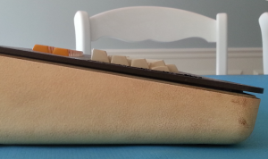

You’re answering a different question, which while interesting, is not entirely relevant IMO. There are 2–3 other recent threads about the subject of keycap angles, but while we’re talking about it here, this is what I want to see:
Where the purple is DCS, and the black is my desired profile (largish spherical tops would be great, but I think cylindrical tops are also fine). Unfortunately nothing close to that currently exists.

I guess we agree more than I thought. Standard caps are definitely usable on a flat angled board, but I don't particularly like how they feel after trying a profile based on a "flat" home row and I think they're one reason I initially had difficulty deciding on a keyboard angle in the past. Tilted felt better in terms of keycap top angle, but flatter felt better in terms of finger movement, although I didn't yet know at the time the reasons both felt somehow subtly wrong.
I'd give that profile you're proposing a try if it existed :) I particularly like that Z-row angle.
