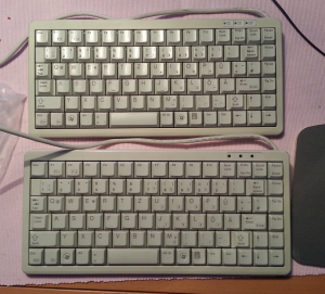

My G84-4100 boards (victims, muahaha!) have arrived and I've stripped one of them down and desoldered some switches.

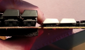

A quick height comparison of MX switches with GMK Cherry profile keycaps and ML with stock keycaps:
87827-1

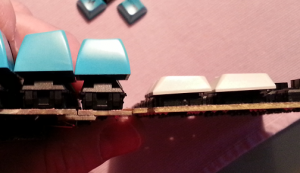

And with contoured SA profile caps on the MX:
87829-2
As you can see, Cherry MX with contoured SA profile caps is... very tall. I love how they feel, though, and if compactness weren't so important a criteria for this concept I'd definitely be using those.
