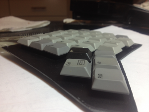

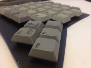

I was off a couple of thousands on the placement of the hole in the shell for the usb receptacle to fit into, so I made a trim piece to hide the misalignment.
90828-0
I decided to use a detachable cable so I could swap them for different uses.
90830-1
I am using standard size USB plugs. In spite of the higher cycle life of the mini and micro plugs, I went with the standard size because my somewhat numb and clumsy fingers can handle them better. Also, I broke protocol by going  with A to A cable plugs.
90832-2
There's still a lot to do. It's been quite a learning experience.

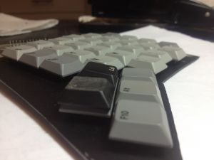

When I began soldering up the switches I discovered I made a major blunder in my design. I placed the SMD pads on the top of the PCB in the way of the switches. I got confused by all of the reverse thinking necessary when making the reverse image transfers. I decided to hack it together with through hole diodes. The change required drilling a lot of holes, some accidentally cut through traces on the other side, trimming away copper in areas to avoid shorts and repairing all of the damage. Not a pretty sight. I also put the IO expander in backwards. I decided it best to get it together and working then make new boards hopefully benefitting from my mistakes.
90840-0
Also visible is the USB receptacle soldered to the PCB. I was wondering how I would attach it and it worked out well. It is in a good location and is rock solid.

One problem I had to resolve on this project was how to create a contoured thumb cluster without either splitting the pcb at the thumb transition or remaking all the keycaps. This is how I'm addressing the problem.
Because of the 3 dimensional aspect of my keyboard the thumb cluster has to bend slightly out of plane from the alpha cluster. I found that the PCB will bend slightly without any ill effects to change the plane about 9 degrees. It just needs to have some well placed supports.
The second issue has to do with easily accessing the upper thumb switches without accidentally hitting the lower ones.
As you can see, the stock ML caps are all the same profile
91869-0
Interestingly enough, if the stems are broken off a cap, it will fit nicely on one of its fellows, raising it to a good height in relation to the lower row.
91871-1
By rotating it 180 degrees, its profile is further improved. This placement feels really good making all 5 thumb keys very accessible.
91873-2
This comparison shows the contrasting profiles. The one cap is rough because I began sanding it to remove the legend impression.
91875-3
