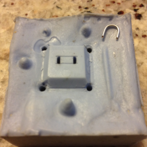

I mentioned earlier that I was having trouble with broken stems. Some of you offered good solutions but I came up with something that was free and readily available to strengthen the stems.
Notice the trimmed paper clip in the corner of the mold.
95259-0
It fits nicely in the stem recesses in the mold.

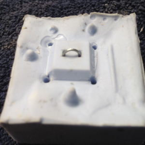

95261-1
Here it is in the keycap. These are really tough stems! I tried to pulling one apart with pliers and couldn't break it without completely destroying the entire cap.

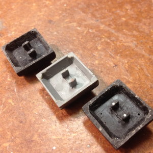

95263-2
Here they are nestled in the keyboard. They are pretty rough looking compared to the caps I made for the PortaPlop. I was more concerned with getting something in place so I could move on . I'm going to remake the mold soon but first things first.
95265-3

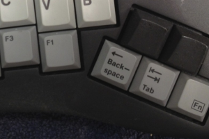

Thanks. I hope so too.  It is all about size. This picture pretty much sums up why I decided to gamble on the ML's
95368-0
As promised, here are a couple of pic's of the caps.
The first shows the height of the lower (original) caps in relation to the height and profile of the upper (modified) caps.
95370-1
The second is of the 2 caps I glued together then filled the side gaps to make the master for the upper thumb caps. Conveniently, the 2 caps were different colors. You can see how I over sanded the top profile to try to get the best feel. Unfortunately, where I burned through left enough of a line to be noticeable in the casts. Today I applied resin over the cap and will resand, trying to avoid burning completely through the resin. I will then remake the molds which had other problems I needed to address as well.

The standard 24mm Sanwa arcade switch is a full 1" from the face of the keyboard case to the back of the switch; Actually, 1 1/4" including the terminals. I've disassembled the switch from the housing in this photo.
95752-0
I cut a donor board's PCB around a ML switch. I left a little extra PCB on the sides for mounting into the Sanwa housing.
95754-1
Inside the housing there's a rectangular hole that looks like it was made for the ML.
95756-2
 By trimming a little notch in the bottom of the housing where the PCB would fit, the PCB section snaps right into the Sanwa housing! Depth is reduced to 5/8". The switch feels great and no hot glue. Total time of conversion– 3 minutes. I still need to check the range of the plunger to make sure a hard strike doesn't push the ML out of its home and if necessary, put some kind of limiter on the plunger.
 95758-3
The white switches are just for experimenting, I will use black ones in the Plop.

While on the subject of arcade switches, I thought I'd share something I tried but decided against.
I turned a switch housing out of aluminum. When I fitted it into the Plop I realized something just didn't look right but I couldn't put my finger on what. It came to me this evening. It reminds me of the cigarette lighter in the Old Man's '62 Chrysler.
