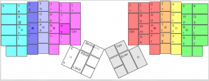

Just for fun, I made a heat map of the YOR UIAN keyboard using the Collected Works of Mark Twain (courtesy of Project Gutenberg)
106660-0
Not too bad, really.  :D
