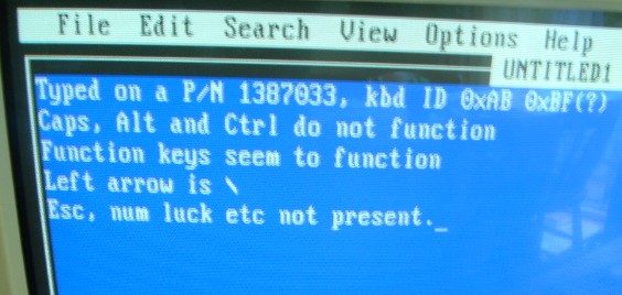

¹ Could not reach the grub command prompt due to lack of escape key for
complete character testing, however single keys command for the grub menu
functioned successfully.
² No response at all from any keypresses.
³ Ctrl, Alt and Caps Lock keys did not seem to function, though this may
be due only to layout / scan code differences.  Alphanumeric, shift and
function keys functioned as US 84 key AT.

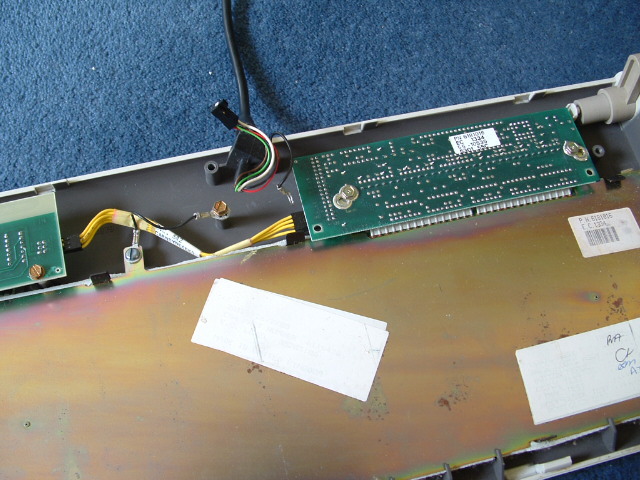

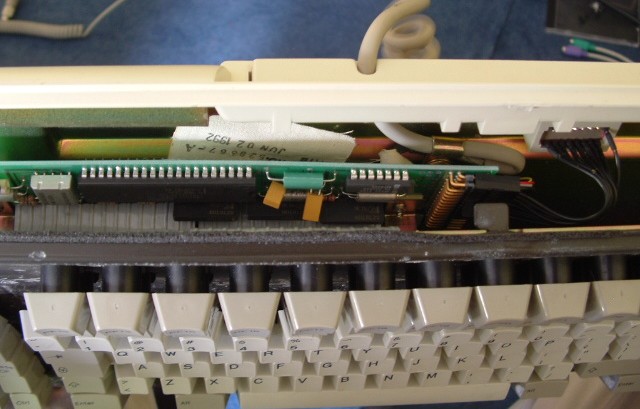

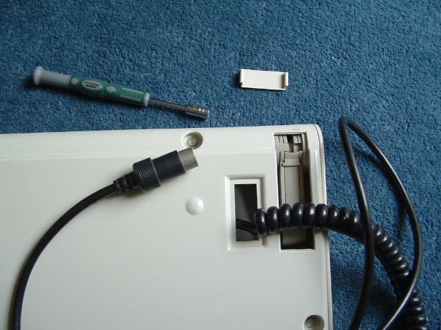

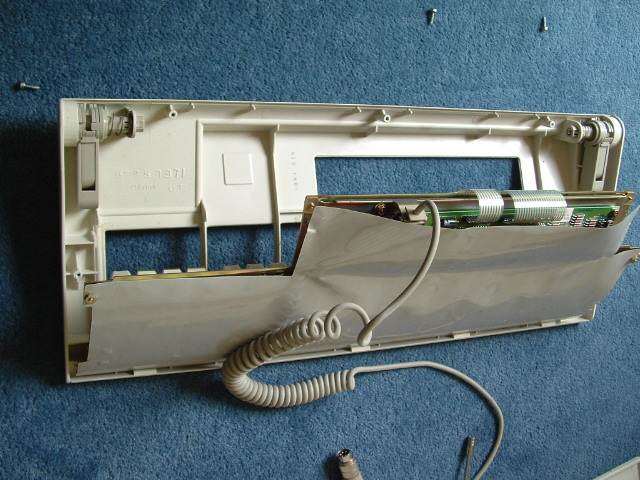

I took some pics, mostly useless but at the very least serve as a personal reminder.
A source of jumpers...
Cable detached from the 6540225
Opening the 1389260

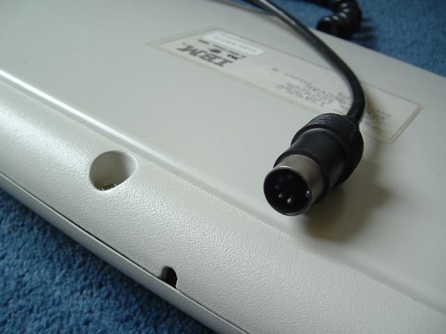

The AT's cable isn't going to fit through the cable hole on the 1389260...
...so I ran it through the blanked hole for the DIP switches.

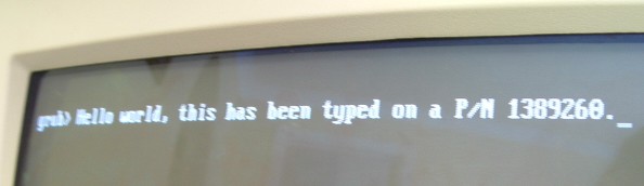

1389260 okay at grub prompt...

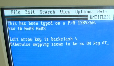

..and in DOS EDIT.COM.
The chassis of the 1387033 is riveted...

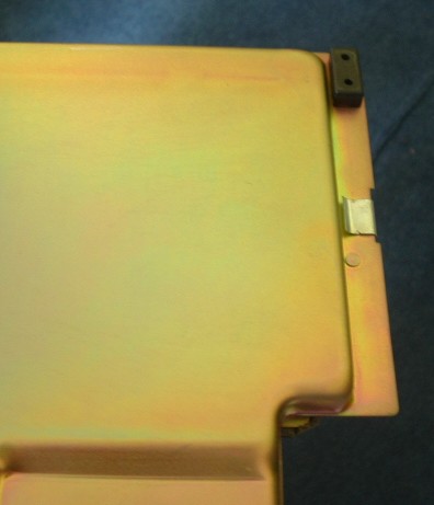

...check the other side to be sure...

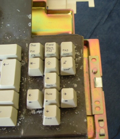

...so the PCB is effectively stuck, making the Berg strip difficult to reach.
1387033 in EDIT.COM

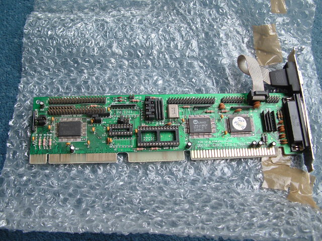

Yay, someone still has a VLB card out there.
I was kindly offered that by a chap who sold me some 5¼" floppies.  I hope to be able to put it to its intended use some day...
If you need a VLB motherboard, I have one somewhere. Last I tried I couldn't get the jumpers set right, tricky to find info for, but I'll tell ya what...it's yours for the cost of shipping if you want it.

Unrelated to terminal boards and win95:
My 1993 USA-built 1391401 has drainage channels and holes. It was not made by Lexmark. I've read some things floating around the forum which suggest drainage holes and channels were a Lexmark-introduced idea...but then why doesn't my keyboard say Lexmark?
My 1993 Mexican-built 1391401 has drainage channels but is in a case without holes (the bottom part of the channels were sliced off, apparently), and has a Lexmark sticker on the PCB. What gives?

Quote from: ripster;110506
1993 seems to be the year IBM decided to add drainage channels and holes to the Model M.  I also have a 1391401 with them.
Awesome, so I have just the right year then...my USA unit is still pre-Lexmark but has drainage channels. I don't plan to use them, of course, but I've been seriously tempted to pour a cup of water on it ever since discovering them...
The Mexican one not having holes is weird - I saw one with channels AND holes on clickykeyboards.
I called Unicomp before I got my 1386887s and asked if they had any info (I spoke with Jim, apparently that name is known around here)...he could find info on almost every terminal board there was but 1386887 was not in the list of part numbers (no record of it even existing, according to the documentation that got passed down to Unicomp).
During that call, I asked if there was anything special about Mexican Ms, and was told there wasn't...but that he believed the majority of units stamped as being from Mexico were probably factory refurbished since the bulk of the manufacturing was in the US.
The guts of my Mexican model M have a Lexmark sticker on them, but also a date indicating 1993 somewhere, I forget exactly what. I wonder if my unit was factory refurbished and they had to modify the guts to fit in the case because a case with holes was not available (keep in mind case itself is dated 1993 as well, so it would have to be pre-drainage-holes-introduction unless a new sticker was put on it).
Then again, it could be the school board who owned it before me, but I can't see why they would have done that.

Quote from: ripster;110516
Here's the link to the Mexican one.
Frankly, I find the Unicomp guys tend to talk down those "furriner" boards.  The one in the link looked mighty pretty to me.
At the point of bringing it up, he did kind of sound like "well why the hell would you care about those, just buy one from us" by his tone (did NOT say that directly and that is how I interpreted his tone; he easily could have not meant it that way).
Nice keyboard, nice nice. It doesn't look like the drainage channel design allows for very much liquid to be spilled all at the same time...let's say you slowly poured a cup of water on it, it would be fine...but if you just outright dumped it on it (as would happen if you knocked over a drink on your desk), it seems the water would come up and over the plastic tubes the keys fit in.
