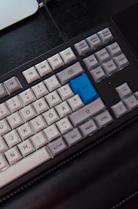

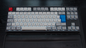

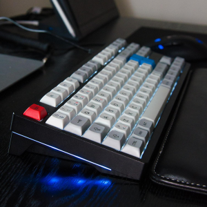

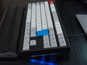

Well, it took a lot longer than I hoped, but here it is.
In fitting with the celestial theme I am calling this build "red shift".  Reds with red o-rings (maybe ill drop these), to match the red top case and PCB.  Currently using Cherry98s from PBT4.

« Reply #1697 on: Sun, 27 March 2016, 08:07:31 »
My first Korean custom board. Actually my first build ever. I would be lying if I said it was easy. Although I must say that this board was perfect for a first build. Expensive, but still a good learning experience. Initially a community member was going to build it for me as I was too much of a **** doing it myself, but he went MIA. So I ended up doing it myself. Took me several weeks due to work, family commitments, buying tools etc.
While desoldering my F9 key I managed to break a trace which really bummed me out...  :( Fortunately I was able to ghetto-wire it and now it is completely functional. As a first time build and first time solder I should have gone with Cherry switches. R1 Zealios were really troublesome. About 15 switches were chattering. Some so bad it was not good for typing at all. In the process of replacing them the PCB suffered some minor superficial scratches and dents. They are hard to spot with the naked eye, but knowing they are there kinda irritates me being a perfectionist. Fortunately the PCB is hidden and they kind of only exists in my mind. I do have to admit that the problems with Zealio switches really is a result of soldering inexperience as I did know of the low melting temperature of the switch housing. Next board will be Cherry MX, just to avoid having to desolder so many switches again.
Initially I wanted to put my Retro SA set on the Orion, but found the keys to wobble way to much. Another result of using Zealio switches. It is a matter of taste as other community members have no problems with Zealios + SA keycaps. Due to this I had to divert from my initial design and installed my Granite set. The key-wobbling is now gone and the typing experience much more pleasant.
The setup is not completely finished. I am still waiting on a custom USB-cable and some other colored LEDs to spice things up. One last issue I have is the mushy space bar as others have reported. I really hope that issue will just resolve by itself as can't be bothered with more deslodering and assembly. If anyone has any suggestions on improving the feel of the space bar without desoldering, please do let me know.  :)
I apologize if this post sounds complaining/ranting, not my intention. Just want to share my personal experience. Putting that aside I have to say the board is awsome! It is built like a tank, has tons of features and looks hella good. I am so glad I also ordered the angled acrylic bottom. Since I ended soldering it myself, I really should have ordered an extra PCB.
132436-0
132438-1
132440-2
132442-3
Any comments and suggestions are as always greatly appreciated. Cheers!
« Last Edit: Sun, 27 March 2016, 08:16:31 by ctrlX »

can anyone explain the difference in feel between the 3 plates? Does the acrylic plate have less of a 'ping'?
If you're familiar with pcb mount or gons polycarbonate plate I would say it reminds me of those. Probably closer to the former actually. I opted for plastic over aluminum and steel for my board.
After typing on plastic for a while I thought I'd give the aluminum a longer test run and I still miss the gentle feel plastic gives over the metal plates.  I WILL COME BACK TO THE PLASTIC WHEN MY ZEALIOS COME IN.
For what it's worth, I hated Zealios on acrylic. I'm typing on Zealios/alu plate now and it's a much more enjoyable experience. I do like the feel of scratchy cherry switches on acrylic, though. Maybe I'm just weird.
