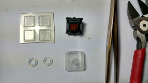

Like I mentioned previously, I want to reduce travel, both before and after actuation. I also want quiet keys. I realised that the easiest way to do this is to start with the plunger in a slightly lower position, and prevent it clacking against the housing. Here's how I went about it.
What you'll need:
- a brown switch (though doesn't have to be brown - any type will do, though you'll need ghetto brown mod for blue and green switches)
- a keycap
- silicon pads (like those used on the feet of furnishings for grip and ground protection
- an o-ring or two.

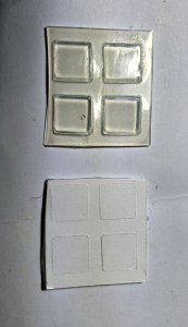

97300-0
Silicon pads have adhesive backing:
97302-1

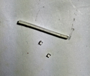

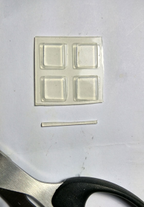

We don't actually need anything near this size though, and the pads themselves are too thick. We actually only need a sliver:
97304-2
Of which we only need a tiny rectangle's worth:
97306-3

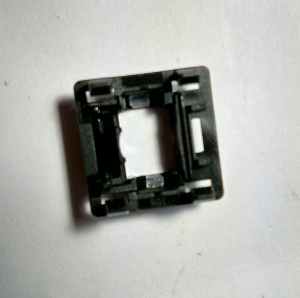

Then we use tweezers to remove backing and stick at top of upper housing slider grooves:
97308-4

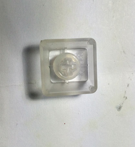

Once you've done that reassemble the switch. Chuck an o-ring or two (I prefer two for much reduced travel) on the keycap:
97310-5

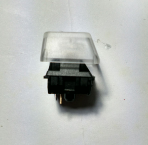

And there's your finished switch. Terrible photo here, but you can just about make out the two o-rings through the keycap:
97312-6
The silicon pads in the housing push the plunger down about a milimetere causing it to actuate about as early as a jailhouse blue, without having to rig the blue plunger. They also prevent the sound from the plunger coming back up against the housing.
O-rings on the keycap serve to prevent cap hitting plate and reduce travel. Overall effect is almost no sound.
