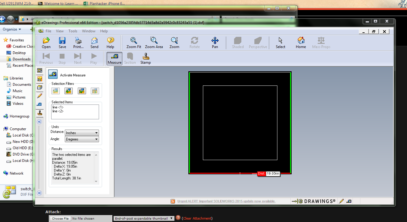

Hi Everyone,
I'm currently looking into the process of building my first Keyboard and i cam across Swills plate builder (SO AWESOME!), but when i downloaded the dxf and i opened it into solidworks e drawings and measured the distance of the cut out it was saying that it was 19.05inches not MM is there a glitch in the program or am i just doing something wrong?
Oh and i plan to make it with Gateron switches from mass drop last week but still deciding on the caps as i don't know the layout just yet, (andim trying to make it as cheap as possible really ) ill post my Build guide when i do it!!
i have attached an image of it :)
thanks in advance!!

Re: Using Swill's Plate builder !
« Reply #1 on: Tue, 05 May 2015, 22:31:06 »
as i recall it outputs without the units and most programs assume it is inches by default rather then millimeters I think there was a post telling people how to change that after they download it as I recall
« Reply #2 on: Tue, 05 May 2015, 22:31:45 »
Yeah you have to default your units.

« Reply #3 on: Tue, 05 May 2015, 23:57:34 »
like before i open the file? humm ok ill take a look in the preferences
thanks ill let you know how it goes!
« Reply #4 on: Wed, 06 May 2015, 00:55:43 »
tools -> options -> document options(tab) -> units
change it to MMGS
« Reply #5 on: Sat, 20 June 2015, 06:43:59 »
Hey guys sorry to bring this up again. but i have tried and no luck it still give me the wrong units any other suggestions?
