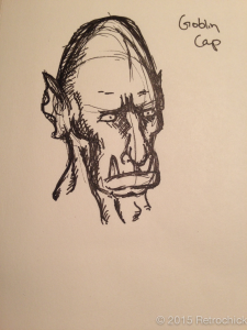

Hello everyone!
Curiosity got the better of me and I've decided to try my hand at keycap making. I've seen a lot of great work crop up recently and felt really inspired by some of the artisans on here (namely Bro, Binge, Booper, and Whizzard) and plus, I wanted to learn a few things about sculpting, mold-making, and resin casting. Additionally, there is a wealth of information on here about how to best go about making keycaps, so I figured I'd give it a shot.
I have a lifetime love of drawing and sketching, so I figured I would also enjoy sculpting. It's a medium I've never really explored, however there is always a first for everything!
I drew up a few keycap inspirations and ordered some Super Sculpey and some tools. As I await some thick blank pbts from Singapore (thanks Gutz!), I decided to prototype out one of my keycap designs. I've found that I tend to prefer harder clays - Super Sculpey gives a nice range of flexibility when it comes to malleability: it warms up and softens nicely, however it can also harden up a bit and still allow you to sculpt the finer details. It's extremely versatile and I like that I can go back and refine the design with no 'hard-stop.' This is especially important in the first design/prototype phase.
Here is my initial design of a keycap:
105903-0

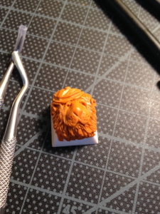

I've always loved the idea of a fantasy figure keycap and am a sucker for all things weird/strange. I have a few other ideas along similar veins that I'm looking to explore as well.  :eek:
I also enjoy sculpting more lifelike/humanoid forms because they are easily relatable. I'd like introduce Goyle, my goblin to everyone:
105911-1
105905-2
105907-3
105909-4
I am about 70% satisfied with how he came out (I decided to forgo the conehead) - there are still lots of adjustments to be made (ears, nose, etc), however I wanted to share and document my progress. Once the keycaps arrive I'll proceed to adapt Goyle to his keycap base and I'm sure there will need to be adjustments to accomodate the form of the keycap. I just wanted to get an overall undestanding of sculpting something and how to treat a 3d object as opposed to a 2d object. You have to consider each and every angle and make sure it looks acceptable. I think that's the hardest part - adapting my designs to multiple perspectives.

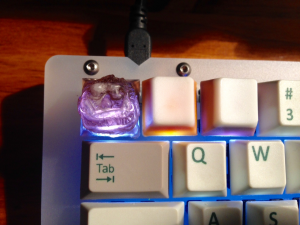

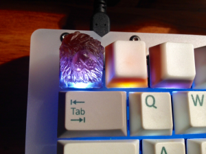

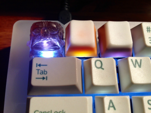

Casted some caps! Crappy potato pics below:
Sharpei Béret
113587-7
Frank N Cap
113589-8
Cold Yeti
113591-9

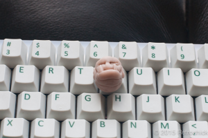

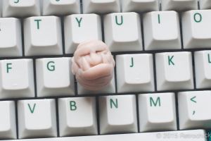

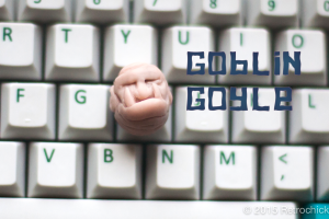

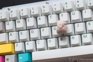

Goyle the goblin got put on a keycap! It took me 3 tries before I was finally happy with this reincarnation of him. I must say, having the model master totally helped and served as a style guide for how I wanted him to look. My first two tries were 1) too low profile and 2) too high profile. The third try was too small to fit on the keycap and details were lost. This latest try is a bit better. I was able to stretch his features out a bit on the keycap base.
106160-0106162-1106164-2106166-3106168-4106170-5106172-6
Still need to test fitment (whether or not the ears will interfere with the other neighboring keycaps), and needs some more refinement.
Progress it's getting there.  :))
In other news I'll probably drive down to Harbor Freight this weekend and get some pressure pot/vacuum supplies.  :eek:

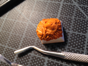

In other news, I ran into some fitment issues with my latest sculpt, so I went back to the drawing board on how to best translate my goblin onto a keycap. The latest prototype was too big, as his ears and neck fat were interfering with neighboring keycaps. So, I've gone with this design which does not interfere with the other neighboring keycaps:
106398-0
106400-1
106402-2
106404-3 some details of the forehead
106406-4 here you can see it next to the last prototype
The sizing is much better, and I feel pretty good about where the keycap is finally headed.
I think I've reached (from a design standpoint) a happy compromise between staying true to the original concept while making adjustments to make it fit properly on a keycap. I have to work with the keycap, not against it.
I did have one question that I'm hoping some fellow makers can answer:
What's the purpose of partially filling in the bottom of the keycap where the stem is? Is it for structural purposes to make the keycap more stable?
Also, yes, I do have small hands and they totally come in handy when it comes to sculpting tiny things! (Bad joke, sorry folks)  ^-^
Yes you have it, helps with stability.  It also gives the key a little more weight and feels more well made and less flimsy.  You also don't want the stem too long or it might break or warp.  That's why I make sure to have a nice little fill anyhow.
And I see you ran into the old clearance problem.  Looks like you dealt with it pretty well.  Not easy when you are molding on top of a cap... is that what your doing?  Because you cant really use the little bit of space that is vacant on the inside part of the cap.  If you look at my angry cap, you can see how I tried using the clearance problem to my advantage by working inwards instead of outwards.   You don't really notice it much with the naked eye, but you can get away with a lot more stuff on the top of the key than you can on the bottom.  Unless you work in like I said earlier, the bottom 1/4 or so can't be built on barely at all or it will rub with it's neighbor and have clearance issues.
Here is a pic of my second sculpt.. it was "Biggie Smalls".  I snapped a pic next to a standard keycap for scale so u see what I mean.  I loved it, but had to scrap it immediately as I was so far off on clearance (being new) that it was basically un-recoverable.  Yep so keep clearance in mind and try to use it to your advantage .... keep it up  :thumb:
Fail:
Re: Retro's Hand-crafted Keycaps Adventure!
« Reply #18 on: Fri, 24 July 2015, 20:31:41 »
Hint 1:  If you're worried about clearance, sand the sides of the caps down.  GMK and Cherry caps give you more room on the outside after sanding than SP caps do.
Hint 2:  Painting the inside of the stem prior to making your mold helps significantly with fitment.
Word of advice:  If you do buy a pressure pot, avoid Harbor Freight and get something legit.

I was able to cast some keycaps last night. To keep everyone updated, I made some topre fn & esc molds. The casts from these molds came out better than the goblin mold - I'm still getting big bubbles and the stem part of the mold is still really fragile. Anywho, here are some pics of a set that I deem 'acceptable b-stock' from a hand-cast/pour:
107848-0
107850-1
As you can see, lots of air bubbles. I don't think I'll be able to cast these perfectly without a pressure pot. I'll need to get that set up asap. If anyone is feeling bored, feel free to send me your set up technical notes. I'm converting a used pressure paint pot.

Good news: got a decent cast of goblin Goyle.
Bad news: ruined my bottom mold, again. Because the pesky stem part stuck to the resin when trying to extract it. Okay, who has tips for this? Should I do some sort of modification? It's so annoying having to recast that stem part of the mold...  :mad:
Here's some pics:
107889-0
107891-1
107893-2
107895-3
107897-4
I see a lot of bubbles - but not too bad for something done sans pressure. I'll probably start focusing on getting the proper set up before doing more casts. Also, stay tuned for goblin v2!  :eek:
I'm envious.
The top part looks pretty solid. There may be some air bubbles at the bottom but you pretty much got the base worked out. Have you tried using heat with your resins to lift the bubbles?
Sorry for the noob question since i really am one in this area  :(
Thanks! No I haven't tried using heat - what method would you suggest to get rid of the bubbles? Something like an oven?

For the stem, it would help a lot I think if you use a releasing agent on the stems so it won't stick to the resin since that part is small and tricky. Might want to give it a try. (you can apply a thin layer of petroleum jelly just on the stem)
For the heat, when I watched the tutorials in youtube of resin charms, using a lighter near the resin actually raises the bubbles upward and pops them (or you can pop it using a toothpick). As far as I know resin isn't really flammable so holding it close should be okay. Just make sure not to burn your mold though.
I hope it helps!

Thanks Meika and whizzard for the advice! I will get mold release for sure. And as for Epoxy putty, you've convinced me and I'll give it a shot!  :thumb: :thumb: I'll probably also switch my resin as alumnite + colorant doesn't harden as much as I would like. And thanks for the words of encouragement! I'll post the 'duds' as well on this thread - those keycaps were the ones that came out halfway decent but I think it's also important to show and learn from our failures.
Here's some pics of the topre keycaps on my HHKB:
