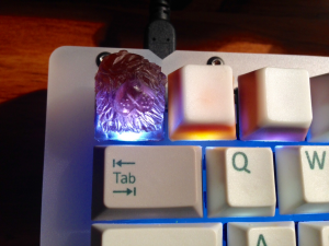

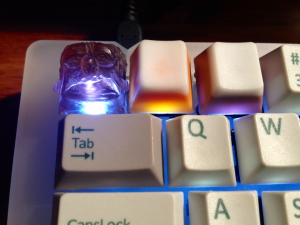

Offline retrochick
  • Posts: 600
  • goodbye my wallet
Re: [Update 9-13-15 New Kecayp Design!]Retro's Hand-crafted Keycaps Adventure!
« Reply #64 on: Sat, 26 September 2015, 12:19:16 »
More updates y'all. Went crazy sculpting. A few caps made so far. Not sure if I'll cast them, but it's fun to experiment!
1. Cold Yeti
He has a scarf because he gets cold all the time.
111995-0111997-1111999-2
2. Frankencap
Work in progress. In celebration of Haloween, I decided to do a fun sculpt of the classic.
112001-3112003-4112005-5

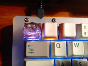

Huehuehue
112477-0
Offline Zorberema
  • Posts: 175
  • IG: @ZorbCaps
Re: [Update 9-26-15 New Kecayps!]Retro's Hand-crafted Keycaps Adventure!
« Reply #71 on: Fri, 02 October 2015, 12:12:57 »
Huehuehue
Looking good! Really love that you put the screws in there; gave a really great touch to the overall design! :)

The screws are are perfect. This cap looks incredible.
Frank's in the pressure chamber now along with his friends for a mold treatment.
I really am in awe of your sculpting ability.
Thanks! I'm in awe of your resin casting ability and that homemade doubleshot mold....wow. so good.  :thumb:

Thank you for your patience. You've waited long enough. Here are the products of my very first casts with a pressure pot. Detailed notes below:
Casting silicone under pressure is one of the best ways to prevent air bubbles in your mold that will come out as 'pimples' in your cast. I'm slowly learning that if your mold isn't perfect, your casts won't be either. So, as it goes, the going is slow. There are some major adjustments to be made, but I feel like I've made some good progress.
Sharpei Béret
113593-0
Major air bubbles underneath the keycap (thankfully the stem turned out fine, just where the sprues are located). I have an idea about how to modify my mold to allow for the air bubbles to release. It involves recasting the bottom portion of the mold. Ah well.
Cold Yeti
113595-1
Major air bubbles got trapped where his brows, eyes, and fangs are. Not sure what happened here so I'll have to try again and hope it was a fluke.
Frank N Cap
113597-2
Same as Sharpei, I got major air bubbles on the underside of the cap. I will apply the same modifications to Frank's mold and report my findings.
The resin is dyed purple and looks bubble-free, so that's encouraging.
Overall I'm hopeful that if I can make the appropriate modifications to my molds to produce bubble-free casts, I can start experimenting more with pigments and fillers.  :thumb:
