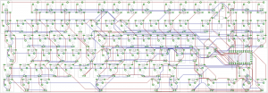

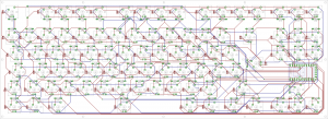

I'm switching from a plate mounted to a pcb mounted desing. This change is necessary due to the high cost of steel and aluminium laser cutting. The first step of the design change is an adaption of our PCB to sustain typing, plus some new optimizations.

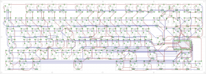

Thanks to the help of a friend of mine, my keyboard will probably have is own iso layout dual layer PCB with backlight LEDs support (not only on off but also on with a dimmer light). We are working hard to optimize it as much as possible!

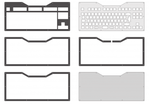

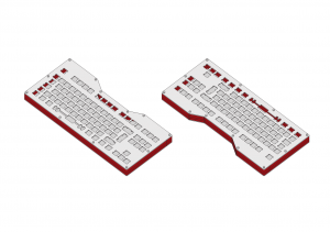

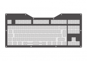

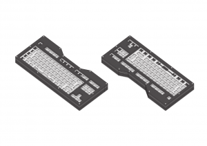

UPDATE 21 August 2015
I did a major overhaul of my enclosure design. While it isn't changed much aesthetically, now spacing is way more efficient and so the casing is overall smaller (370 mm x 165 mm) and more elegant.
109058-3109060-4

As promised, here it is a 3D render of the fully assembled keyboard (with front cover)
108860-0

Nice rendering! Did you draw everything from scratch? I'd like to design a case for my keyboard too. Don't know where to start from.
Is this all done with CorelDraw?
Offline mastercontrol90
  • Posts: 27
Re: My first custom keyboard design and maybe my first custom keyboard too
« Reply #7 on: Fri, 21 August 2015, 04:30:02 »
Except the mounting hole layout (taken almost straight from the phantom plate) it's all from scratch. Yes, I did all of this with CorelDraw + CorelDesigner except the fully assembled 3D render (latest image), which is made with maya by a friend of mine using my dxf file. By the way I saw your 30% prototype keyboard board and it is.... exotic... I LIKE IT A LOT!

No problem man! If I remember correctly kicad can export to different cad formats, including the common dxf (autocad), if you want you can just export it in this formant and send it to me. You can also try the Trial version of Corel Draw Technical Suite and measure it with it (or try the breeze of a vector/cad like software).

I'm convinced Kicad's dimensioning feature cannot measure anything between grid-dots =(.
I had to manually subtract coordinates to figure out the dimensions of the board. And it is 202mm by 80mm.
Attached is the SVG, although I am not sure if we can figure out the measurements from it? It doesn't look to have any numerical data?
And btw I realized I forgot to wire the Enter key to it's column. Rework is needed..
the svg file was almost perfect, there was some glitch here and here (I presume where there were some info text outside the pcb) but the pcb was perfect :P
I'm starting right know to work on it
Great! Like I said, please don't spend hours on making me a case! ANYTHING would be appreciated. If you can share the files with me, I can improve from there too! Thanks!
oh I need one simple thing, how big are the space key and the other key on the same row?
It's 1.25-6.25-1.25!
  • Posts: 27
« Reply #22 on: Sun, 23 August 2015, 03:49:37 »
Ok, thanks! I need those to put the stabilizer holes. While you are here, a part of the spacebar, there are other keys that need stabilizers?
Space is the only one.  Don't stay up too late bro!

Almost done, wait for it!!! BTW here is 11:15 am :D
Done!!! Check your keyboard topic!

Really appreciate you working on my case! So this is all possible with CorelDesigner and CorelDraw? I am gonna see if I can get my head wrapped around it too. This is exciting!

« Reply #27 on: Wed, 26 August 2015, 07:59:30 »
UPDATED, check the main post

just put standard 3mm LED in parallel with one common resistor to dim them on a 5 volt line
Regarding the layout, I'm from the old continent so... ISO all the way here :D
BTW, do you know any decent PCB producer/seller website? The lower cost one here costs to me 168€ for two pcbs

I got about 26€ X 10pcs for the pcbs and about 110€ for a mounting plate... I'm switching to a pcb mounted design to lower costs.
