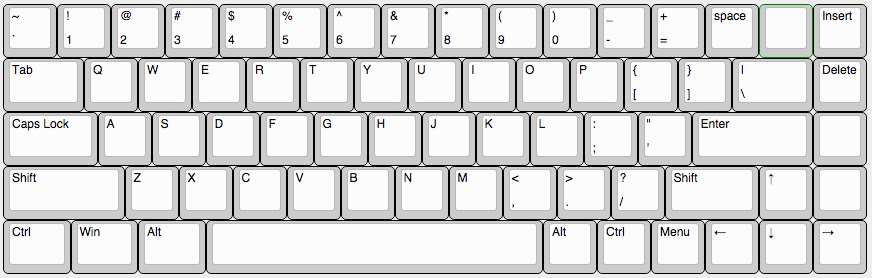

After a little flash of realization, I decided that I need a 65%. I've seen a couple options floating around out there, but nothing that quite tickles my fancy. I'm planning on getting a plate cut within the net week or two.
The layout:
110461-4
I've been trying to think of a new style of case design, but I haven't had any strokes of inspiration, so I'll probably go back to the routed wood case that I did for my last project (https://geekhack.org/index.php?topic=73452.0).
Comments? Criticism? Interest?

I'm a fan of the layout. I too have been in the market for a 65% board, so I'll be watching this one develop.

I like the layout. I've always thought 75% are a little awkward looking, this would fulfill my aesthetic needs much better.

Here's a screenshot of the file that I'm planning on getting cut at big blue saw, so let me know if you see any errors.
Taken from the swillkb builder and modified a bit.

Would recommend putting some mounting holes in the centre for increased stability, but it's probably not strictly necessary.

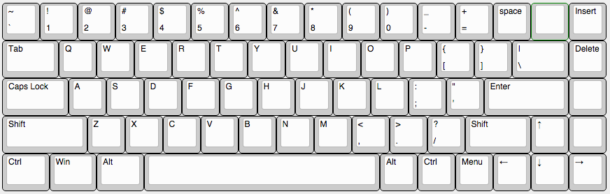

I hope to start this back up. I was able to further my design a little bit over the last week.
This is my first attempt with a layered design, so I'm trying to keep things simple. These are the files that I'll be sending out to Big blue saw tomorrow (Dec. 29).
121937-0
121939-1
The middle layer is going to be .354" clear acrylic, and I'm going to try out copper for the plates. It just sounds like a fun time.
The plates and middle layer will be held together by a bunch of machine screws that I'm going to counter sink by hand, and most likely have to heat up to get them to take in the acrylic without cracking it. Cause tapping is that **** I don't like.
I don't think I'll need any center supports, but ill probably get some spacers cut as well, just in case I feel like I need them.
I'm flying by the seat of my pants, so any help or input would be appreciated.
