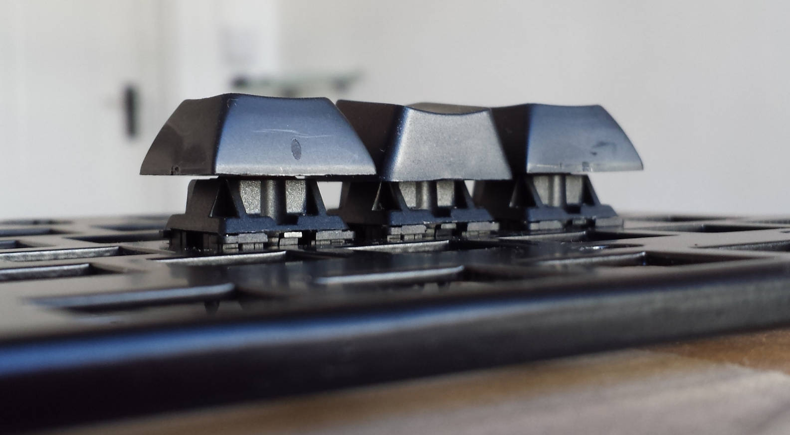

I received the DSA keycaps from Signature Plastics.
I put two of them on a random plate, with a DCS R2 to compare :
The DSA are wider and shorter by around 1mm. I will have to take this into account while designing the case.

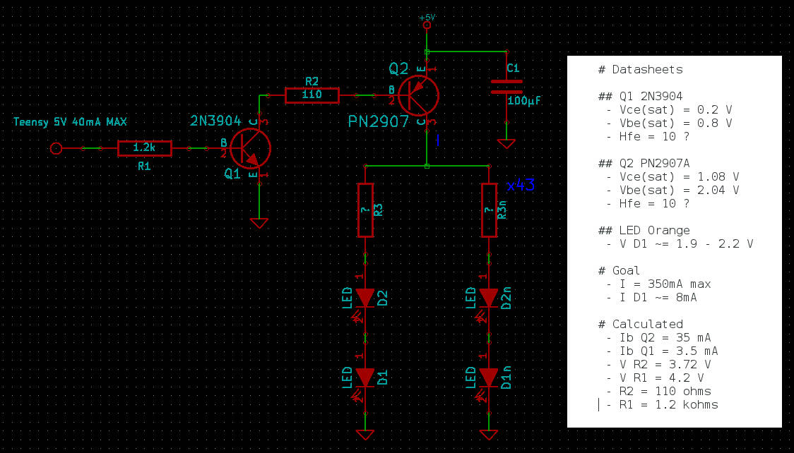

I have some issue with the design of the backlight. As I have 85 keys, I wanted to put 85 leds, one in every switch. By putting these leds in an array of 43 pairs of 2 leds in series, it should fit within the 500mA allowed the USB.
I plan to use a PNP on high side, to be able to use the ground plane and simplify the routing on the PCB.
Here is the schematic :
With let's say 8mA per pair of LED (which should be bright enough), that's 350mA for the whole array (x43). That good and leave ~150mA for the teensy and few other leds (num lock..).
But the LED are given for a voltage between 1.9 and 2.2 ... and Vce(sat) of Q2 is around 1.08V, so I may not have enough voltage to put leds in series 2 by 2. And putting all LEDs in parallel drive too much current.
Second issue, in my schematics, I have another 40mA lost by the transistors to switch Q2, that seems a lot. I could probably lower Ib Q2, but the gain of Q2 is not linear and is somewhere between 30 and 100... difficult to calculate something accurate... (See datasheet of PN2907).
Do you have some tips ?
Thanks,

After few month scratching my head, I discovered that the relationship between forward voltage and current of a LED is not linear when they are not used at their nominal power. I found a nice post explaining this stuff :
http://electronics.stackexchange.com/questions/76367/accounting-for-led-resistance
Basically, I'm somewhere on the corner of the curve :

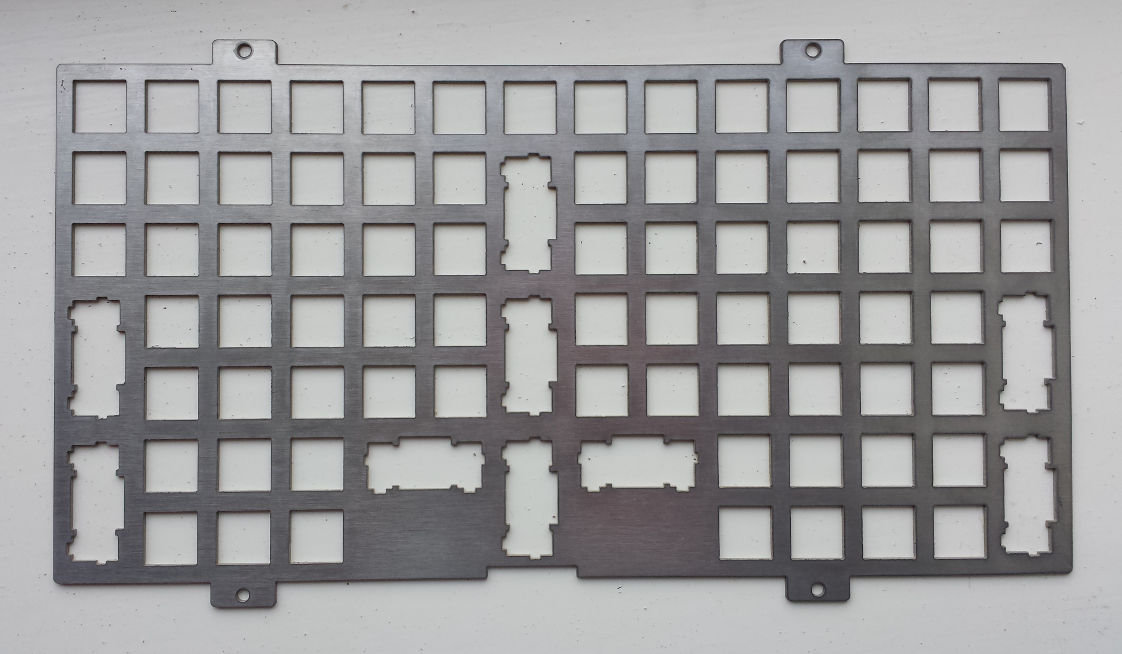

So dropping the calculator and going the old-school way with a bunch or resistors and a metrix on a breadboard is the best way to get the exact values...
And I received my new plates ! (Thanks Jack !)

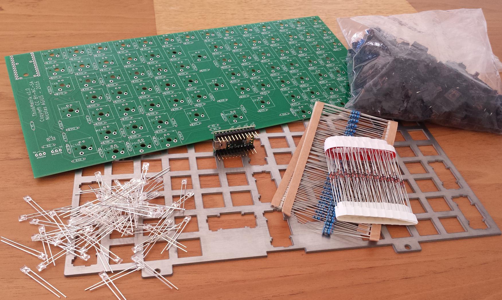

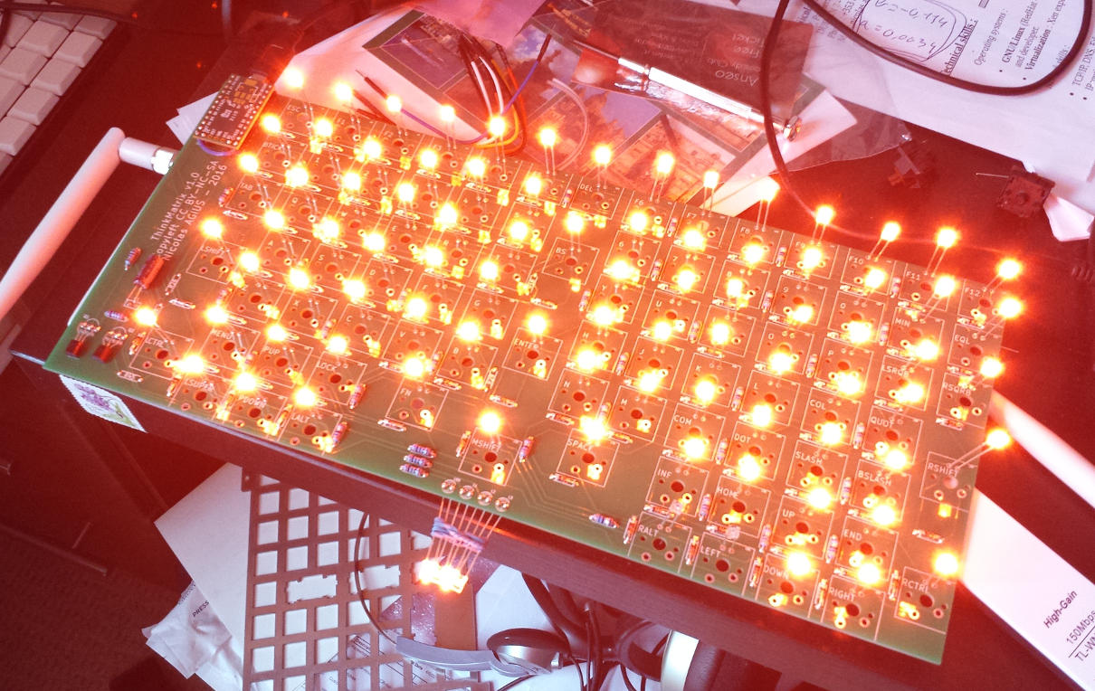

After a lot of work, I finally finished the design of the PCB. At 1.92V the leds draw only 7mA, so I was able to fit all 86 leds  with a total current below 300mA. I hope I didn’t make any mistake calculating the current through the transistors...
With 85 switches, 85 diodes, 89 leds and 48 resistors, the PCB is quite busy but everything fits. The ground plane was a bit tricky to do with all these tracks and putting the controller in a corner didn’t helps...
I received the PCB and all missing parts, it's time to soldier this !

« Reply #7 on: Tue, 12 July 2016, 14:13:00 »
Half way done :
I was a bit disappointed though as I discovered that I made two errors in this PCB.
First one, I put few resistors too close to the Cherry stabilizers and it just won't fit. I had to soldier them on the back side and review the inner size of my case as it make the whole board thicker.
Note for next time : make sure the clearance around the stabilizers is good enough. They are not symmetric !
Second one, the module I used in KiCad Eeshema has a wrong labeling on few pins which are swapped. I fixed this with a bunch of wire. Working but a bit ugly.
Note for next time : don't blindly trust files found on Internet, double check twice !

Backlight testing :
Woohoo ! It's working !
All my calculations with the transistors are correct :-)

Congrats!  Great choice of LED too, I think.  Not 100% sure they aren't red :))

Well, the LEDs are supposed to be orange, but it's a kind of dark orange ;-)

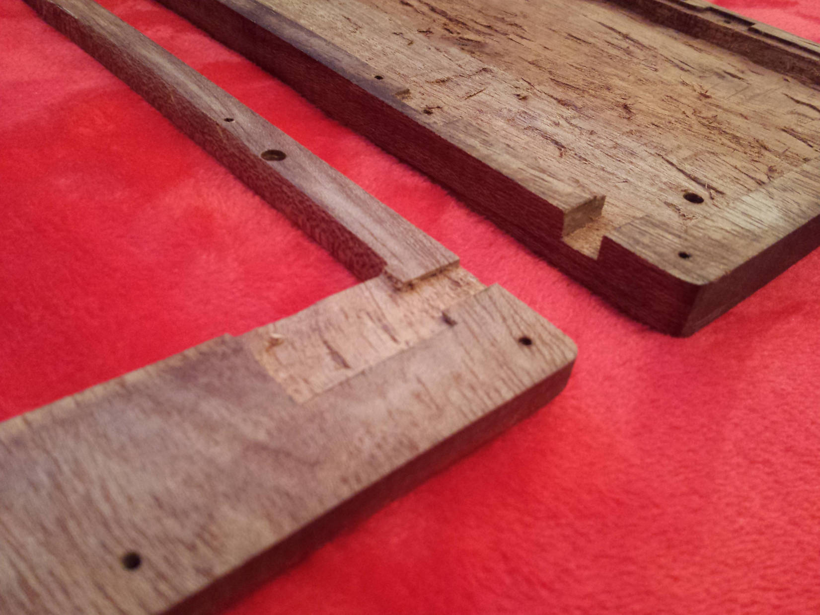

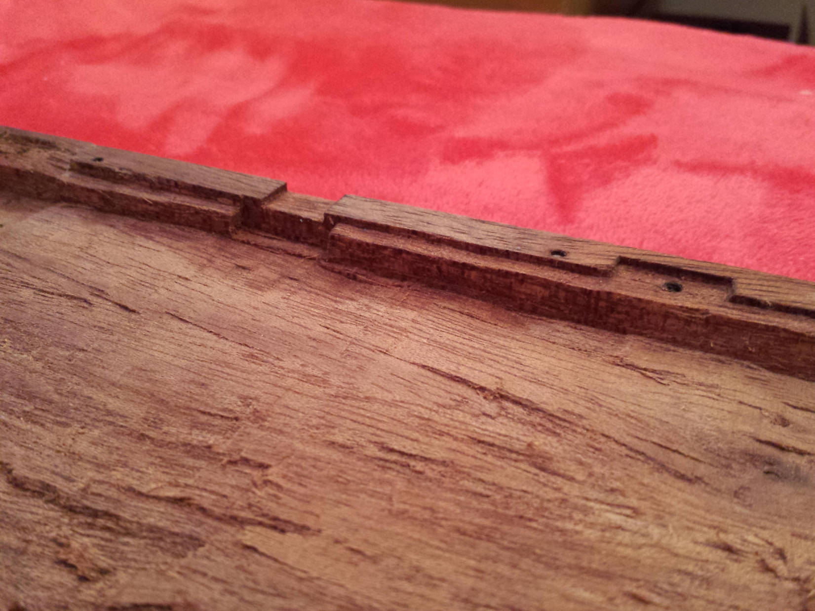

This is it. After one year of work (and few break) I'm finally typing this post on my new keyboard !
Working on the firmware, I discovered another small error: I placed all diodes the wrong way around. I had to flip the matrix in TMK code. No big deal but not the easiest to read.
The wooden case gave me some trouble. As I didn't find any CNC router nearby, I went the old school way with two pieces of wood handcrafted with only a chisel and a hammer. It took me ages and it's not as neat as what The_Beast did but I'm quite happy with the result :
I used the traditional mix of linseed oil and turpentine for the finish coat, it give a nice color and smell like old wood :
Here is the final result :

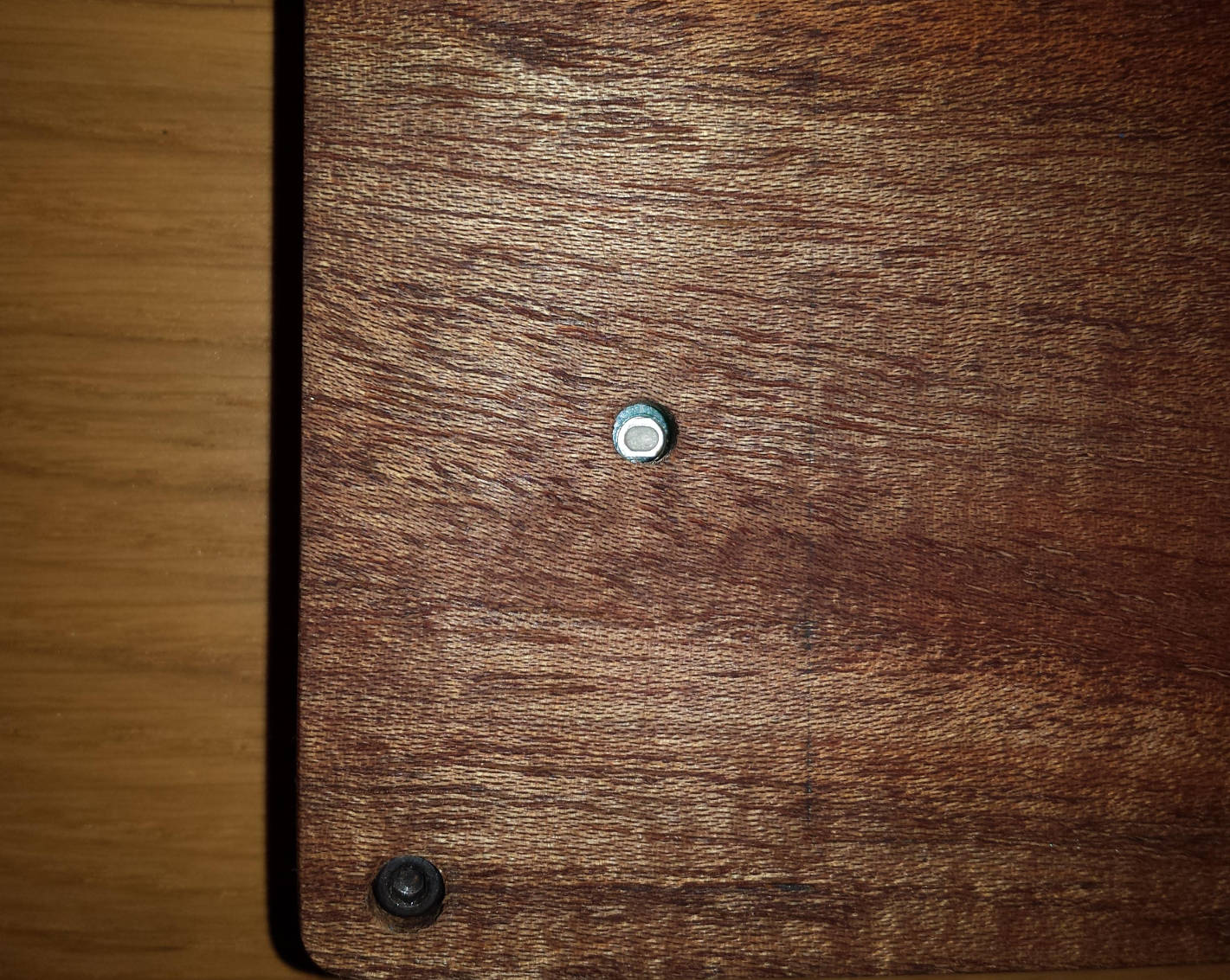

I also added a hole on the back to access to the Teensy button, useful for testing !
