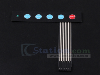

Get this without description from the website, but have no idea about the usage now. Could you plz give some advices for me?
Thanks a lot, and below are some pictures about the keyboard:

One of the wires should be a common line, the others will each connect to the common one when the related button is pressed. Use a multimeter / continuity meter to work out which line is the common and which are the others.

, except you'll need to use an extra pin
