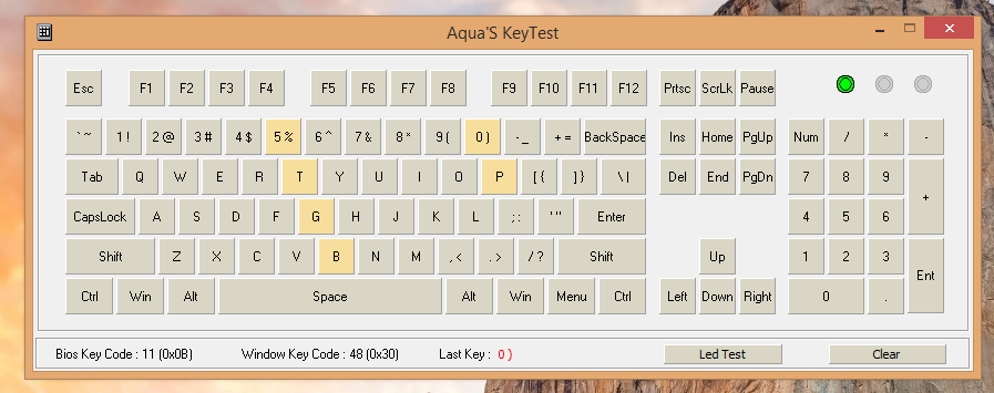

Here is what aqua says I press at the same time when I press p:
https://i.gyazo.com/e753cb1181ee3f455e0a4c2afd1ab95d.png
