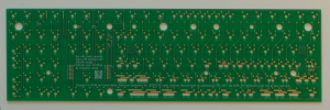

121337-0
121339-1

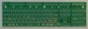

A main board intended to fit into numerous full size (and TKL) Costar cases (*none tested so far). As opposed to the Costar Matrix, the Sane Matrix has an intuitive 6 rows by 22 columns matrix. That of course requires a custom controller as well, The Voice of Reason.

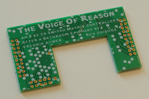

121341-2

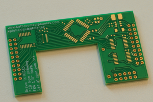

121343-3
I built the controller around an ATmega32u2 and three 3-8 decoders. That adds up to 24 (low driving) outputs, and 8 inputs (ATmega internal pull-ups), and 3 LED outputs with PWM. I also routed the UART and ISP interfaces out to a separate header. Then there is an extra PWM output for a forth LED (or just general GPIO). I also added series resistors to the 8 inputs for extra protection, added a fuse for the supply power, and extra protection diodes for the data pins.
All in all, it's sort of like a Frosty Flake on steroids. It should even be possible to use in a Quick Fire Rapid board. (Some of the output pins need to be removed in that case. They are shorted out to ground [for no apparent reason] on the QFR mainboard.) In addition a regular Frosty Flake should be able to control everything but the numpad section of The Sane Matrix.
Nothing has been tested this far, I just wanted to share my Christmas fun. Yeah right, I wish. Apparently I have "more important" things to do...

Following this with lots of interest :D.
Re: The Sane Matrix and The Voice of Reason
« Reply #2 on: Wed, 23 December 2015, 10:26:14 »
Awesome project, sir! I love it. :thumb:

Did some finishing up. Have a mystery key among the left modifiers. Plus two other keys I'm not sure what to do with =)
139178-0
Also did some tidying up of my other corner at work...
139180-1

That small gap in the middle of the board would trigger my OCD, 100% guaranteed.
Offline bpiphany
  • Posts: 1033
  • Location: Stockholm, Sweden
« Reply #28 on: Tue, 07 June 2016, 16:17:04 »
=) The PCB can take 1.25u keys (centered stems or offset) or why not 1.25u stepped keys.

Offline xtrafrood
  • formerly csmertx
  • Posts: 2713
  • Location: Gainesville, FL
  • Polycarb believer
    • csmertx.com
« Reply #30 on: Tue, 07 June 2016, 17:15:39 »
Good lord both PCBs are immaculate. One wouldn't need to take any second glances during those foggy moments to see what is what while soldering that's for sure!
Stepped 1.25 is a clever solution.  I doubt such a thing even exists.  :P
Offline bpiphany
  • Posts: 1033
« Reply #32 on: Wed, 08 June 2016, 09:44:57 »
Hm, I thought there were. Signature Plastics have some in their DSC family, but I see now that the step is only 0.125u wide, if I read their specs correctly..
