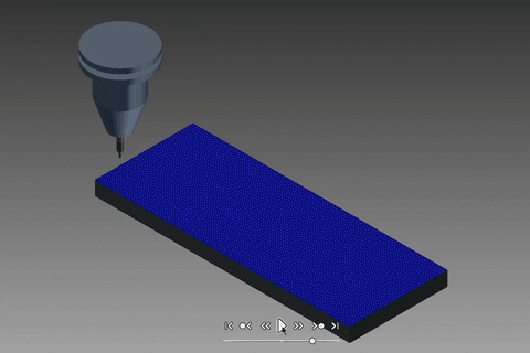

Update after a night of machining and a day of reflection (note: the following is not totally relevant to all of you, but just a reason for the delay):
Workholding is going to be the next big issue I need to tackle, that caused the prototype case to be thrown from the vise once and move during the operation twice.  As the internal pocket is machined, the side walls get thinner and thinner.  Since I'm holding the part by the long ends (next to the space bar), there is a lot of thin material that can act like a spring.  Since aluminum is pretty shifty, it starts to deform, and instead of the whole vise gripping the part, the part bends so that only the corners of the vise are gripping it.  This does not provide enough force to combat the cutting forces and torque from the cutter, and the part moves.  If it's not fixed, the cases won't actually be able to fit keys.  I'm working on this, and have some ideas on how to do it.
Moving forward, it probably means I'll have to make a jig to hold the part vertically.  This will counter the bending by pushing the force onto the areas that are still strong because of vertical thickness.  It should be simple-ish to make, but that might take another weekend or so.  I'm also looking to find a machine shop to do production at, they probably have the experience to recognize this issue earlier  :(
Also damaged my roughing endmill because I was running it too fast in the morning.  It was cutting the aluminum so fast that the bit was pulled into the material as it cut around.  This became a problem because the bottom of the machine path was about 0.1 inches above the vise jaws.  However, the bit got pulled down more than that and hit the jaws.  Surprising, it got pushed back up by the hardened steel and continued cutting.  Until it reached a pocket, where it had to enter the material vertically.  Turns out the bottom of the cutter got scalloped by the steel and the bit can't really plunge/helix into stock very well.  I was able to get it in by slowing down the feedrate and stopping midway through as the spindle started to sound like it was about to explode, but a pain overall.  As a result, I had to slow down the entire feedrate.  From talking to the consultants at the shop, the feed would have worked on a machine more rigid than the one I used (no other CNCs were available at that location).  So I'm looking for another machine to do it at the earlier feedrate.  (Faster feed means less time = less cost)
So going forward is going to be about making a few minor modifications to the creation process of the case, the design looks fine.  All the keys on my 60% actuate fine when in the case.  No bits of metal are stuck touching the caps, preventing their motion.  The drill holes to attach to the bottom case look fine, and the sides are nice and thin.
I'll try to keep you all updated on the process of machining out both the top case and the slanted bottom.  I've got ideas for workholding, they just need to be finalized!  I'm also interested to hear what color options you all are thinking.

Did some thinking about setups: My current thought is to do it in 3.
Drill alignment holes and mill back pocket
Flip, attach using holes drilled in 1 (which have been tapped by hand); mill top pocket and contour upper edges
Flip, attach using blockers; contour lower edge (that has holes)
To use just one fixture plate, I'm planning to use screws to mount in and act as poles for the case to rest on.  The tapped holes on the case will provide the clamping force downward, but the screws on the side will stop sideways movement, which would ruin the part.  The screws let me do two set ups on the same plate.
If this works, the same fixture plate should work for production too.  My fingers are crossed that this works!  It's be a learning experience for me (I'm planning to study this, but we don't have any work fixturing/machining classes at my school).  Thanks for keeping tuned in.

Finally got the tooling I needed in.  So after the last round of prototyping, I damaged my main roughing (material removing)end mill.  So I just got a new one in the mail, and it should speed up the process quite a bit.  3 flute solid carbide will just tear through all this aluminum.  Got to do a small test with it on another project (manual mill, so the curves of the case were out of the question  :( ), and the thing absolutely tore through the material.
I also found a corner rounder, which will give the case the smooth rounded edge on the top.  Got to do a straight line test with it too, and I'm pretty happy with the results.
Overall, it has a great edge finish, and I can slow it down just a bit for the finish pass.  The radius (3/32) is just about one of the smallest available, and it seems to match with most of my other keyboards pretty well.
The process has taken longer than I would have liked, but the final machining details are coming together.  Once I get one made, we should be able to move forward to a GB.

Ok, an update at long last.  Finally got out of school, and my time is freeing up.
This massive gif shows some of the work I've been doing to get the case ready to make.   At this point, I've got most of the computer side work done, and it should be machinable.  That said, I'm going through it to check settings and make sure nothing breaks.
I've also addressed that chatter problem with that one endmill, I have another coming that should help out a lot with that.
As we move forward, my goal is to try and get this to GB stage by mid June, so I can get orders and hopefully send them out by August.
