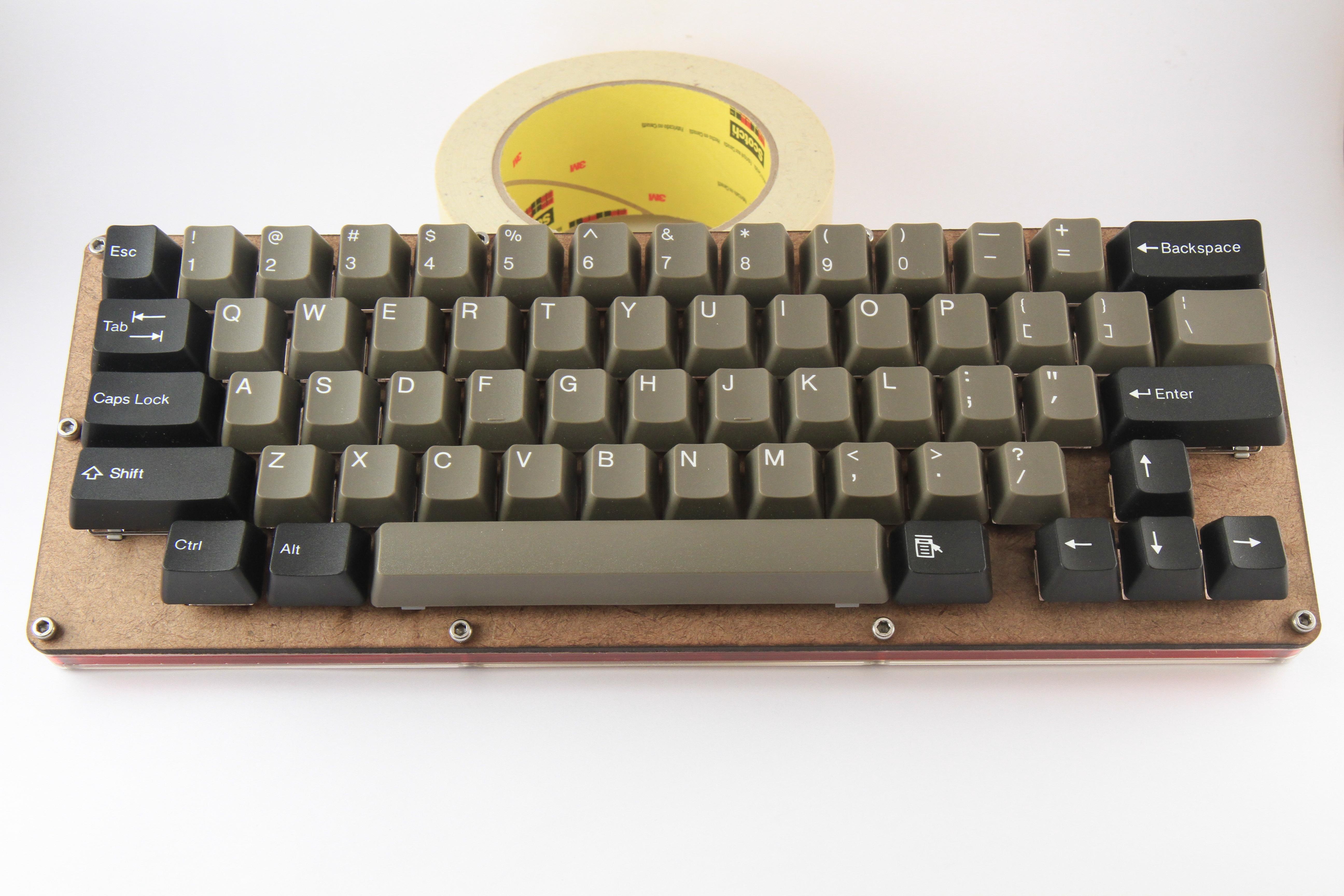

Below first build is resulting from the following:
  • Owing to my unorthodox typing style I find that I am never using the right side modifiers.
  • I was fond of the 60% layout and wanted to give it a try.
  • I love me my dedicated arrow keys.
128468-0

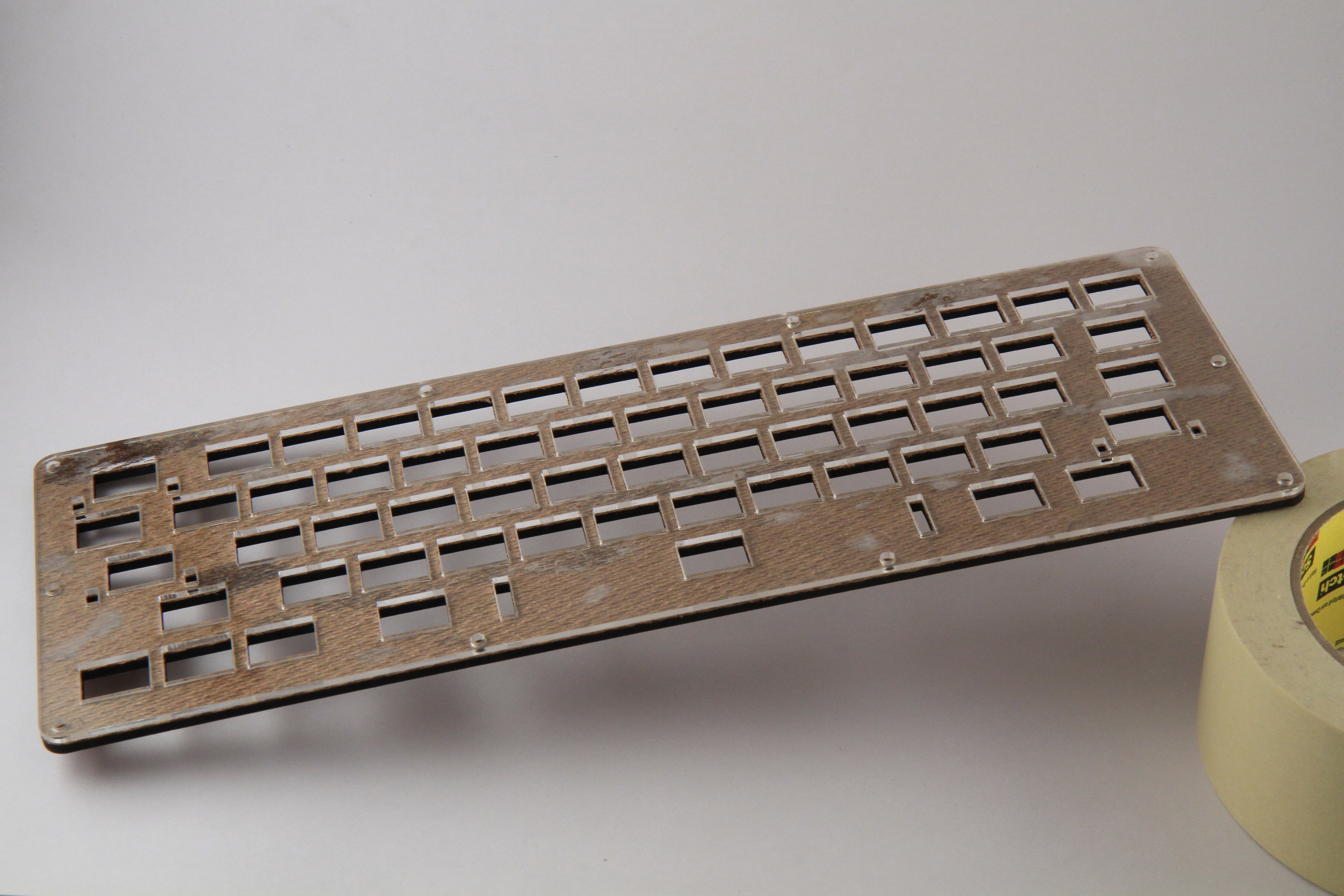

Understood this layout is not for everyone, but it is great for me.  Thought it also would be a good opportunity to try clicky Matias switches.

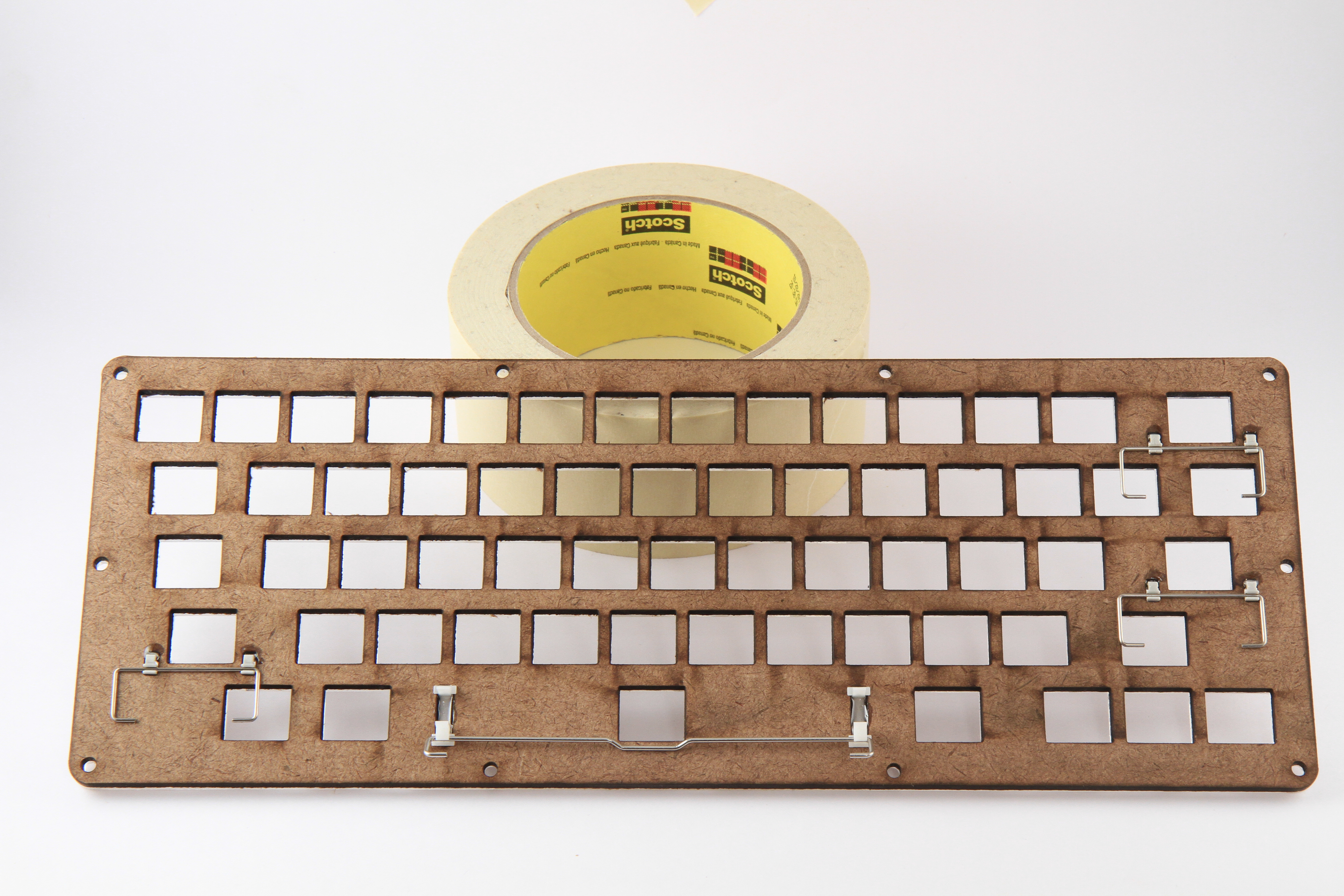

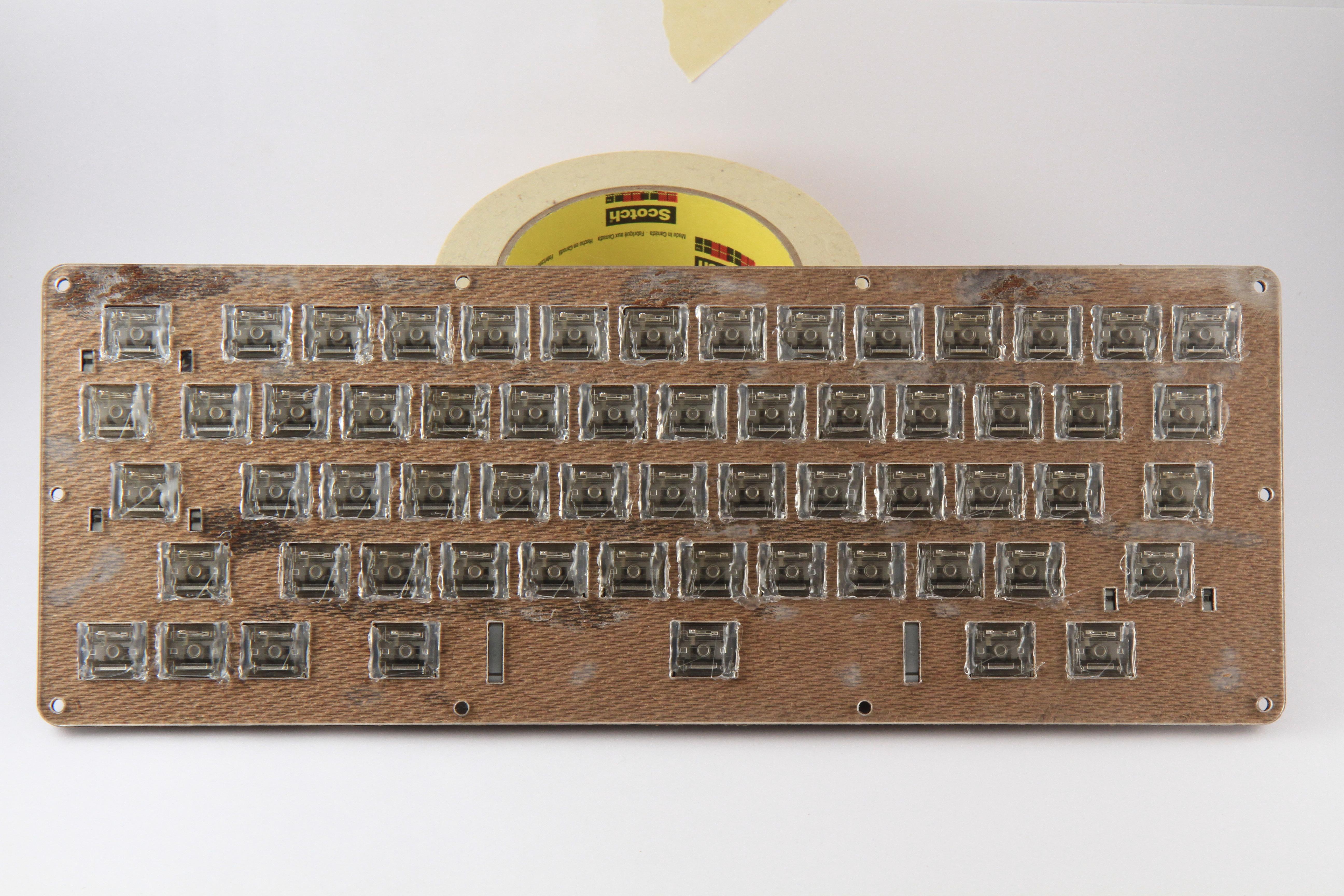

After a bunch of failed attempts for a plate I settled on 1/8" tempered hardboard with a 1/16" clear acrylic strengthening layer.  It wound up providing a good compromise between strength and flexibility.
128470-1
The plate was too thick for the stabilizers or switches to click into place, so I had to glue them in.  Epoxy for the stabs and hot glue for the switches.

@shareandenjoy Nice build! How do you like the key caps...are they the doubleshot Dolch?
Offline shareandenjoy
  • Posts: 9
Re: 60% Matias with dedicated arrows
« Reply #7 on: Mon, 22 February 2016, 22:26:58 »
Yes, Tai-hao doubleshot ABS dolch.  So far so good, but they were super tight fitting.  Dont know if that is normal or not, but there is no way I am ever going to pull them off, they would take the switch with them for sure.  Ironically I am getting a wee bit of wobble from them, but I guess that is more a natural result of the stem then the cap.
