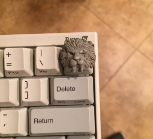

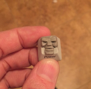

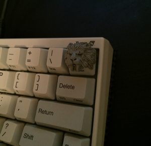

Hey everyone! I've been a long time lurker on this site, and a few months ago I got pretty excited about making some of my own keycaps. I figured I would document my progress so that others can benefit from my mistakes. I've scoured this site and made a big compilation of notes from all the other images and tips that I've seen on this site, so a big thanks goes to you guys for the help and support.
A few weeks back, I started experimenting with some OOMOO silicone and clear resin. My first attempts weren't too bad, and I was able to replicate some stock topre keycaps with a little internal bubbling and an intact stem. After understanding the basic molding and casting process, I decided to get some sculpting materials so that I could start trying to make some designs of my own before attempting to cast anything.
First off...sculpting on keycaps is incredibly difficult. I've been sculpting for a while, but it's an entirely different game when you're trying to make sculpts on such a small scale. I set some rules for myself, like not building more than a few centimeters in height, and keeping a relatively smooth or flat top so that pressing the keycap is still satisfying.
The first attempts at sculpting on a keycap went like this:
130664-0

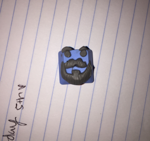

"Beardly" was a hideous monster, and I had to destroy him in the end. I was using some regular Sculpey, which is quite soft and not great for fine detail. All of my designs were too soft and lumpy, and I felt like I hardly had any control. I then decided to go out and get some Super Sculpey Firm, which I like quite a bit better. The results are good, but I still feel that the clay is soft for this fine of detail. It's difficult to smooth out tool marks when things are so small. However, it's much better than regular Sculpey for this kind of stuff.
My next idea was a "Legends of the Hidden Temple" kind of feel, but it wasn't progressing how I wanted, and I became frustrated and scrapped it.
130666-1

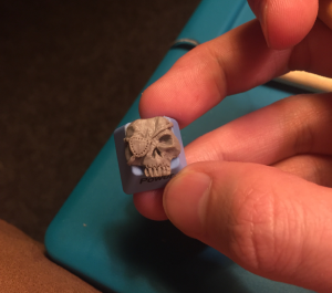

I decided to sculpt my own take on the good ol' fashioned skull as a test, which came out like this:
130668-2
However, the tool marks were pretty rough and I decided that it just didn't look quite right. I scrapped the eye patch idea, and decided to just get some practice smoothing things out and playing with the clay a little. The result was acceptable, but not what I was originally going for. I started to realize how difficult it is getting your ideas to translate to such a small surface. I decided to call him "Mulder" for a laugh (X-Files). I baked him (low temperature did not melt the keycap), and put him on my work keyboard for a day so I could feel it and decide how to proceed.
130670-3

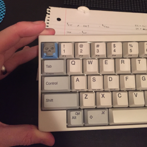

I took a couple of days off, and decided to try to come up with something a little different. I decided that I wanted to keep my relatively low-profile rule, but I wanted to also expand around the sides of the keycap a little. I tried messing around with texture, and ended up deciding to sculpt a small sabertooth/lion head. I really liked the way it turned out, but there are definitely some imperfections and issues with proportions. He was dubbed "Saber" (super original, I know) and put to the side for a few days. I like to push myself hard in one or two sessions, and then put it aside and come back with fresh eyes to spot any imperfections that I might have missed before. I do the same with my cartooning.
130672-4
130674-5
I decided yesterday that I want to try my hand with some epoxy, so I ordered some kneadatite and dental tools. Hopefully I can get some finer detail and more control while using that. I'll update you guys once I start using it. I also decided to expand and order a vacuum chamber, pump, and a bunch of silicone and resin. I'm going to experiment with more complicated casts in the next week. Also, I'm starting to realize that I'm almost out of keycaps. Do you other Makers just order a keycap set and sculpt on extra keys? or do you cast new keycaps and then sculpt on those?
« Last Edit: Wed, 17 May 2017, 10:26:39 by Sneaky Potato »

MASSIVE UPDATE!
It's been a long and exhausting weekend, but I can finally say that I've got some great results to share with you guys. I'll give you a sneak peek real quick of Saber 1.0:
131051-0
Pretty sweet, right? I'll give you guys a quick rundown of the process and some of the issues I ran into. I'll post a more thorough guide once I get the process down to a science.
I spent last week planning and taking notes on the process, and the new equipment. I have a journal and I've been keeping notes of each of my casting sessions, which has helped me greatly with my error margin. This was my incomplete first page, but I will release some more of my notes to you guys for reference pretty soon.
131053-1
I ran into some initial issues with the equipment that I was working with. First, my air compressor was complete crap and leaked like crazy. I couldn't get my pressure pot even close to 45 psi. I ended up returning it the next day and buying a much nicer one at Home Depot. It ran much, much quieter and didn't leak at all. Next, I found that the psi gauge on my pot did not function at all, so I sped to Home Depot to buy a new pressure gauge (got there about five minutes before they closed). After installing the gauge, it worked without an issue. Armed with my new air compressor, I then found that my pressure pot would not hold a steady pressure for more than an hour, which sent me back to Home Depot for some higher-quality thread tape and some pipe dope. The combination of the two stopped all leaks, and my pot was able to hold a consistent pressure.
My vacuum chamber was able to pull the right amount of vacuum to degass my silicone and resin. I'm really happy with the setup.
Here was my first workspace, which was basically an old coffee table with plastic over the top. I was still putting together the pressure gauge and other parts, so the pressure pot is a bit bare.
131055-2
After killing my back because the coffee table was so low to the ground, I upgraded my workspace a bit:
131057-3
Having a large workspace really helps when you're trying to mix up silicone, or multiple colors of resin. Now, lets move onto the actual casting process.
Per my original design, I decided to try to make a mold box that would produce a clean silicone mold. I figured I wasn't skimping on other things, so I might as well try to make my mold the best I possibly could with the limited tools that I had. First, I bought some hard foam board, a sheet of soft foam, and a hot glue gun. Due to the fact that the topre stem is longer than the keycap itself, I had to make a base that would let the keycap sit flat on the surface. I tinkered with a few ideas, and made my first mold. I scrapped it before testing it, as I didn't like the idea of tearing my mold apart each time and then trying to build it back up.
131059-4
I opted for a large piece of PVC pipe, which I cut and then used it for the walls of the mold box. It releases the mold easily, and can be used over and over again. The mold had almost no leakage, but I secured it to the base with some Super Sculpey. Then, I stacked the second half of the mold on top, added some stems for vents, and poured the second half of the mold.
131061-5
131063-6
I didn't take any pictures of the resin process, but I'll update you guys on that soon. Here are some finished keycaps, and some attempts at colors.
131065-7
131067-8
131069-9
131071-10
I had a great time making these, and I'm extremely satisfied with my casts. Saber 1.0 and Mulder 1.0 have been a great success. No bubbling, and the stems came out perfect (which I was really worried about). I'm going to be coming up with some additional ideas for sculpting, and then I'll update you guys in a day or two on my progress. Thanks for taking a look!
