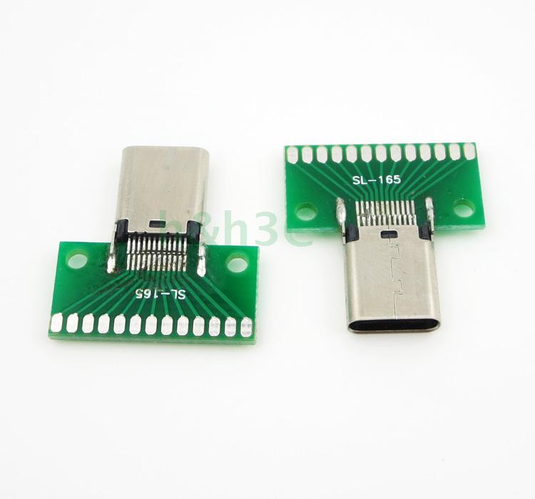

I ordered a few female + male type c breakout boards
which will be connected to a teensy 3.1.
The reason I got the teensy 3.1 instead of the typical atmega32u4 boards is that I've picked up the teensy for a reasonably low price, and that I'm going to continue with an arduino ide based firmware that I've never got around finishing, plus the extra horsepower of the arm chip won't hurt.
I'm planning on adding a usb hub as well, but we will see. On the side note everything will be hand wired for now, not planning to make any pcb to save cost.
