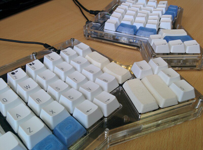

Hi, I've just completed the main build of my first mechanical keyboard, and ergdox from kit parts.
As I was "sensible" and chose Matias switches, I then found myself unable to easily get DSA keycaps in the UK for this switch stem, and that of course sent me off down the path of:
 * yes I will have to cut my own case with different holes,
 * of course I could just 3D print some keycaps,
 * well yes a fully parametric CAD model because then I get 1S, 1SD, 1.5S and 2S,
 * well the prints of the Ultimaker work, but you can see & feel the layers on them,
 * if I could just find the right process/legend/finish combination, I could make an entire set with no minimum order in any combination of keytypes,
 * maybe SLA printing would work, lets try shapeways…
I'm kind of expecting that this path is never ending though!
https://twitter.com/DefProc/status/753587171450351616
I've had a bit of a lurk around and seen some 3D printed specials, but has anyone printed a full keycap set that is as practical as a moulded set?

Have you thought of making your own resin keycaps the old fashioned way? You already have 3D printed keycaps in the shapes & sizes that you need why not make some molds from them? Is that your picture?
Yes, my picture.
I've got the idea of casting in the back of my mind, but I've not done any yet (although, I'm assuming keycaps, being small and relatively simple shape, would make a reasonable first try). I'll need to do some surface finishing to make them suitable for casting, so I'm interested to see how the alternative printing methods look.
