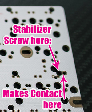

Hiya, peeps.  I'm sure it's been documented somewhere else, but I just wanted to tell about my experience with R4 stabilizers.  First off... they rock!  The quality makes authentic cherry feel super cheap.  Thick, rigid plastic, won't pull out when you have tight caps, and no need to clip mod.  What's not to like?
I did have an issue with my particular board, a GH60 Satan RevCHN (the cheap clone GH60s on ebay).  These boards are built for flexible layout and have a lot of extra holes to account for that.  The screw for the right stabilizer post on the enter key makes contact with one of the switch pads on the back, causing they keyboard to register Backspace, / , Enter, Shift, and right Control.  It's an easy fix with some tape to stop the contact, but just thought I would leave a note here for anyone experiencing issues.
Not my original photo, but I've circled everywhere you screw in the stabilizers on the Satan board (Green makes contact with leds which shouldn't cause issues, but red shows where trouble could occur)
159249-0
And here is a closeup of where I had issues on the Enter key stabilizer:
I guess that is an ISO hole?  Anyway, when the screw made contact here, it caused the board to register a lot of key presses and basically not work.  Simple fix was to put some tape over that hole before I screwed in the stabilizer.  Worked!
Great work on these, zeal.  I plan to order 2 more sets!
Unfortunately due to the way some PCBs are designed, there's a possibility of the screw grounding a whole column making the board cause the issues you've described. The solution would be to use a small piece of paper/tape. Zeal60 was designed around the stabilizers to work without issues.
But the upside is that the stabilizers will literally never pop out of your PCB...

I saw a post about this on MassDrop as well, but I've been experiencing issues with the screw-in stabilizer wire popping loose when removing keycaps (both lubed and unlubed stabilizers). Would be nice to get the fit a little tighter, if possible, to avoid that issue. It can be really hard to reinstall the wire if it slides away.
Offline Zeal
Currently investigating the issue with Gateron. I personally haven't encountered it with my builds, but it may be due to the slightly tighter inserts with certain keycaps. Right now the best solution would be to pinch the horizontal stem a tiny bit once or twice. It should make keycap removal easier without accidentally pulling the wire out.
If it helps with your investigation, it happened to me on Cherry MX Silent stems and Aristotle stems, both in Zealios housings, with DSA and Cherry profile (GMK) keycaps.
I thought it was just a random fluke, but it happened to me too.  Using R4 stabilizers, I was actually disassembling a board that I messed up and the wire came loose from the enter key while removing the keycap.  I thought maybe I had just not seated it properly.  It wasn't a big deal b/c I was already in the process of taking it apart.
