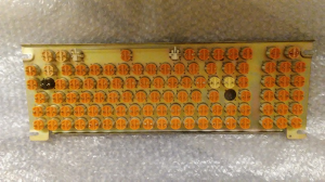

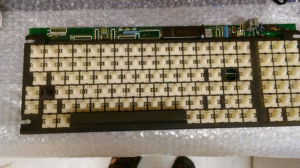

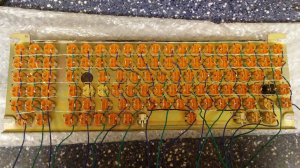

First desoldered the PCB, then wired the rows and columns:
171482-2   171484-3
171486-4   171488-5
Next decided which pins to use and then using mepler's code as a template, made the code modifications and additions for my keyboard matrix. A bit tedious coding for each key
but I really just wanted the experience of doing it. One code modification I made was to use an Active Low configuration using the Teensy internal pull-up resistors,
rather than the Active High with external pull-down resistors configuration  mepler used in his TI-99 code.

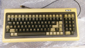

Next the very messy looking initial breadboard, uploaded my hex file to the Teensy, did a little debugging, and it worked! Once I was sure everything was working I soldered
directly to the Teensy and tucked everything back in the case. I'm sure my code is not the most elegant solution but I do feel like I learned quite a
bit by doing it (again much thanks and credit to mepler for his TI-99 matrix template and tutorial).
