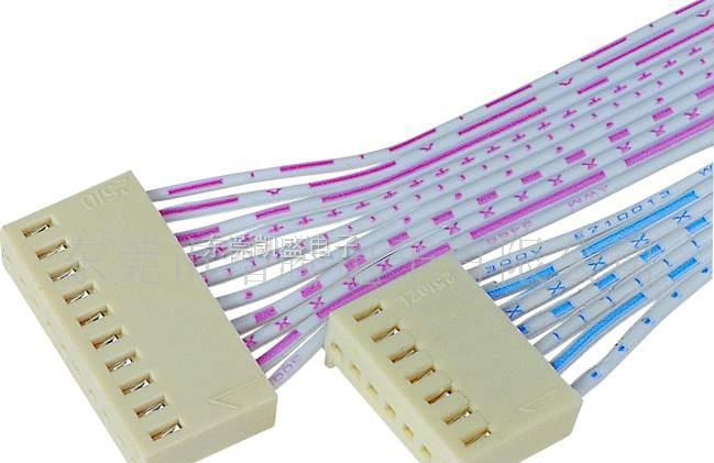

Hi,
Every body.
Cases have finished, but got a layout issue on the separable module.
This makes the keyboard has no response after finished.
We've spotted the bug today and figure out what cause it.
The engineer made a mistake, usb pins are reversed.
Means, it should be 12345, but become 54321.
Trying to find cable that is reversed instead of make all PCBs again.
 :eek:

You might be able to do it manually if you just pop out the pins and swap them around:

Might take a few hours. But might be better than re-manufacturing the PCBs and delaying it longer. I doubt any reversed cables exist...

If we can not find it, we might have to do that T_T
We use the cable similiar to the pic below:
http://www.ksdxl.com/product/20159/2015091178212161.jpg
I tried to pop the pin out, but it's really tight.

See if these guys can make it work for you: https://world.taobao.com/item/529129770382.htm?spm=a312a.7700714.0.0.675ba573GcOUi5#detail
I don't know which breakout USB board you used, but these can be customized by the end user: https://world.taobao.com/item/555092264486.htm?spm=a312a.7700714.0.0.675ba573ZflL0z#detail

We've modified the cables!
They works now.
Every PCB might has different definition.
For example, filco and varmilo is inverse.

Good to hear. Yes, not all keyboard manufacturers follow the standard USB cable order when designing their PCBs. When replacing the USB breakout board or USB cables, it is essential to check the cable orientation to prevent knackering your board or at worst starting a fire. This is important even when changing out a keyboard into a case that was ostensibly designed for your particular keyboard. I ordered an aluminum case for a Varmilo and the USB breakout board that came with it was not compatible as delivered with the Varmilo.
