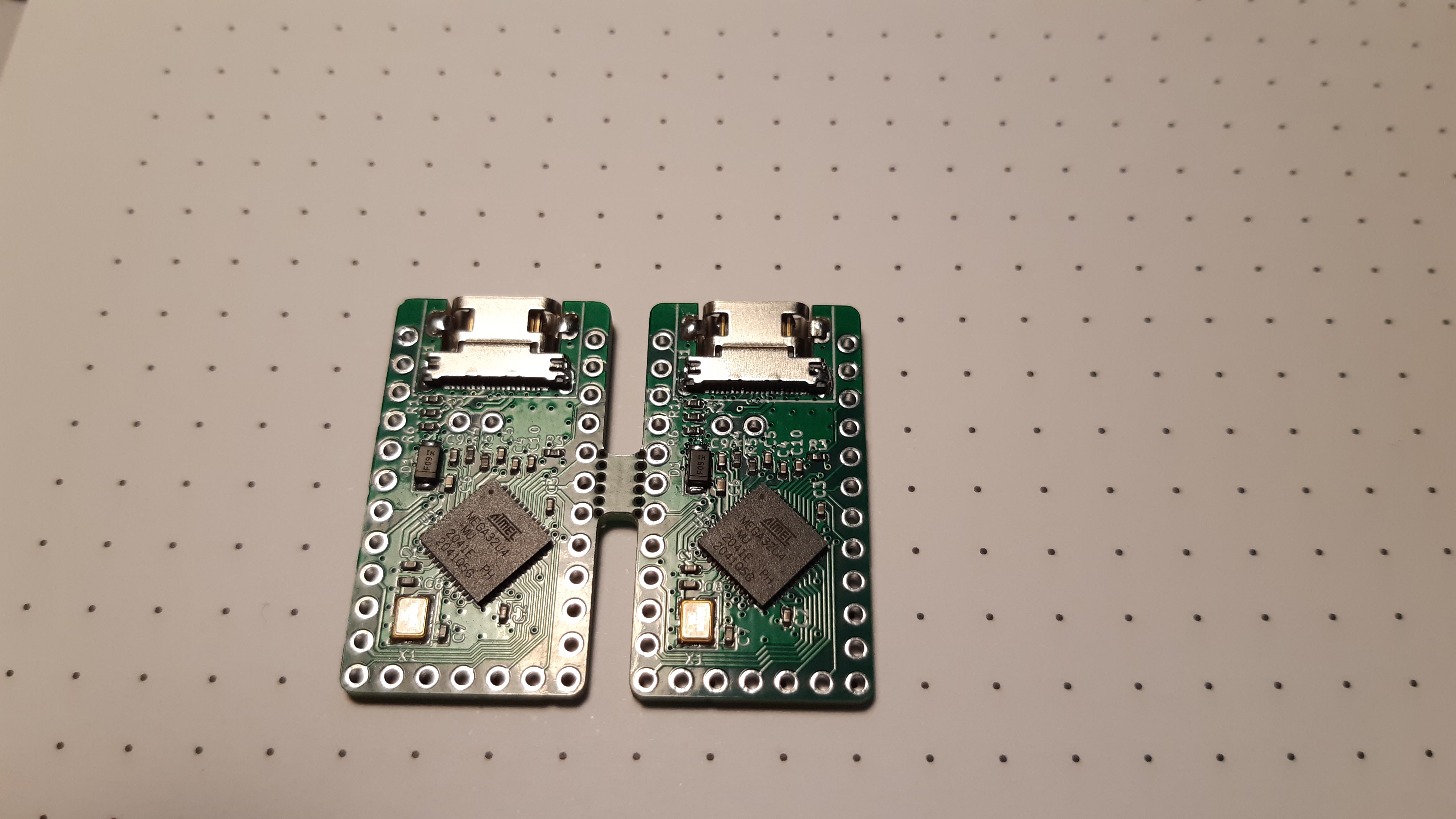

Offline tokas
Re: Goldfish - A super thin USB-C Pro Micro clone
« Reply #104 on: Tue, 23 February 2021, 12:46:11 »
Had some done via PCB A , still had to solder the USB Connector by hand though :(
Works very nicely
