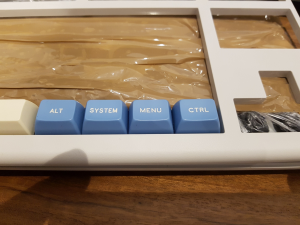

It's my work computer, so here's an un-glamourous shot of it in its natural habitat:
187717-0
Popped a sticker on the top right corner because I didn't like the printed "Type Heaven" font, and it's my buddy's music shop, so there ya go. At some point I'll post more.

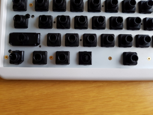

OK guys, I've been thinking about this and decide to mod one of my 87U55's.
So, basically looks like bottom row needs to be modded, right. However, I want to do a full bottom row, so it will change from
1.5u 1u 1.5u 6u 1.5u 1u 1u 1.5 to 1.25u 1.25u 1.25u 6.25u 1.25u 1.25u 1.25u 1.25u
That means all bottom row switches will have to move a bit, either left or right side.
190293-0
First 6 will go left a bit, then last two will be moved to the right.
I skipped stabilizers of space bar - just drew middle stems.
First, I need Novatouch keyboard for sliders... Anyone would sell me one? ;D
« Last Edit: Sat, 03 March 2018, 13:27:48 by phinix »

OK guys, so here it is.
As I mentioned before, I had to move a bit each of the bottom row housings (you can find drawing above in one of my posts).
I had to butcher one of my Novatouch keyboards to get its sliders and some housings, but this is the price if you don't want to use JTK or other third party sliders.

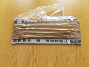

I started from preparing the patient:)

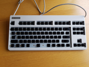

192186-0
192188-1
192190-2

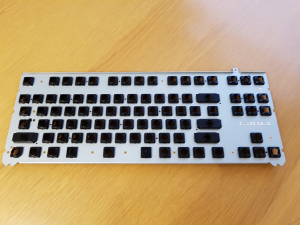

I wanted to cover rest of the plate. Being a modder, you do that all the time:)

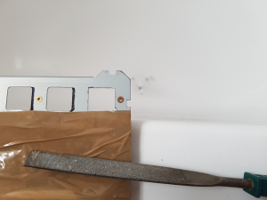

I used sharpie to highlight how deep I need to go - around 2mm on each housing hole.
192192-3

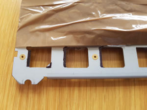

As we all know, bottom left CTRL needs some modding too - being 90 degree turned on Realforce, there is a full corner there - I have to file it off and use Novatouch housing for it as that original one in that corner is weird.
192194-4
..and some action - using small file I started to get make all those holes bigger...
Later on I took out my trusty dremel and used it to get rid of most of the unwanted metal... small file was to finish it off.
192196-5
It took about an hour or so to do all holes. I did all main ones plus those two spacebar stabilisers holes, as mx space bar has different positions on those, compared to topre (as you all know).

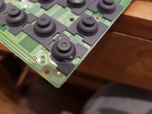

Those housings that were near case "mounting stems" had to be modded a bit too - I used round file to make their sides more opened.
192198-6

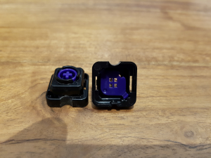

..and this why - you can see how nicely it goes next to the case mounting stem.
192200-7

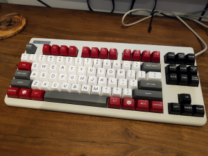

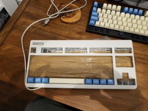

Keeping this thread as my modding one, just wanted to show my latest purchase and wee project.
Bought a RF R2, then modded with Novatouch sliders. Used KRytox 205g0 for stabs' wiring and Tribosys 3203 for modifiers' sliders and housings.
Then put on GMK Space Cadet.
« Last Edit: Sun, 22 December 2019, 08:01:44 by phinix »

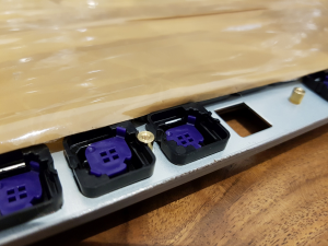

I've recently added another amazing mod to my R2 keyboard, so wanted to show here as well.
I used Silent-x rings in the past but they were always midiocre, very flimsy to put on, sliding off randomly, making some sliders stuck etc
Now, I used new stuff - Deskeys DES #3 rings - the best silencing rings for topre you can get!
So easy to put them on, no sliding stucking. And the feel... oooh man... Perfection!
Very higly recommend!
