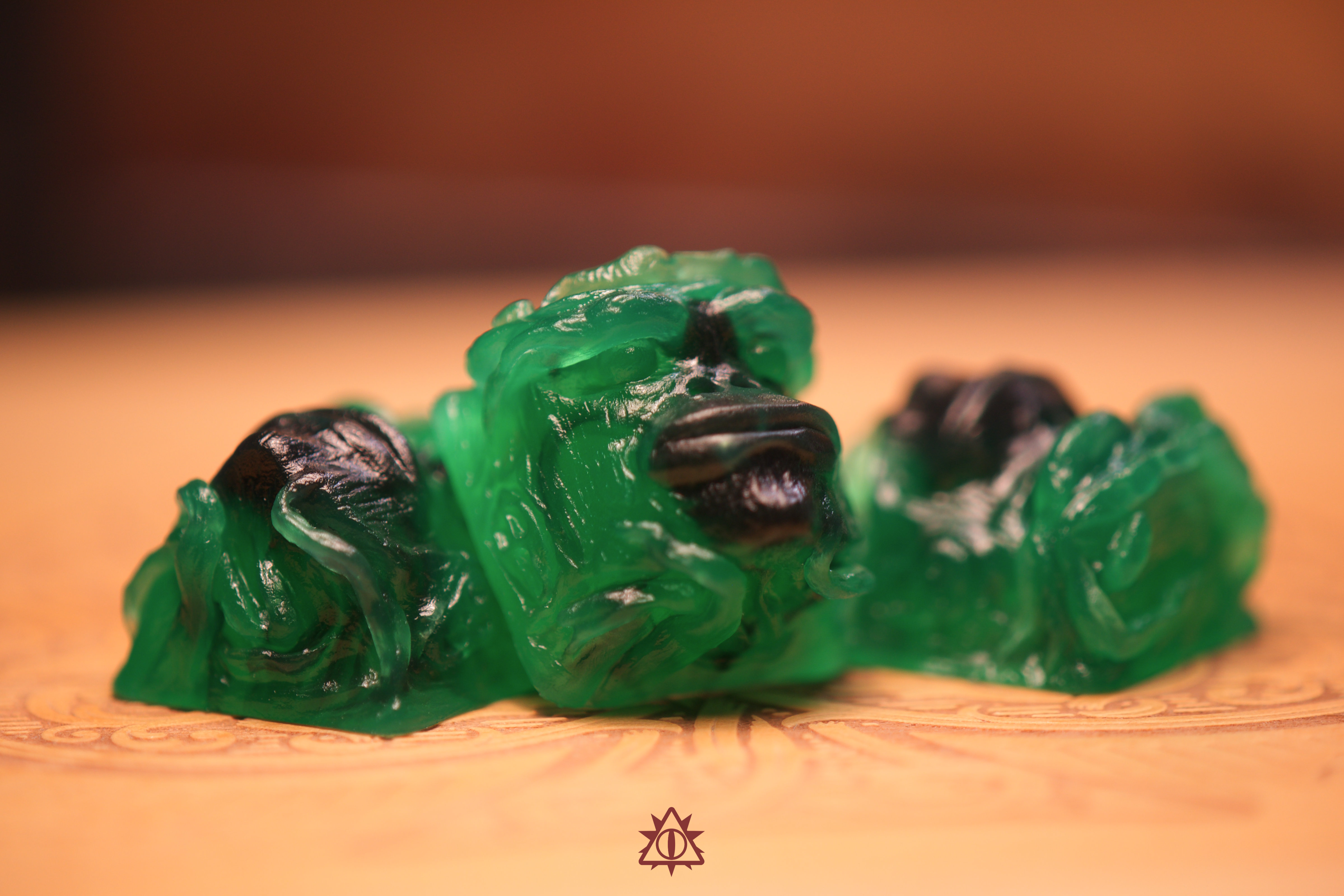

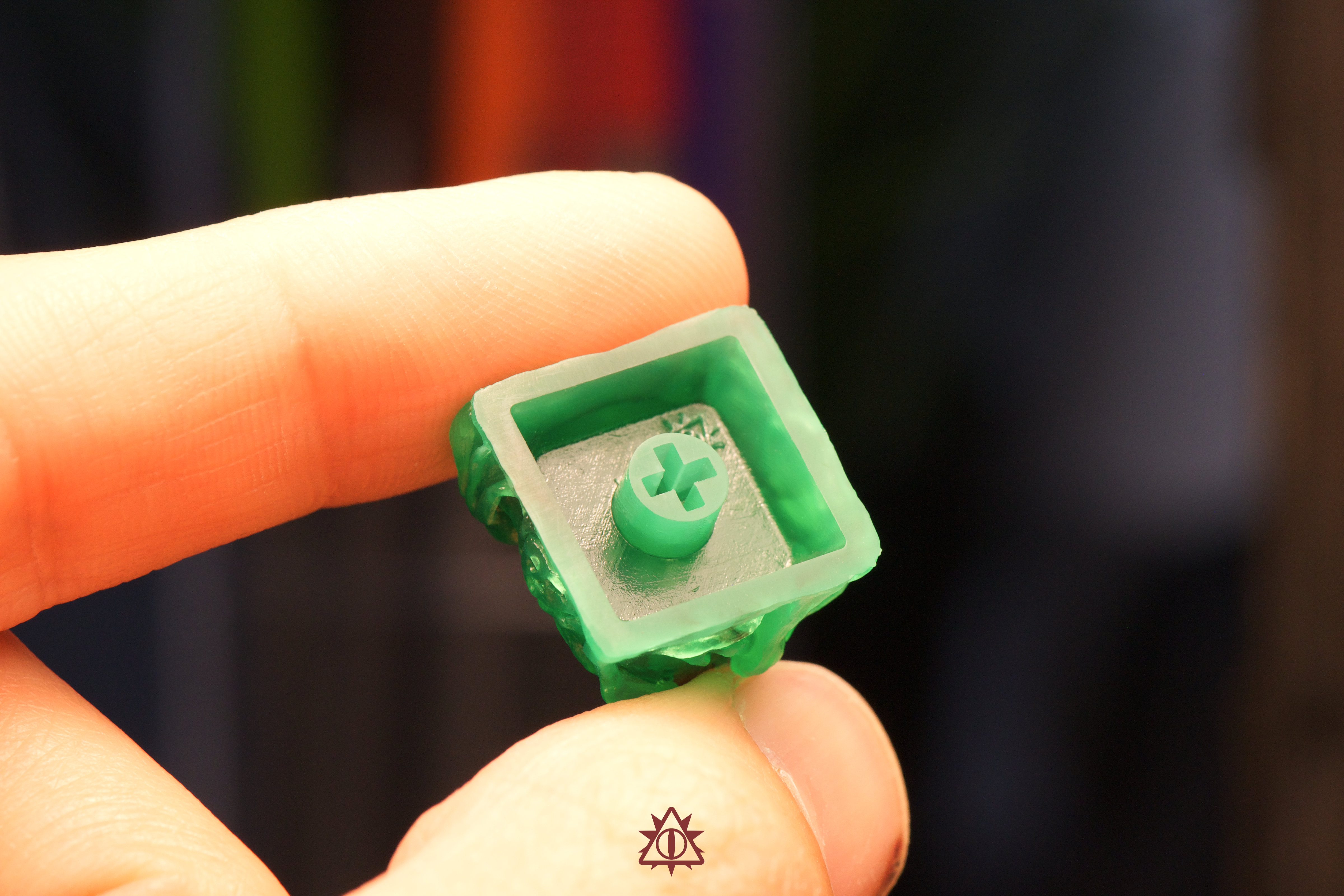

Hello guys,
Just a little update before going to bed, a quick potato pick of the 3 caps I cast so far since I finished my sculpt. More details to come on my progress very soon!
191537-0
191539-1
191541-2
Night'!
Science must begin with myths, and with the criticism of myths.
  • Posts: 4771
Re: I Sculpted My First Artisan Keycap
« Reply #18 on: Wed, 14 March 2018, 04:14:27 »
Looks like you have a pressure pot?
Your camera doesn't like pink and trans caps are never easy to photograph but that grey one shows off all the details nicely, so if all three look like that you're doing it right.  Unless you have a big pile of rejects just out of shot :))
Really impressive, keep it up!
Offline Edge.d
  • Posts: 32
  • Location: L.A
    • Dark Atelier
« Reply #19 on: Thu, 15 March 2018, 01:53:12 »
Looks like you have a pressure pot? Your camera doesn't like pink and trans caps are never easy to photograph but that grey one shows off all the details nicely, so if all three look like that you're doing it right.  Unless you have a big pile of rejects just out of shot :)) Really impressive, keep it up!
Yes indeed I have a pressure pot + vacuum chamber to get rid of all these little bubbles  :)) I actually shot the pictures with my smartphone very quickly so the quality is not good, sorry about that, I'll be posting better pics very soon  :) So far mold making has been good, 100% success with no bubble and all details of the caps were captured nicely. However I did a mistake when cutting the silicone extra from the mold, where the Synth gates are located (I will be posting more pics to illustrate my explanation, it will be better.) which led to a big load of bubble in the stem and under the caps + a stem not fully filled once cast (not thick enough).
So far I made only 3 caps, the one I posted pictures of, but because of the bubbles in the stems they will indeed end up in my pile of rejects.
I have poured new molds today and will cast tomorrow, hopefully I made the right modifications to the molds and will get rid of the bubbles under the cap, if not, then I will need to figure out where the issue is.
Thank you for your support, much appreciated! :thumb:

« Reply #24 on: Tue, 20 March 2018, 04:00:57 »
These look awesome!! I love the clear blue colorway. Super excited to see what other colorways you go with too.
Thank you so much! It is actually green but I shot the picture with my phone  :confused:
Looking forward to when you start experimenting with multishot caps :thumb:
It is coming soon!
Great job! On the multishot experimental side, I was wondering, do some people use syringes to inject the colors for specific intricate placement?
Thank you! Indeed some people use syringes, you can also use toothpicks or any objects small enough to reach inside intricate placements. Any tool you feel comfortable with is fine imo.
Little update, waiting to shoot some pictures to share with you, just haven't had the time yet:
- I faced the "bubble" issue many times this past week and for many reasons. First, I messed up my molds in a way that not enough resin was coming out of the "gates" so not enough bubbles were pushed out while curing in the pressure pot. Fixed the problem and still had bubbles.
- Second attempt to fix the issue was the temperature and humidity, since I cast outside my working conditions depend entirely on the weather, so I cast again at the perfect temperature, 73 degrees F with a low humidity and it was better but I still had a few bubble around the stem and bottom of the cap.
- Third attempt to fix the issue consisted in putting less release agent on the Synth, since I use Ease release 200, it is said to inhibit curing if too much is applied, so I reduced the amount and kept it to a thin mist of release agent then brushing all over the Synth to cover all surface in contact with the resin. Bubble issue fixed. So far my last 3 casts were bubble free and came out perfect.
I have the feeling that I reached a milestone and that from now on I have the "recipe" to cast bubble free caps, however we all know that even the most talented artisans out there all have a pile of rejects  :)) It will always happen, part of the hobby.

198307-1
198309-2
I also want to finally unveil the name for this first sculpt: Leshy
Leshy is a deity of the forests in Slavic mythology, strange creature, some said that he likes to lead travelers along incorrect paths until they become hopelessly lost, and others, that he keeps a more neutral positions toward humans.

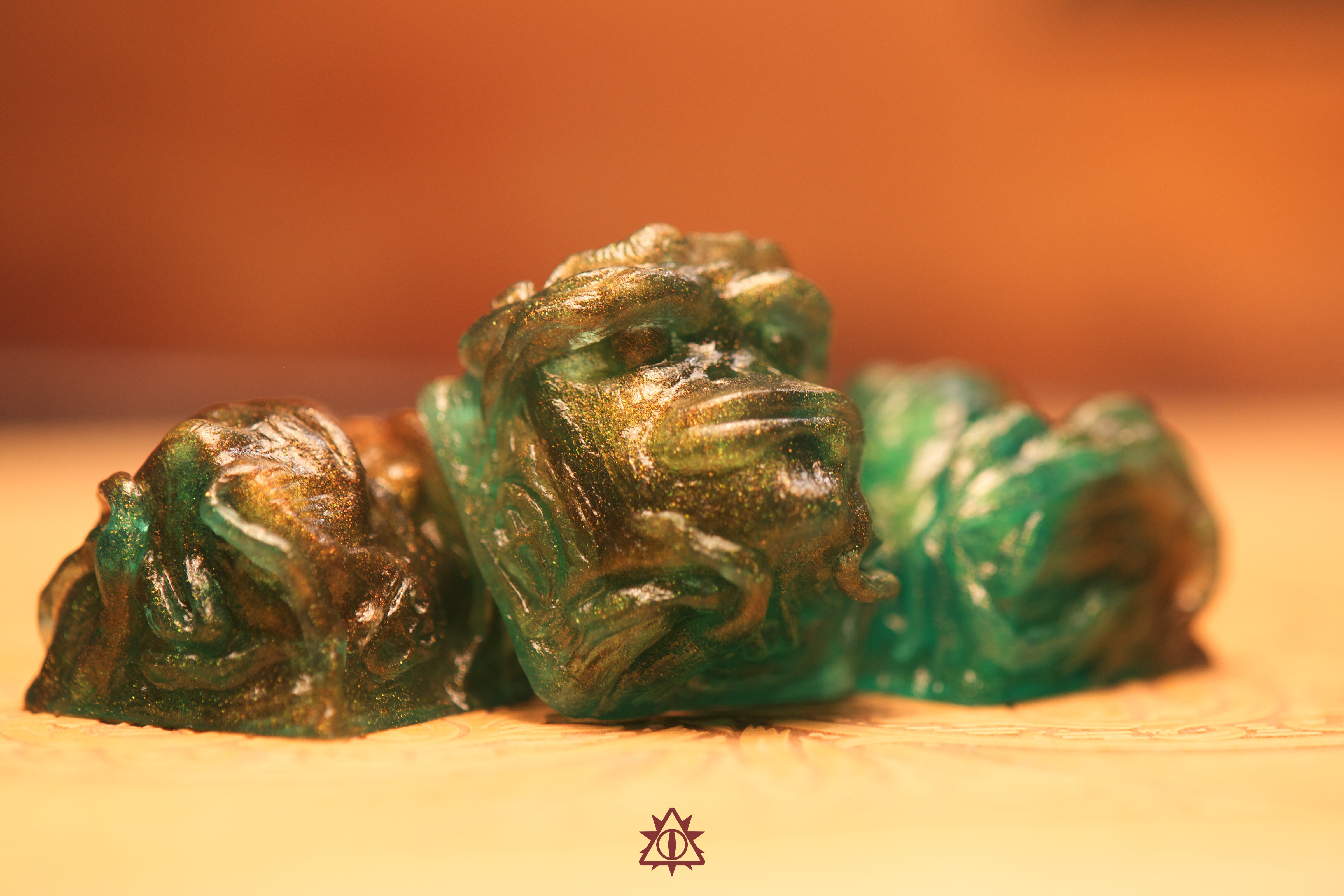

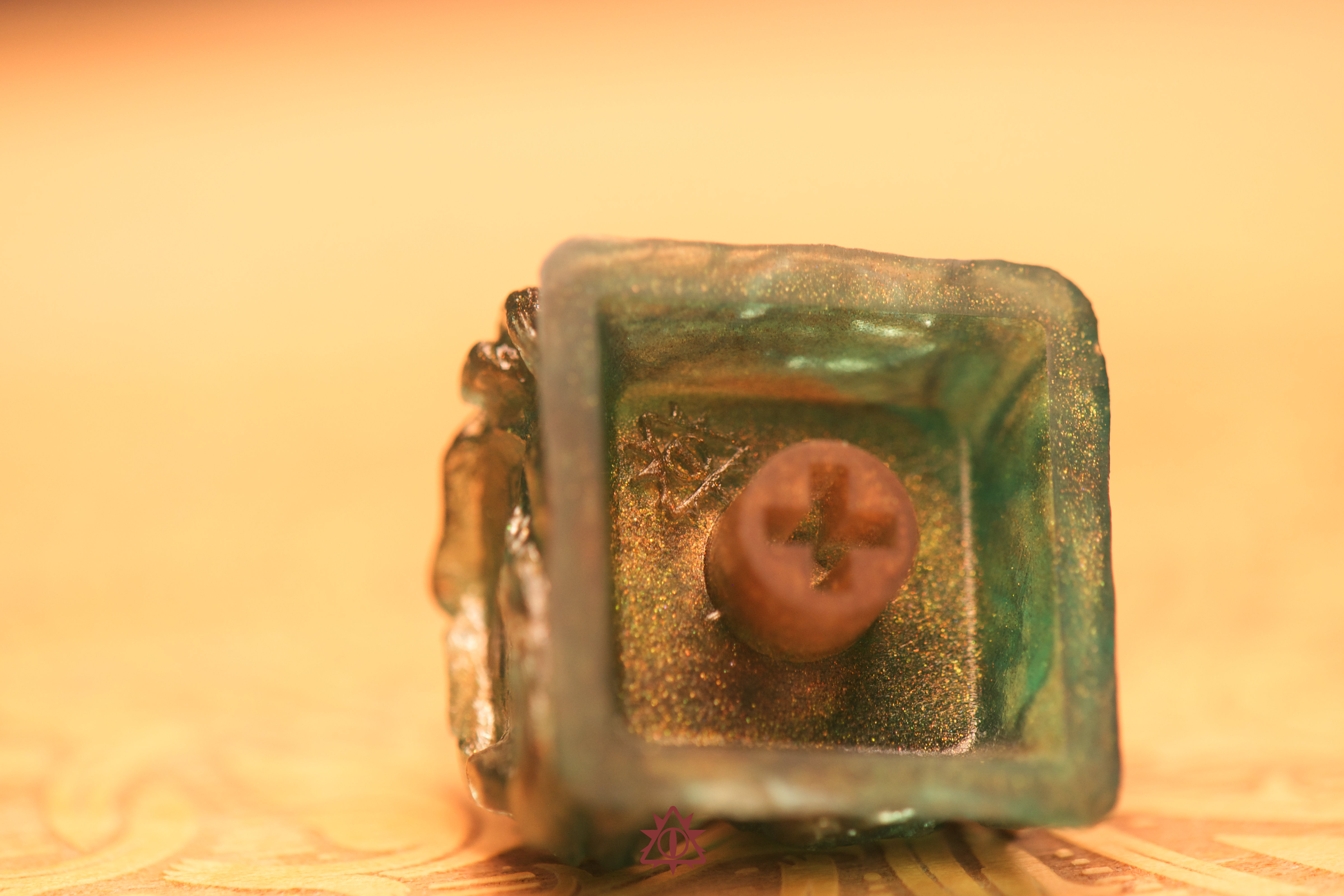

I would like to share 2 colorways I have been working on until the recipe was right:
This one is called "Forest Keeper":
198311-3
And this one "Toxic Waste":
198313-4
I'm pretty much done with other colorways as well, I will be posting them soon!
For those who like to lurk on IG, I have created a new account there, I will be posting pics of the new colorways and more: @dark_atelier
Thank you all for your support here, through DMs and other channels, it means a lot!  :thumb:
