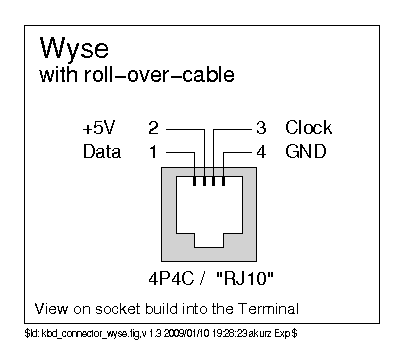

Hello, i have seen projects to adapt Wyse keyboards to be used modern computers. I was wondering if anyone knows about a project to convert a USB or PS2 keyboard into the the Wyse protocol? I have a WYSE 160 terminal with no keyboard, i found replacement online for 65$ but if i can make an Arduno adapt a newer keyboard i can build it out of parts i already have. i assume that if there is code already to convert  Wyse to newer formats then going the other direction cant be to much work.
I found a github project that does this for a wyse60 the question is are the protocols the same. /bryanc806/WyseBoard is the project.
so just to restate what im trying to do   MODERN USB/PS2 KEYBORD -----> arduino (if nessary)  ------->wyse160 terminal.
looking at the terminal it has a what looks like RJ11 jack, so 4 wires 1 Data, 2 +5V, 3 Clock, 4 GND.
if anyone knows if this already exist or is familiar with the wyse terminals any input would be help full .
